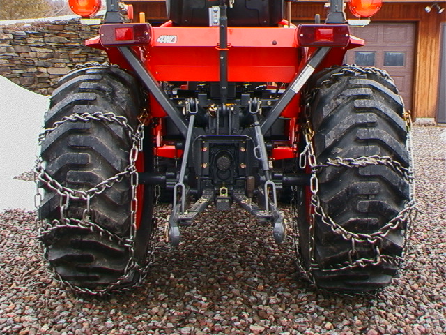

Everyone- I found a nice set of chains and a possable source for those of you that can only find the ladder style. From Peerless Chain Co. http://www.peerlesschain.com/ I got a set of "Duo-Trac" chains, which has a box pattern in the tread center. Paid $206 for the pair from a local heavy construction supply shop. They fit my tires and needed no alterations. However, if you have a B2710 or 2910 with R4 tires you will have a clearance issue. I found this out as soon as I put them on! They will rub the inside of your fenders. My dealer had forgotten about this issue (only a problem with R4's, not turfs or R1's according to him) and is getting me a set of spacers. Fortunately, I only scuffed the paint a little and I think a slightly wider stance in the rear is good, especially given the slopes I have.
Hope this info gives some of you alternatives to ladder style chains. I spoke to two chain suppliers and both confirmed what Boondox(?) said about the ladder style sort of getting lost in R1 and R4 tires.
I borrowed a digital camcorder again!
Dave
