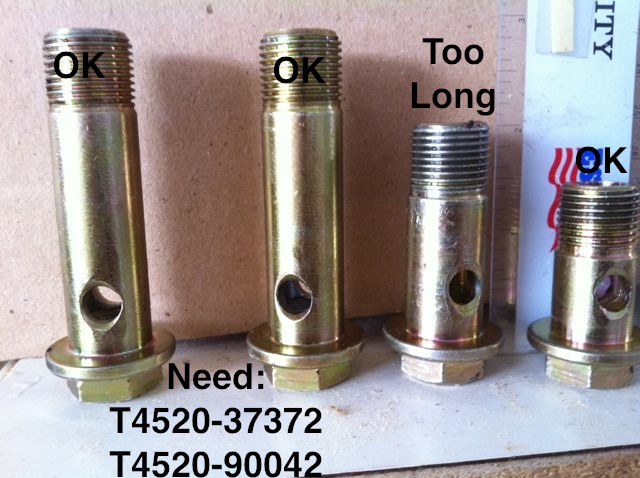

Unless somehow the parts in the box are messed up.
Mine is almost back together.

David, Don't feel bad. That's how my dual remote kits were packed too. You need two long and two short, pipe nuts I'll call them, to attach the hyd steel pipes to the valves and they gave you a medium length one just like I had in my kits. It must have been packed on a Monday morning or Friday afternoon. :) When he was still orange, I called Rick Wallace and explained the problem. I had the new shorter one in a couple days. Remember not to crank on them to hard when tightening. They are like pipe pieces and not solid bolts. Rick gave me that little tip.

Thanks Victor
Rick to the rescue for me as well. Should be here maybe Monday, I hope.
Thanks for the tightening tip.

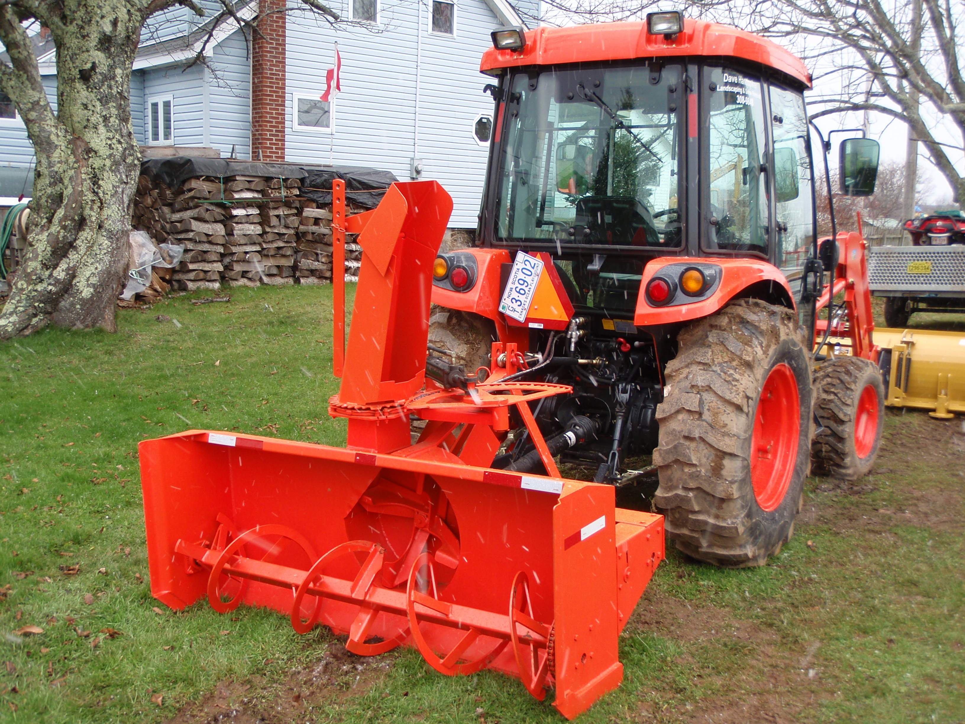

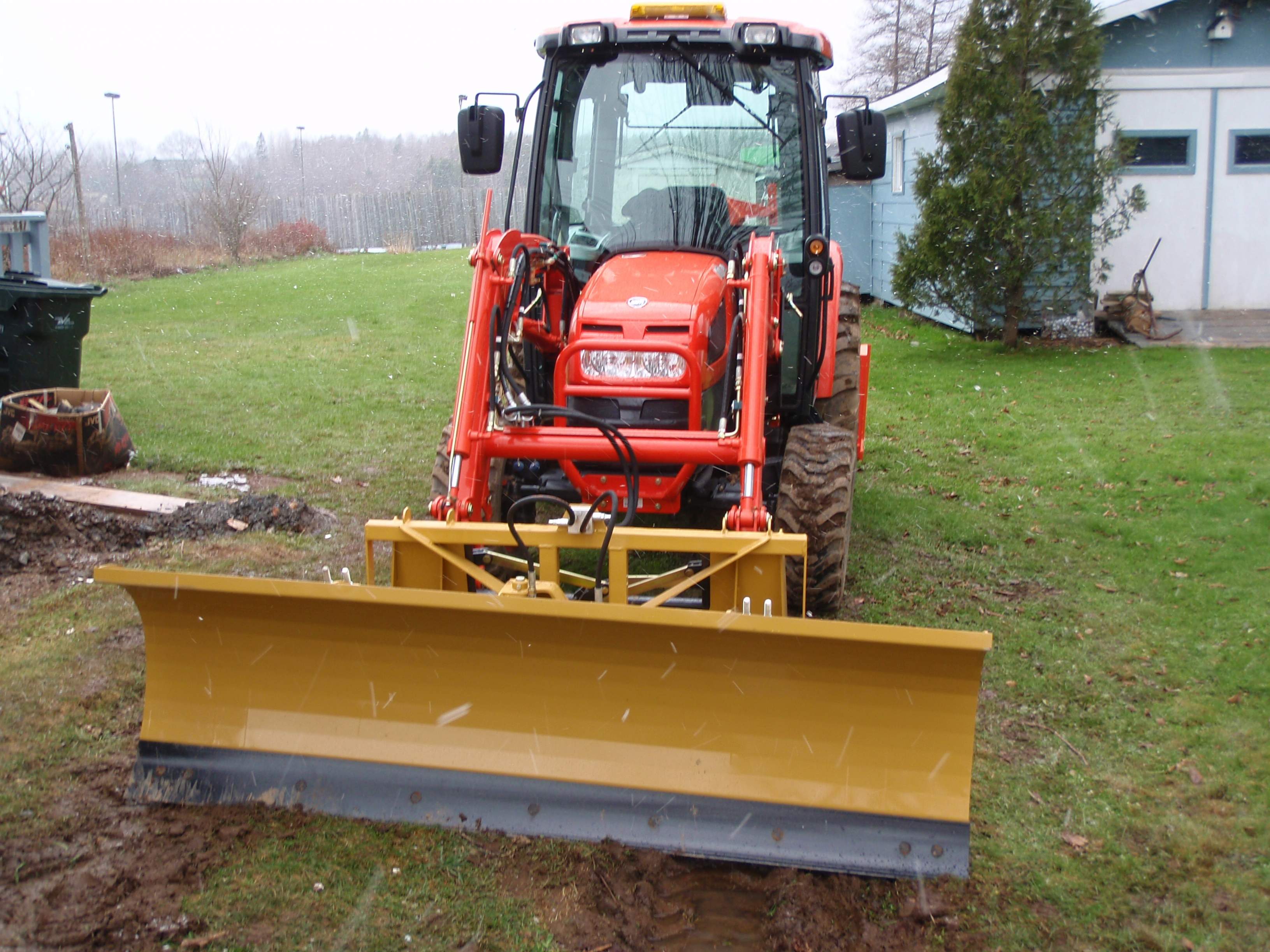

Hi all,
I just completed the install of a 2nd remote kit (T4145-A04040302) on my DK40se and would like to share some of the things that I learned the hard way.
1) buy 2 10mm x 1.25 nuts to install the longer studs. Put the first nut on and use the second to lock the first nut in place. Thread the stud completelly into the casting and then remove the two nuts.
2) the new valve is stacked onto the existing valve and will be closest to the rear wheel side of the tractor. Not towards the center of the tractor as I read here. The control levers will not function properlly as one is taller than the other.
3) the new valve comes with the orings already installed, no need of the orings (04810-00100 and 04810-00160) in the kit. Orings are found only on 1 side of the valve body.
4)the snap ring on the lever shaft is hard to get at. I had to access it through the side panel and had a tough time getting it back on.
5) the seat is heavy and an extra set of hands helped get the seat out/in without banging something up.
Although it took me longer than 2 hours complete, it was not too difficult. Thanks for everyone's input that gave me the confidence to attempt the install.
I now have a set of remotes for my hydraulic chute control for my rear blower and a set of remotes for my new power angle plow. Blower is a Pronovost 74 inch, plow is a HLA 2000 at 84 inches.
Bring on the snow !!!!!!!!!!

Thanks for the details!
Do you think you will need tire chains?
Even with multiple snow remove tools at my disposal I prefer it to rain in southern Maine and turn to snow when it hits your neck of the woods so you can have fun!
