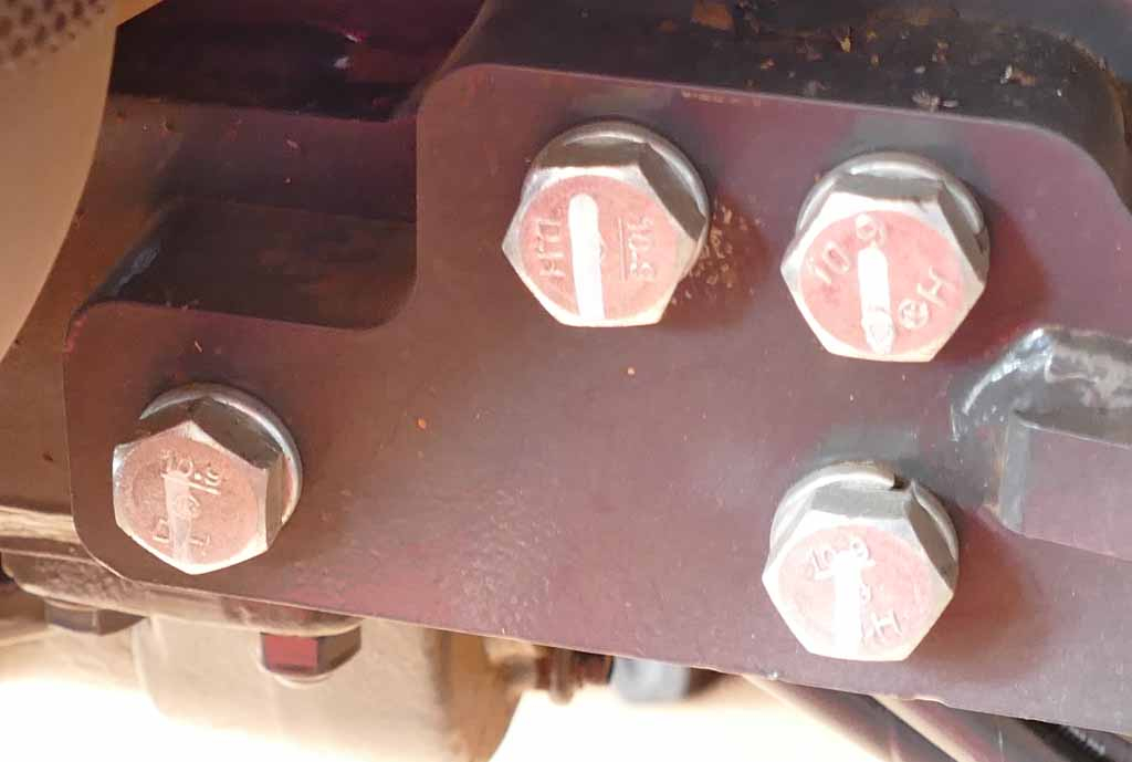

Hmm, seems the question here is how did the crack appear? Bolts coming loose after the major crack appeared are obvious, crack runs right over bolt holes. But the origination is in question. Abuse or prior manufacturing defect? Not picking sides, just musing.

ya, im confused about op problems. i tightened my loader when i got tractor, and again after 25 hours of work. i check it 2 - 3 times a year but i have never had to retiughten any bolts. they all hold just fine. no thread locker ever used. have about 1400 hours on tractor now and owned it for 10 years

tractor has really never given me any issues until the bolts/loader problems appeared.. it’s still a good running and strong tractor just I got no loader.. really sucks when we got crap loads of snow to move!
   / Kioti tractor issues. #30
There's a lot of curiosities about this case...
the original rep had some notes from the first place and had it in there i re-tapped and bigger bolts! ( which was a complete lie from the first dealer) got the bolts from the mechanic and correct tap!
This should be trivial to prove.
Have the holes been re-tapped larger?
If not, shouldn't be your liability, and you can demonstrate that they're the proper size (can't you?).
If so, who tapped them?
If the dealer, their liability.
If you, why did you use a larger tap?
If you were told to by the dealer, could be their fault.
If you did it independently, your fault.
Someone early on in this thread noted that the holes in the loader bracket are considerably larger than the bolts.
Is this loader supposed to go to this tractor?
Were those holes enlarged since purchase? By who?
