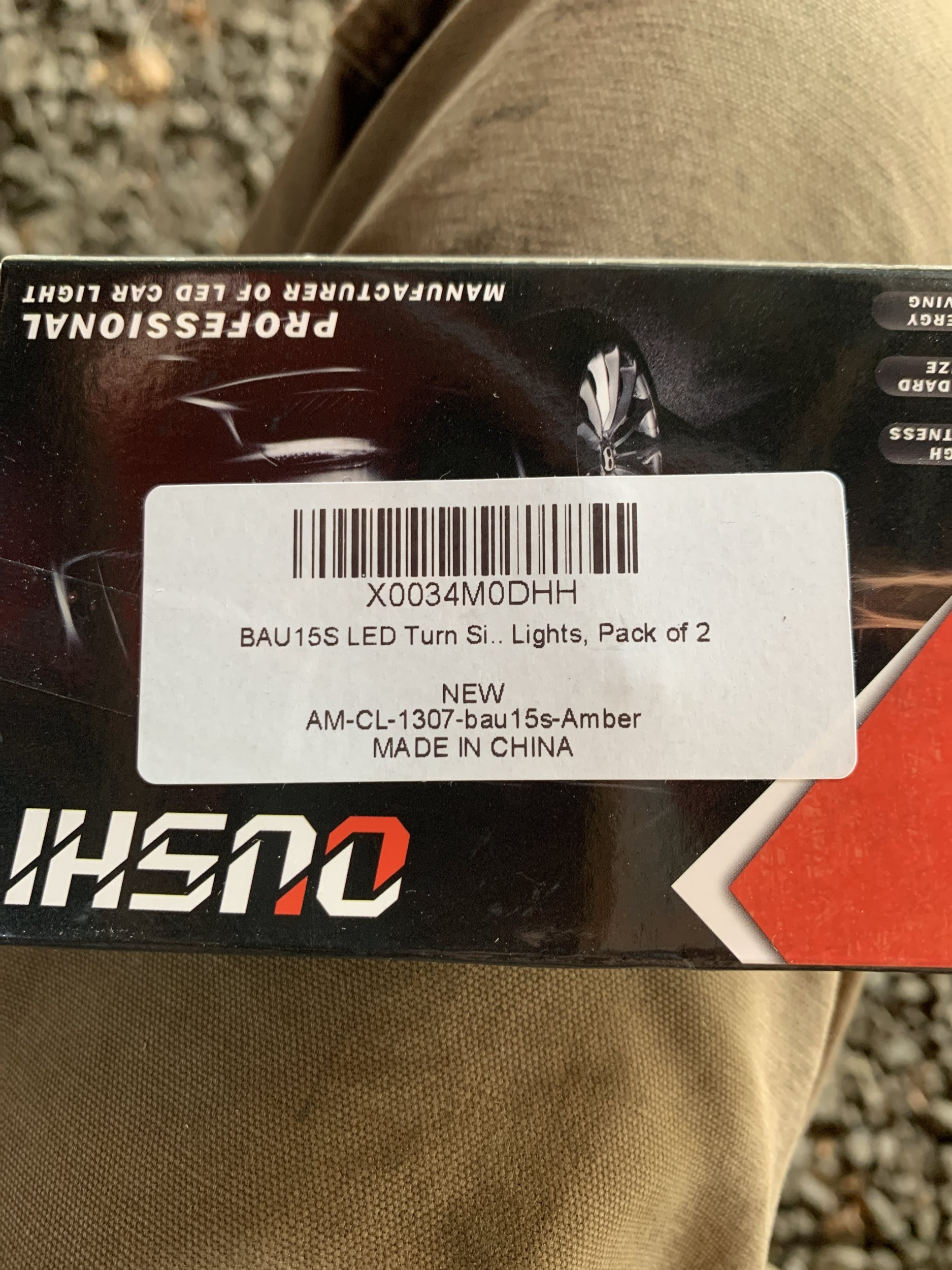

I bought these to replace the BA15S (1156) bulbs. Haven't replaced the others yet.
Well the 2 pack of BAU15S ambers arrived today and sure enough the flashers blink same speed as if a bulb is burnt out. So what options does that leave, back to incandescent again ?? Surely they has to be one type of LED that will work in this application
Track down your flasher and see what it is. If it isn't an 'Electronic', swap it out for one.
Why the LEDs hyper flash
This one is a 2-pin just for an example, but they have other versions if needed.
You can also use a 'load resistor' but easier to swap the flasher, unless you dont actually have a flasher.

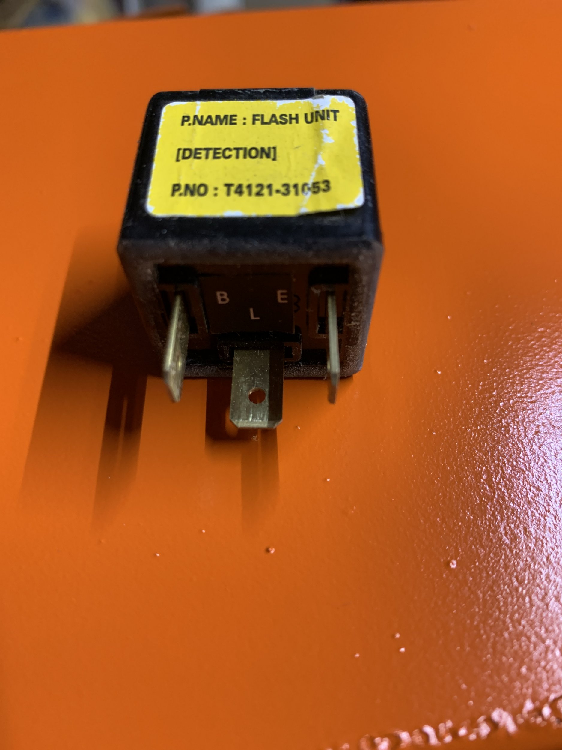

I’ll finish reading your post soon as I have time to sit down but what a spot they had the flasher buried in. Is this what you or is called an electronic flasher ??

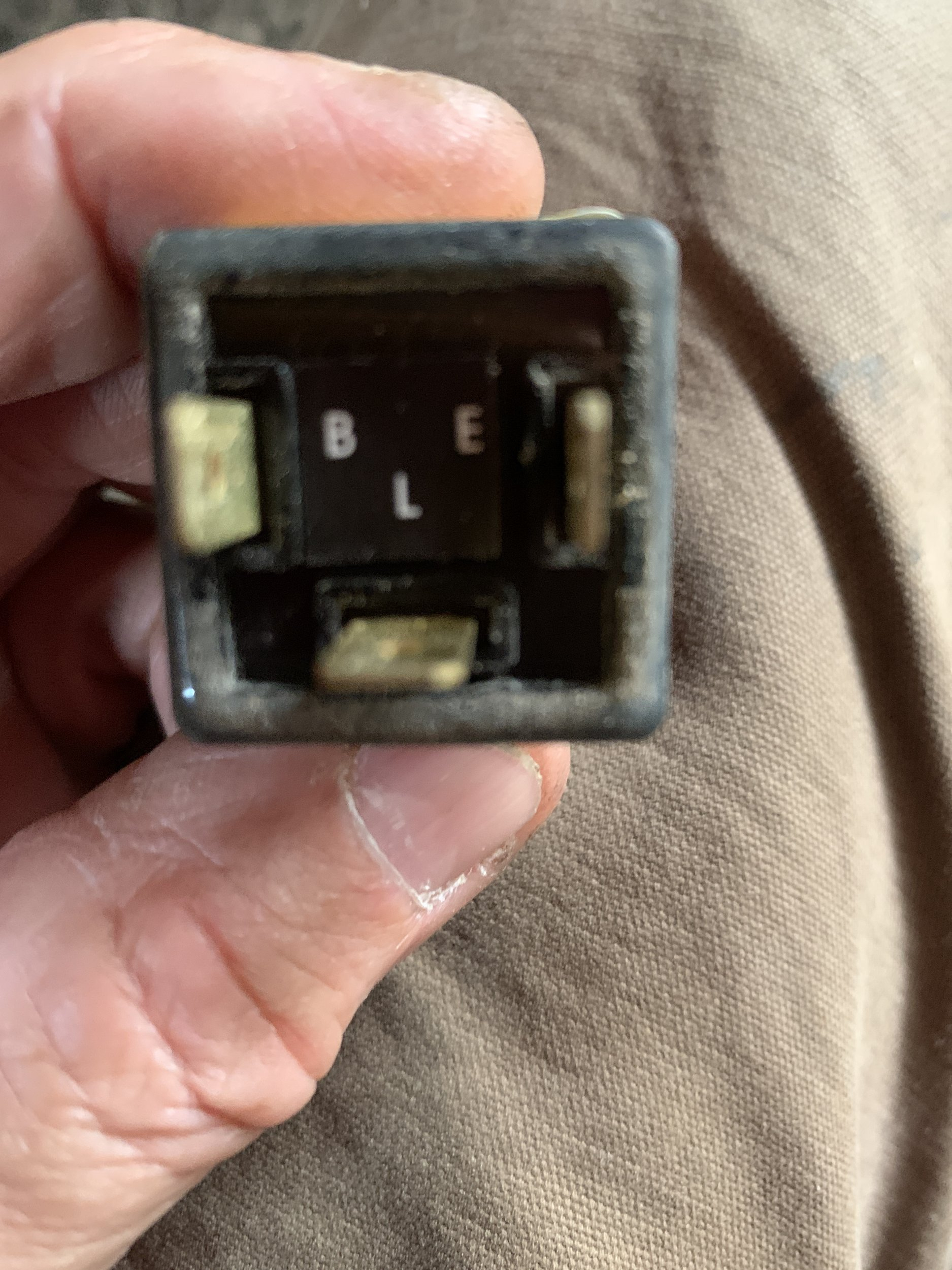

Not sure what the letters represent or why anything more than 2 pins are required for blinkers…hmmmm plus this OEM flasher has a metal lug where it bolts up underneath the dash
Yep. Replace that with an electronic one made for leds.
B is Pos+, E is Neg- and L is the output to the leds..

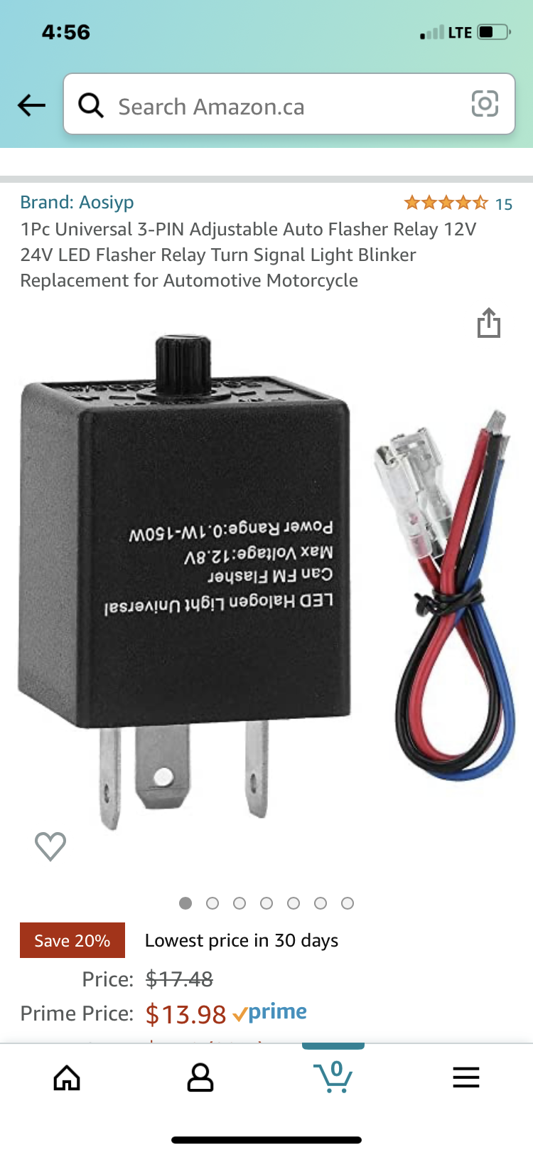

Well hopefully this will do the trick because I just ordered it. Has a potentiometer on it to adjust speed.

That should do. If the pinouts are different you can use the wire pigtails to solve that.
