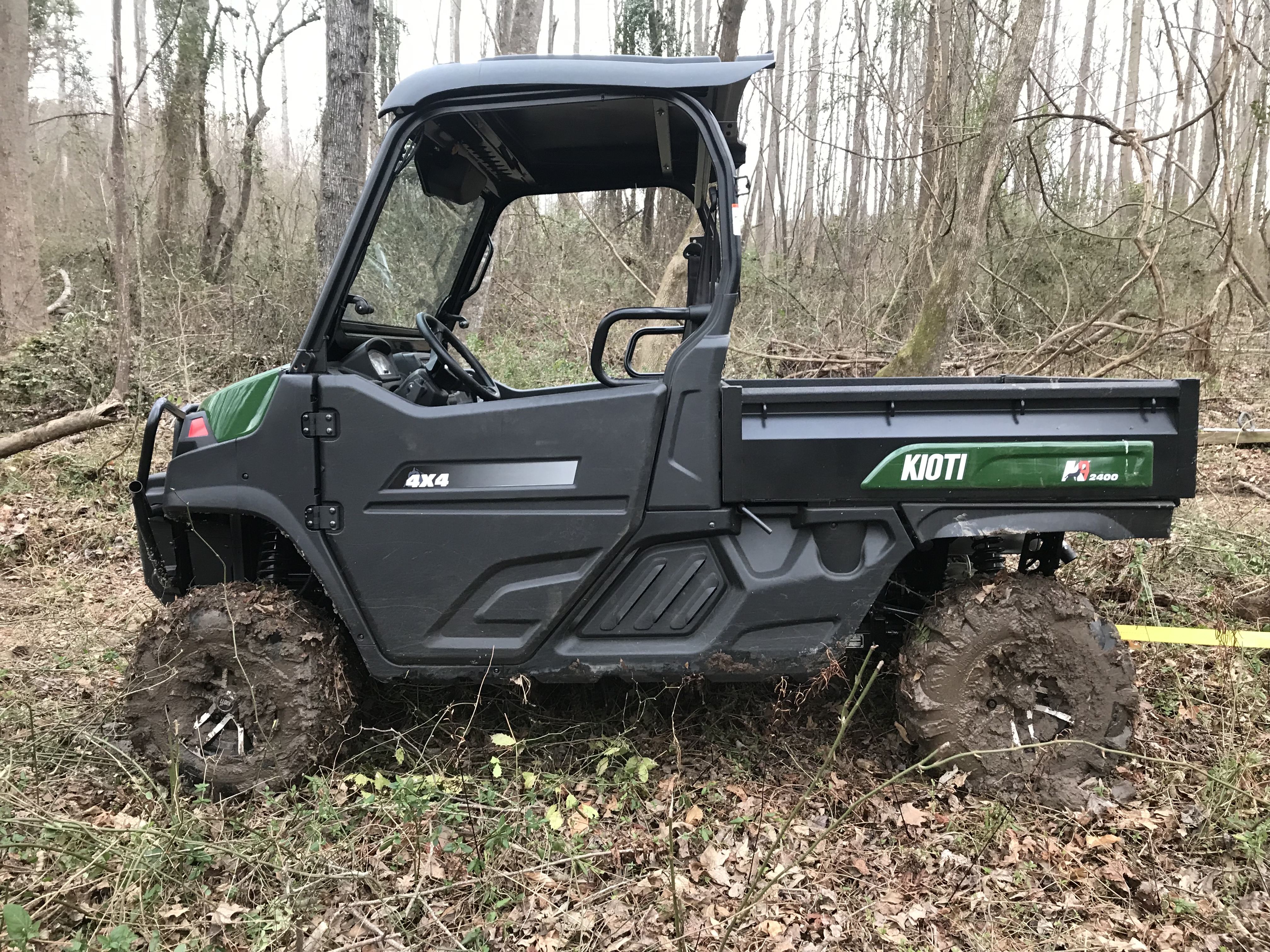

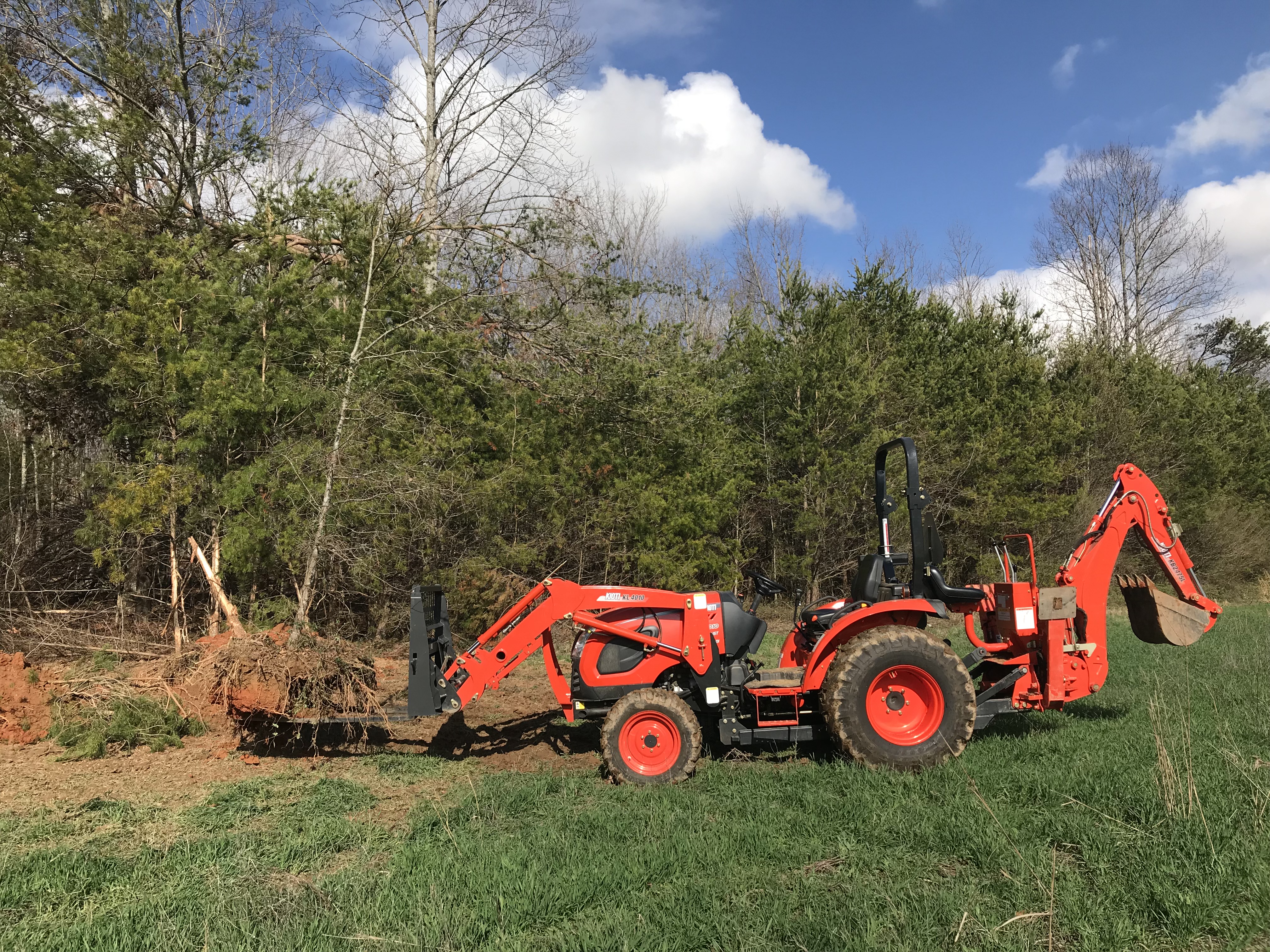

Here you go! The tractor is Kubota orange and the UTV is JD green! How ironic!

Both look great Sloppy Joe!
Good, you got the pics thing down!
Here's my suggestion. Contact your dealer about what your backhoe is missing: 'Bigfoot pads' Sold by Kioti your stabilizers are useless without them They bolt right on and you'll notice a big difference in gription!
Kioti Bigfoot pads - Google Search
   / KIOTI Mechron users: Pros/Cons/Issues: chime in please.... #54
You must have read my mind Coyote, I have been thinking about those. How much are they?
#55
Don't know they were installed already on my hoe. I'd ask your dealer why yours doesn't have them. As far as I see it, they should be in the backhoe price, installed by dealer. I can't imaging the stabilizers do anything without them... Maybe they'll give you a pair?...:confused3: Can't hurt to ask...
