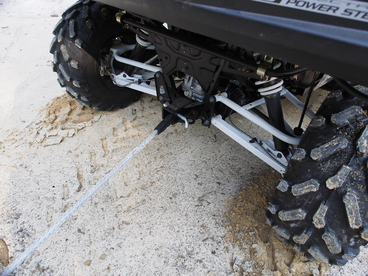

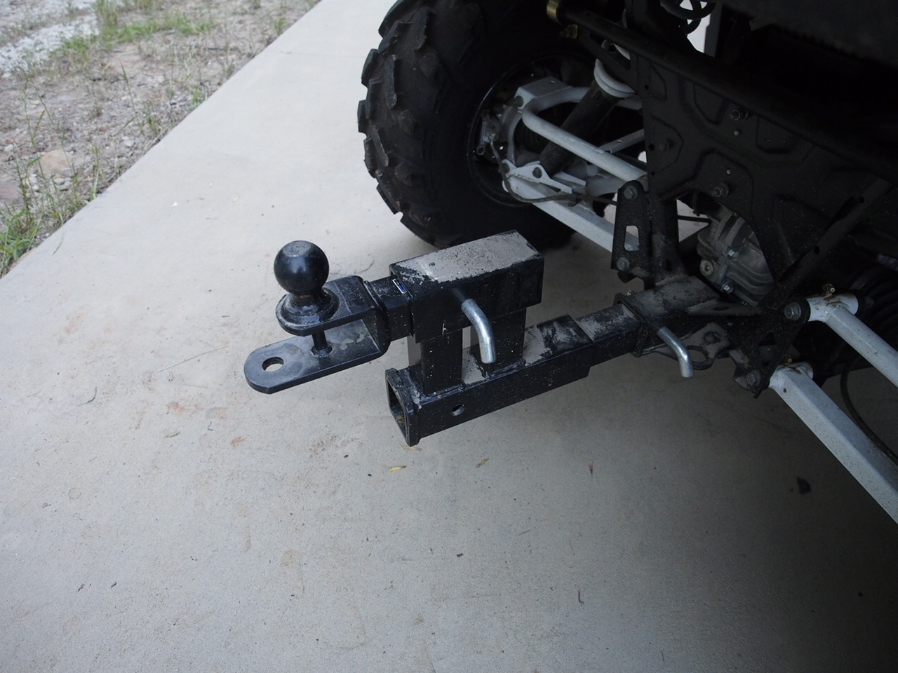

Attached are a couple pics of my Ranger for general comparison with yours. Note our ground clearances are similar per web sites but my tires have a deeper tread pattern (stock). Note the picture of the back of my ATV with synthetic rope attached. The other end of the rope is attached to the rear axle of a 2WD 2000 Toyota Tacoma truck stuck in the sand on a small decline in an area I am building up for a new shop to be built. The UTV pulled it right out. First tried using the UTV in open differential mode- one wheel drive and that tire spun. Then locked the rear axle (all electronic) and had wheel spin in the relatively soft soil I was sitting on. Then put it is AWD and pulled the truck out easily with no wheel spin.

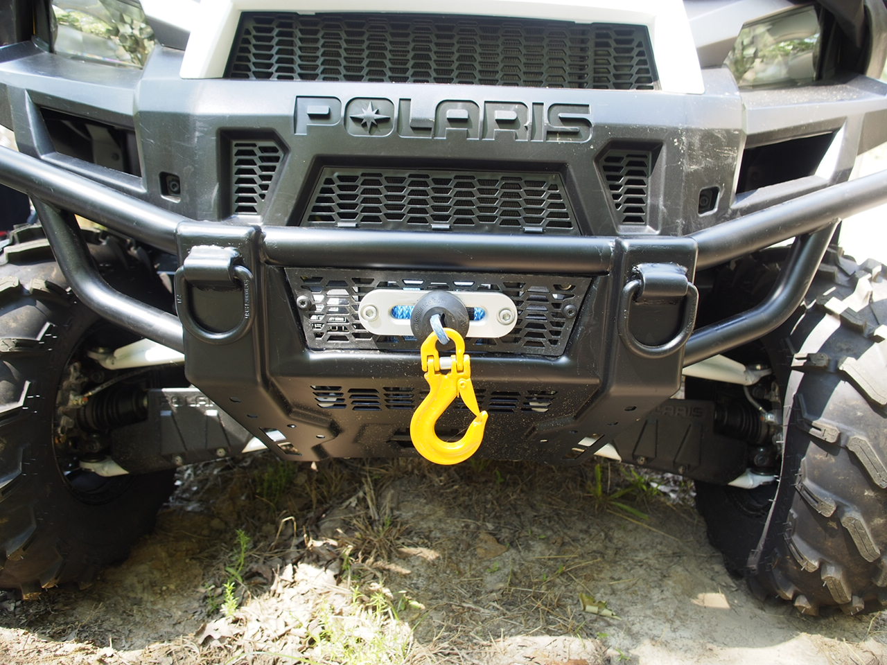

Winches and pulling tow points: I have mounted winches on my vehicles for many years and have even used one on my Kioti DK45HST and on my trailers. I have never had to use them for self extraction but have used them for many other things, such as pulling out my stuck truck with the UTV, pulling out a friend's old Ford tractor that was mired in sandy loam mud nearly to the axles using my Jeep GC, righting an old storage shed so I could prop it up using 2 x 4s, at the 3PH on the tractor to help guide leaning trees I was cutting down to clear my property for a new home, to load a different old Ford tractor with flat tires and no motivation onto a U-haul trailer, using the UTV to stretch tight a new fence being built using 6' horse fence, and on and on. I will always have electric winches on my appropriate vehicles and trailers.
In general (opinions vary...), an electric vehicle winch should be rated to pull 1.5 times - 2 times the weight of whatever one may be pulling that has good, rolling tires on it. The higher the ratio the easier it is on the winch and vehicle battery. Examples: My Jeep GC loaded weighed ~ 5000 pounds and its winch was rated at 9500 pounds; nearly 2:1 and my sweet spot. My Ram 2500 diesel truck has an expected max winching weight of ~ 10,000 pounds and its winch is rated at 12000 pounds. Barely adequate should I have to self recover but it was the largest winch I could fit into the winch bumper I decided to use. However, I have several pulley snatch blocks with every winch I have that can be used to double the pulley power of the winch. Our local country fire dept. also has a 12k winch on their 1 ton, 4WD brush truck. But I think a 15k winch would be better for both vehicles.
For my Polaris UTV, I selected a Polaris branded, Warn 4500# rated winch. It was a factory option and I had the dealer install it. He was giving me 25% off any accessory, helmets, whatever with free installation. For self recovery my UTV should never weigh more than 3000 pounds so my 4500# winch would give me a 1.5: 1 ratio, which is ~ industry standard as I recall. Plus I also have a couple pulley blocks. There are many options for my Polaris but I was not able to find much for your Mechron. But Kioti does have a 3000# winch option. Personally I would want more- 4500#, but your problem is finding an after market winch mount. Most winches (UTV different than auto type) have standard bolt patterns but the vehicle mount would be the issue. Maybe you could purchase a Kioti winch mount and an after market winch? The winches basically come as a complete kit except for vehicle mount. One may have to add wiring from the winch to the battery as a worse case scenario. Most UTV winches are mounted behind the front bumper/brush guard.
Note I also welded a pair of of 4000# working load shackles up front to act as tow points, drag points or a place to attach the end of the winch rope back on itself if using a snatch block pulley to double the winches pulling power. Both shackles are welded to points with direct, steel attachment to the UTV frame area, so are strong. And one also needs a strong attachment point at the rear, which fortunately, you and I have with the 2" receiver. All of my winches have synthetic rope vs. steel wire rope as synthetic is much lighter and far safer than wire rope, but is more expensive and has less abrasion resistance.

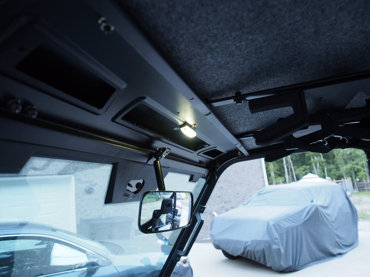

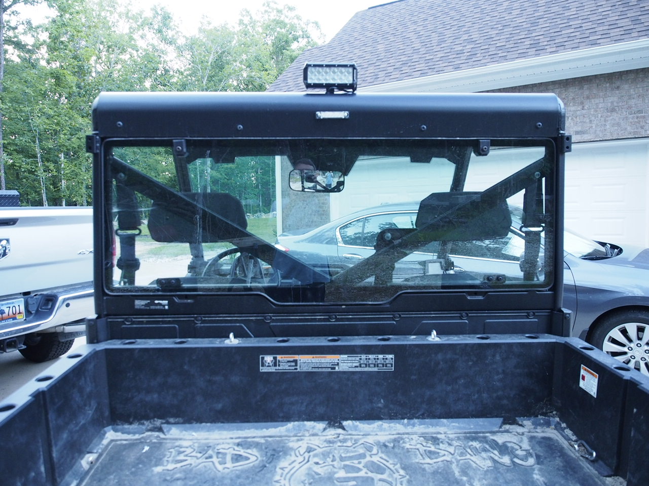

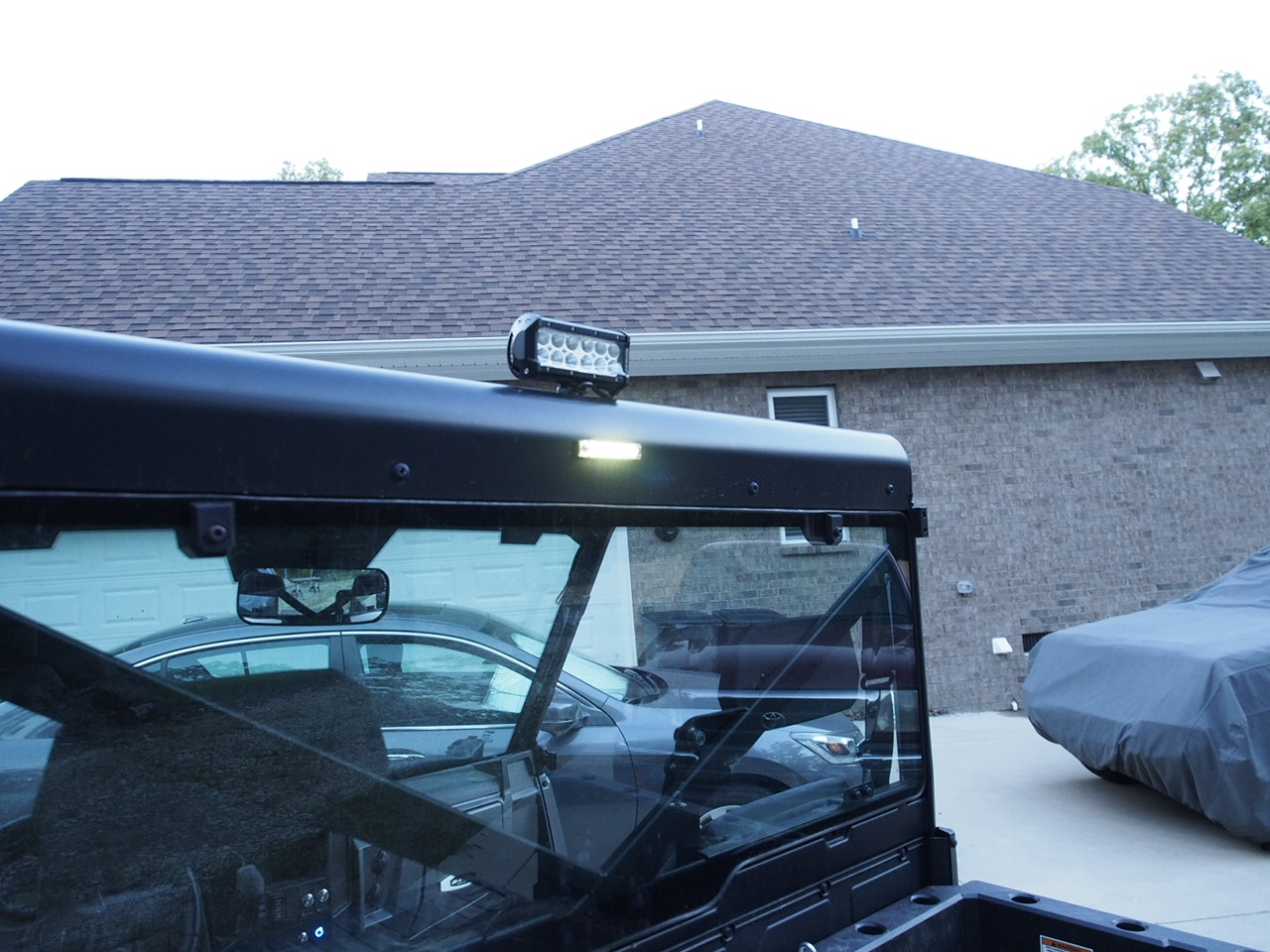

Lighting: My tractor and UTV have auxillary LED work lights I added front and rear (in process of wiring the rear) and should be mandatory, I think. I also added a LED dome light for inside the cab and a LED bed light outside the cab. LEDs use much less power while providing greater light output and bulb reliability. Polaris had an incandescent dome light option I was not interested in and just added these instead: EZ LED Cargo Light Kit: Polaris Ranger Razor Crew Diesel, Yamaha Rhino, Can-Am Commander, Kawasaki Teryx Mule, Arctic Cat Prowler, Honda Big Red MUV Kioti does list a front working light option. But LED light assemblies are standard fare these days and can be purchased most places and installed.
