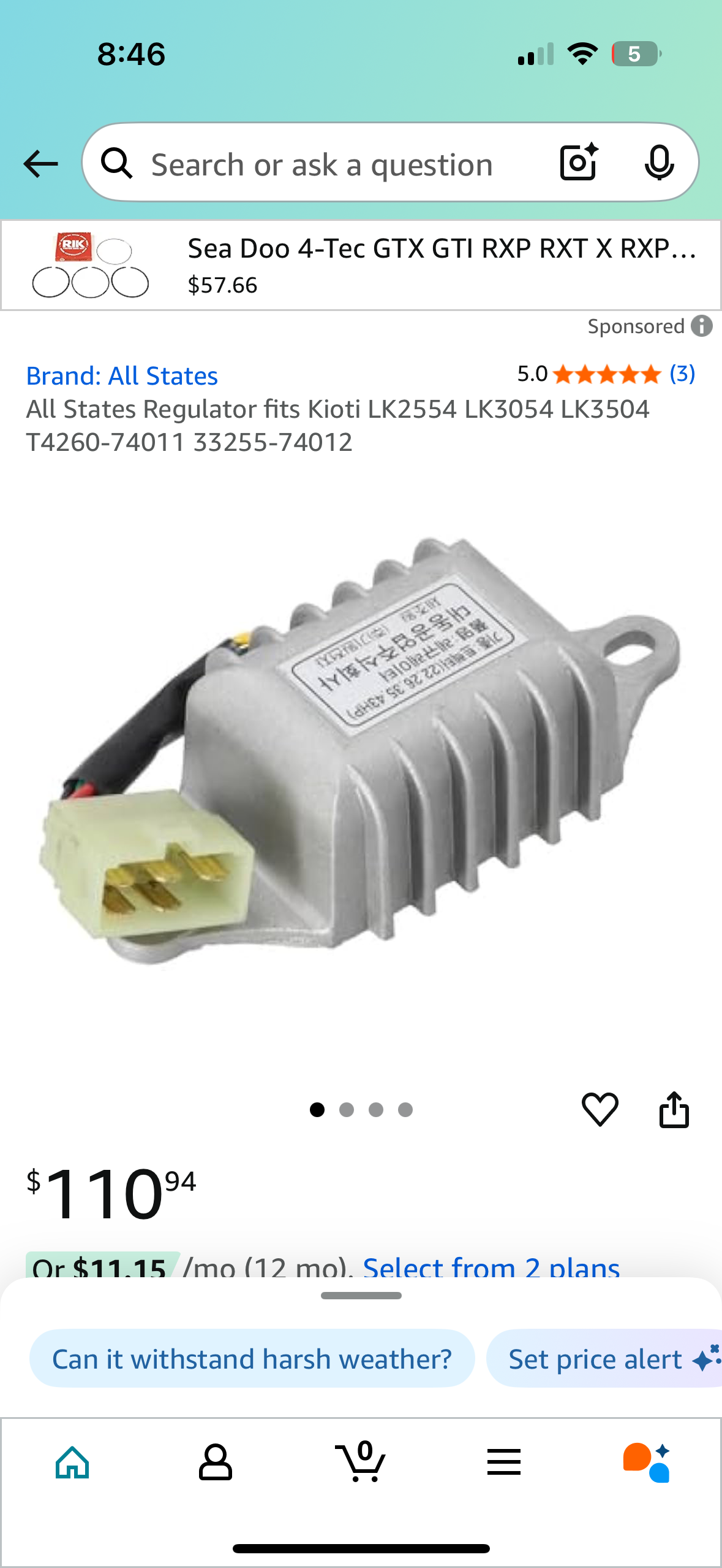

So my sight glass on the tractor is half way up the window. Taking the cap off I noticed a lot of bubble/air. Does the fluid need to be at the top of the sight glass? Also can anyone tell me what the regular later does? I purchased this tractor and noticed I don’t have one. Sorry for the double question. Thanks so much

The regulator is voltage regulator for your charging system. It mounts on the firewall next to the fuse box. Some people have changed it to a solid state style that will look different but does the same thing. Also they could have changed to alternator to one with a built in regulator. You can check it with a voltmeter at the battery. Check the voltage before starting to see resting voltage of the battery. Then check it with the tractor running and you should notice a higher voltage. If it is around 14 volts your regulator is working.
