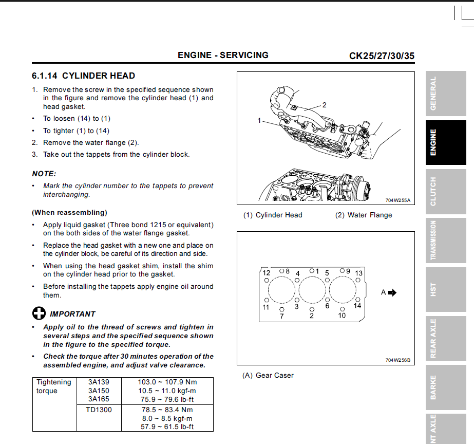

Sep 14, 2024 / Kioti head torque specs #1 Alan46 Elite Member Joined Apr 3, 2019 Messages 3,117 Location Estacada Oregon Tractor KiotiCK25 HST Can anyone here post a link for the Head bolt torque specs for a 2005 kioti CK25 HST? Many thanks!
Sep 14, 2024 / Kioti head torque specs #2 ptsg Super Member Joined Apr 3, 2013 Messages 7,779 Location Portugal Tractor Branson F36Rn - Agria 8900D
Sep 14, 2024 / Kioti head torque specs Thread Starter #3 OP Alan46 Elite Member Joined Apr 3, 2019 Messages 3,117 Location Estacada Oregon Tractor KiotiCK25 HST ptsg said: View attachment 1154926 Click to expand... Thank you for the quick reply!
Sep 14, 2024 / Kioti head torque specs #4 ptsg Super Member Joined Apr 3, 2013 Messages 7,779 Location Portugal Tractor Branson F36Rn - Agria 8900D Alan46 said: Thank you for the quick reply! Click to expand... No worries. Glad I could help.
