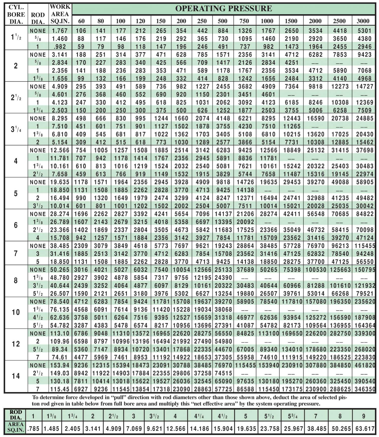

/ Kioti CS2410 with splitfire log splitter #22
Here is a chart for force of a cylinder with both extending and retracting forces. There tons of these on the net.
Steve

Thread from the dead, but its some good info and thought.
I'm about to modify an elec splitter with a shot motor to use on the tractor and mount on the 3pt. Been doing the math to see how it will work.
My CS2410 puts out 6.5gpm and 1850psi from the aux ports at the back.
The splitter cyl. I haven't measured, so I'll use the dimensions posted earlier in the thread, 2.75"x24"
Force=Area x pressure
a=Dsq x .8754 A=6.62 6.62x1850= 12,247pounds of force, or 6.12tons.
So that's going to be the power of the splitter. Now the cycle time....
Volume = Area x length 6.62 x 24 =158.8 cu in. A gallon is 231 cu in, so the cyl takes .68gal to fill.
That's close enough to one tenth of the 6.5gpm output so a full 24" stroke should be about 6 seconds. Thats one way, the other way (retract) the volume of the cyl will be less by the displacment of the rod, and a bit faster, although less power as well.
The pump, a gear pump with open center control, puts out 7hp.
Flow x psi/1714=HP 6.5x1850/1714=7.01
As pump outlet pressure increases, efficiancy deteriorates and flow slows a bit, but full 24" stroke is almost never needed either, most often 6-8" will break a block. So cycle time should be 4ish seconds.
