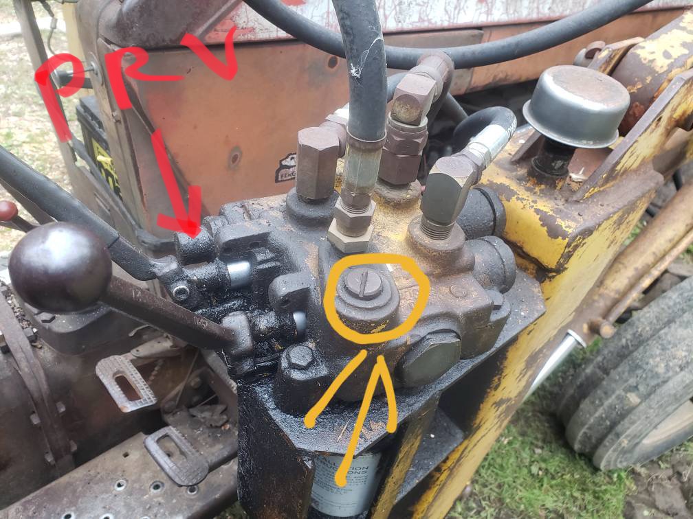

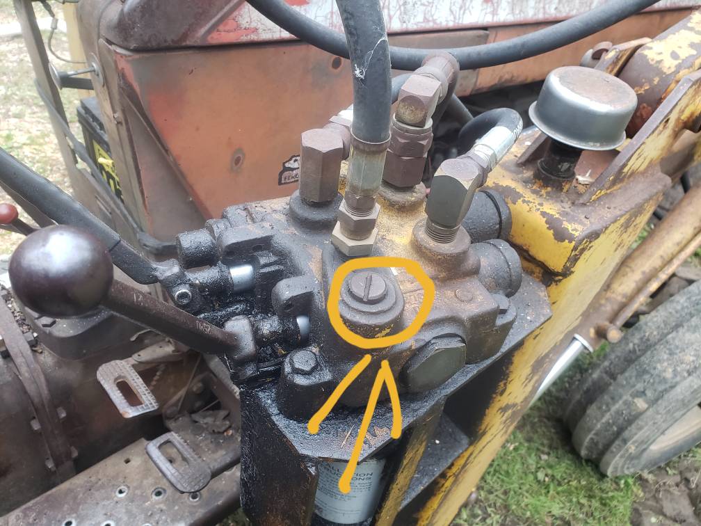

That's why I was hoping this plug was a tank return port. How can I determine if it is? I can't find any markings on the valve assembly to hint who the manufacturer is, short of unbolting it to examine the underside.View attachment 672314

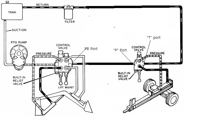

Look at "tank", there will be two lines, one is suction from tank to pump, the other should go to valve as the "tank" return line....
I only see four lines at valve they should be for "curl" (2) and "lift" (2).... Any other lines we can not see graphic, how about under valve and back side of valve next to engine shroud... I am not seeing the power "P" input to valve from pump and not seeing the tank "T" line back to tank.... Why am I missing these...
Hydraulics Systems Diagrams and Formulas | Cross Mfg.
I really think this is what you are trying to accomplish is it not?....
672378d1602130705-log-splitter-off-fel-pump-fel-plus-lsplitter-jpg
672408d1602173501-log-splitter-off-fel-pump-fel-plus-lsplitter-looped-out

Thanks to EVERYONE for your input. So for simplicity sake if I'm absorbing all this info correctly, the easiest would be the quick couplers attached to the curl line. Which would disable the curl while the splitter was attached but I should still be able to raise and lower the bucket to move the tractor. As far as the return to tank line, I guess I need to determine what loader spool I have. If the port on top of my spool that I pointed out that is not in use is in fact a tank return I could plumb the return line with a quick coupler back in there? Correct . No extra valves or anything before the splitter? Thanks again everyone. If PTSG is correct on my output of 16GPM at 2500 rpms, is this going to be worth it, I like to run the tractor around 1000 rpms, or does the front pump rotate at a different rpm than the engine tach?
I agree but you will have your curl valve in prior to your splitter. Meaning you will have to have that valve in the curl operation position in order for fluid to flow from your to your splitter. If the valve returns to center for some reason, you will have no flow to your splitter.
This is why so many have suggested the power beyond port. It will flow fluid without any valve control other than splitter control. However you mostly likely will need to have that return to tank when the splitter is not installed with a hose between the 2 splitter connection locations.
Already stated about 10 times and easily accomplished with a $1.00 bungee cord or tarp strap.

My thoughts exactly, if it works fine I definitely would like to go the power beyond route. But at this point I can't even figure out what make the loader valve is to get the power beyond plug/adapter. Thanks again everyone for the input.
/ log splitter off FEL pump #53
Gresen SSK (read my prior post)
