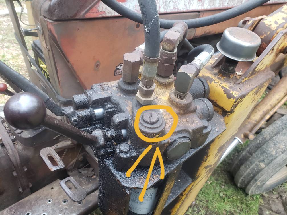

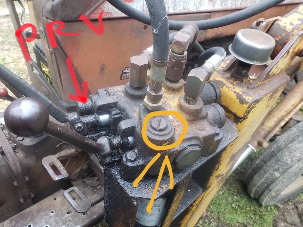

Is this where that might hook up? If not does anyone know what this would be for? Thanks everyone for your time. View attachment 672134
This port is an optional return to tank port (see page #20 on post #7), not a place to tap into power beyond, reread post #6 for the correct port adapter plug.
/ log splitter off FEL pump #25
If I was to guess that may be a pressure relief setting...............
Pressure relief valve

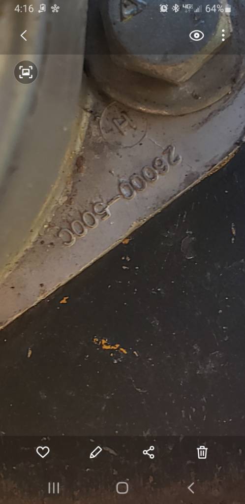

I wouldn't swear that the valve in question is a Gresen,
the raised casting running fromthe valve output to the screw plug does not look like any of the pictures I have seen of a Gresen and not on the link posted back in post #7.
While I would agree that most likely a power beyond plug would go in the side center port, that would make the screw plugged port a return to tank, maybe.

That's why I was hoping this plug was a tank return port. How can I determine if it is? I can't find any markings on the valve assembly to hint who the manufacturer is, short of unbolting it to examine the underside.20201006_071928.jpeg

Rig up a tee fitting were your tank fill/Breather is,
could even go high dollar and install a return line filter to help keep the hydraulic fluid clean.
I would expect that you should see considerable better cycle time on your spliter when run at the same rpm you use now.
