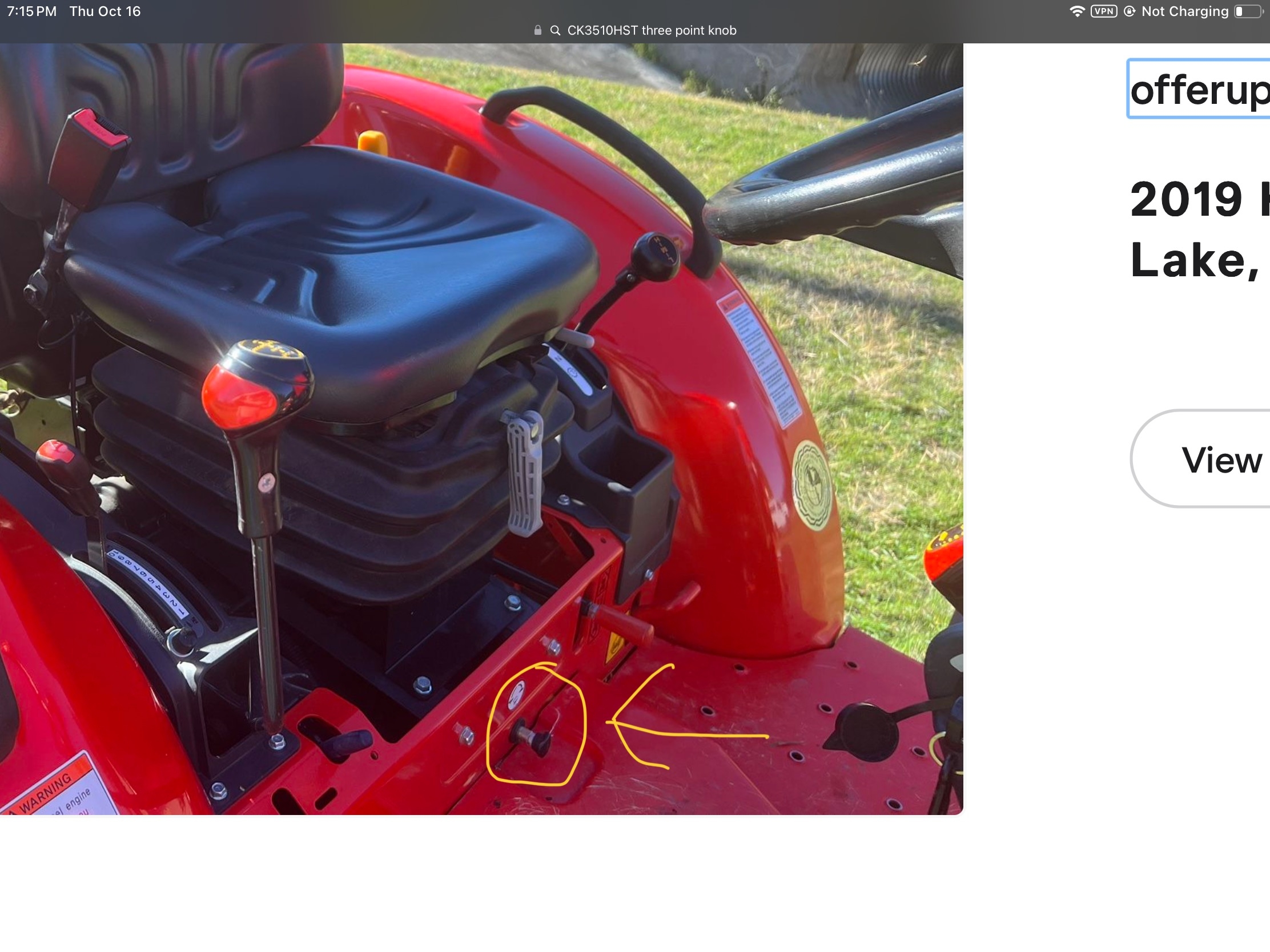

Have you checked the flow control knob under the seat. It twists either right or left
   / Kioti CK3510HST 3pt won't raise. #3
I will go out on a limb and say that for about 90% of owners with a new tractor that is the problem when the 3 point hitch arms won't raise.

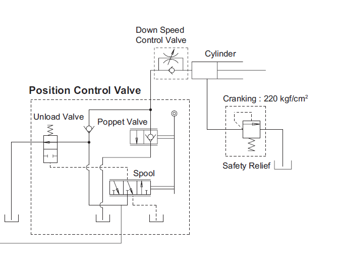

That knob only adjusts the speed the 3 pt drops or if closed all the way, prevents the 3 pt from lowering entirely. It will still let it raise at full speed in any of the positions of the knob.
I suspect the issue is on of the remotes stuck in detent mode.
And for sanity sake. Note the check valve on the down speed control valve (that knob under the seat). This check valve lets the fluid pass without any restriction to raise the 3 pt but will prevent it from lowering by forcing the fluid to go through the flow control valve.
