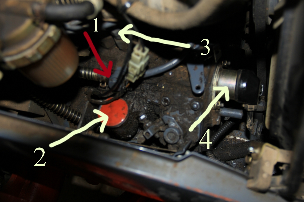

I have never had a problem starting my CK30 but today it will not start. It does crank ok so the battery is ok (new). I have checked and bled the fuel line up to bolt #1 in the enclosed picture. fuel.jpg or http://2881neches.com/kioti/fuel.jpg. No problem. However, if I lose the fuel line going to the injectors (#3) I get nothing. Thought the fuel shut of solenoid #4 would not work but it does.
There is an orange cap shown here as #2. Can't find any reference to it in my manual. What is suppose to go in here. Oil or what?
Any hint would be appreciated.
/ Kioti CK30 will not start #2
The orange cap is the engine oil fill. You should use that instead of the cap on the valve cover. If you fill at the valve cover to fast oil will not be able to get to the sump fast enough causing it to flow through the breather hose into the intake filling any cylinder with the intake valve open causing hydraulic lock when you start the engine.
What year is the tractor?
/ Kioti CK30 will not start #4
I would first check the glow plugs to ensure they are getting power with the switch in the ON position and also while cranking. My DK key switch got wonky (not unusual) in a way that cut power to the glow plugs while cranking. I mention this first because (while unlikely) it is the cheapest and easiest to fix.
The lack of fuel to the injector while cranking suggests an IP gear tooth failure. The typical symptoms of this failure are: ran fine, shut off, won't restart. See: http://www.tractorbynet.com/forums/kioti-owning-operating/296793-repair-option-kioti-tractors-broken.html

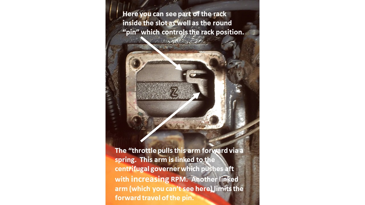

This is harder and more expensive to fix. You can check the IP by removing the oil-fill cover (#2 in your photo) to see if the IP rack moves freely or if it's jammed. You have a LOT of crud in that area so clean it before you unbolt anything. The stop solenoid will force the rack to the OFF, full aft, position by spring pressure when the switch is off. So turn the key to ON to retract the stop solenoid before you do the "feel" test on the IP rack. The rack should be lightly spring loaded to the forward (max fuel) position and rest against a lever from the centrifugal governor. You should be able to move the rack aft by light finger pressure if it's not jammed internally. If your IP is jammed, refer to the above link for options.

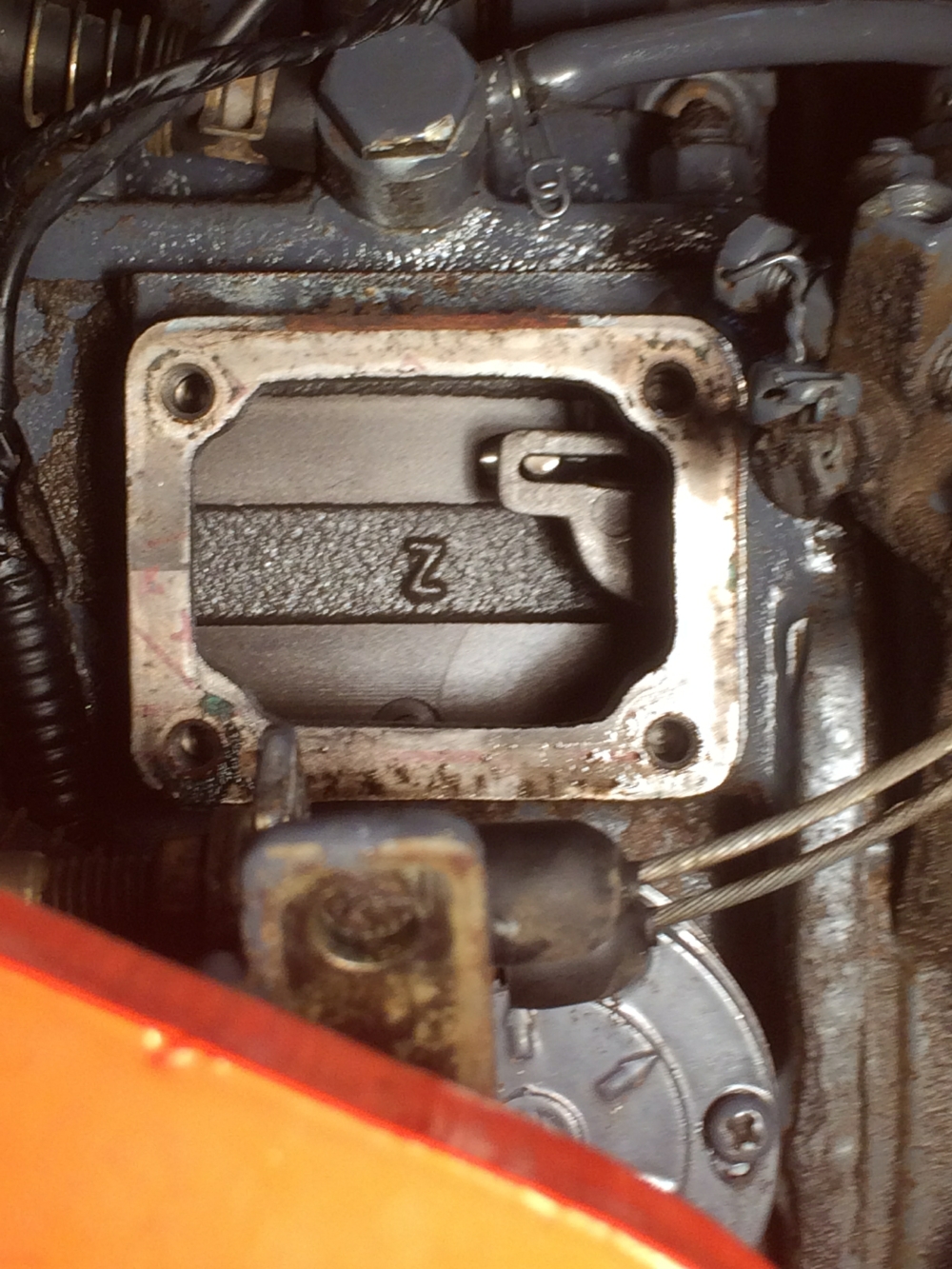

Hate to bug you again but I removed the plate and this is how it looks. I can't move the arm inside forward anything although I can move what you see here back with some spring tension about 1/2 inch. Further, when I removed the solenoid in the front you would expect it to have some tendency to push out if something was resting on it but there is nothing. That leads me to believe the arm is stuck or should it be like this? If not, any quick fix?View attachment 390285
Bernty, I saw your post in another (old) thread (http://www.tractorbynet.com/forums/kioti-owning-operating/312062-new-forum-kioti-ck30-will-5.html#post3893164 but I'm moving this reply back to the thread you started. It's easier for other posters can follow this if it's all in one place. Based on your observations, it sounds like your IP is indeed jammed. See this annotated pic:
Continuing after interruption from SWMBO: With the stop solenoid energized or removed, the rack should move full forward so the round pin rests against the flat face of the other governor lever (which is too far forward to see it in your photo). I think you are saying that the rack is still full aft and jammed in that position. If so you probably have broken gear teeth inside the injection pump. The official Kioti solution is to replace the injection pump. This is not too difficult and several owners have done this job DIY. The bad news is that a new IP costs in the vicinity od $1K. The same IP from a Bobcat dealer is slightly less. Several owners have had their IPs repaired at a local or regional Diesel shop (see the sticky post at the top of the Kioti Owning/Operating forum. These gears are symmetrical and some owners "fixed" their IP by reinstalling the bad gear 180 rotated degrees.
If you IP rack is truly jammed your next step is to remove the IP. I recommend you review the maintenance manual before attempting this. You may want to send a private message to other CK owner(s) who have done this job (see the spreadsheet linked in the sticky). One piece of good news: you don't need to re-time a new/rebuilt IP, just be sure to keep the spacers and gaskets under the IP which establish the injection timing.

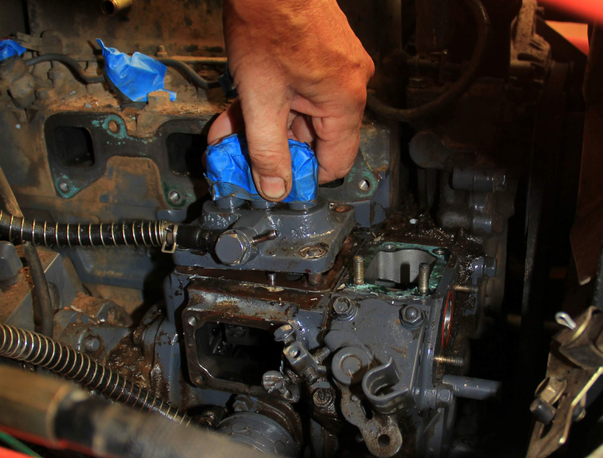

So I spent the day taking everything apart in order to get to the IP. I have good pictures with step by step to get there that I will post later but now I'm finally at the pump but it will not come out. Take a look at the picture. I can lift it about 1/2 inch in the front and a 1/4 inch in the back but that's it. Getting really frustrated. Does anyone have an idea? IP removal.jpg

Using a mirror I could see the rack, being so far back, prevented the removal. I had no other choice than using a rod in the idle hole banging it forwards until I was able to get it out. So here it is on the kitchen table ready to be taken apart. Can't move the rack without using force. Kind of wonder, how is this lubricated?
/ Kioti CK30 will not start #14
Using a mirror I could see the rack, being so far back, prevented the removal. I had no other choice than using a rod in the idle hole banging it forwards until I was able to get it out. So here it is on the kitchen table ready to be taken apart. Can't move the rack without using force. Kind of wonder, how is this lubricated? <img src="http://www.tractorbynet.com/forums/files/kioti-owning-operating/390374-kioti-ck30-will-not-start-img_0312-jpg"/>
... beating the rack back to get the unit out is not a good idea if your aim is to repair it.
These units are lubricated externally by oil splash and internally of course by diesel.
Kioti will suggest that after you have it out like you do, to get some Seafoam cleaner type stuff and sunk the whole unit completely submerged in that stuff in a pail for a week or so. If you can get anyone at Kioti to advise you at all they would tell you that, also to put conditioner in your diesel..... but don't waste your time.
None of that soaking stuff or that 180 degree rotation trick worked for me and I finally had enough of messing with it. I too couldn't resist finally beating "lightly" on the rack to get it to move.
Anyway, go get a new one from Michigan Iron. Easy to install. Your tractor will probably then work like it was new.
It is about a grand for a new unit but well worth it in my opinion to just get a new guaranteed part.
Kioti corporate has apparently decided to accept a bad reputation with regard to these early pumps.
Hope all works out for you good for you with this. You will get lots of sympathy on this form regarding the pump but not much I'm the way of a satisfactory patch for this known Kioti problem.
