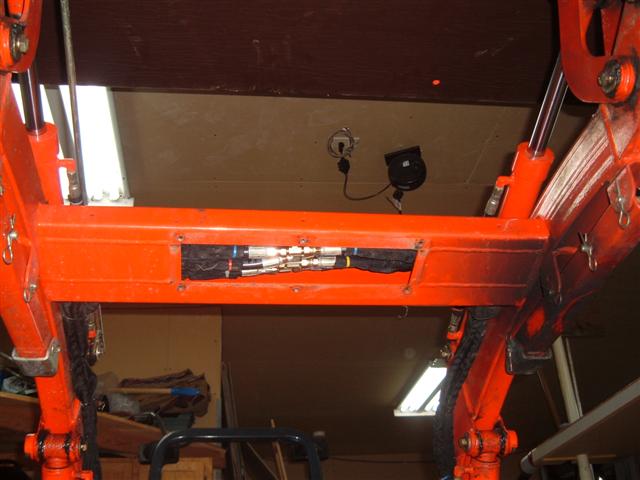

I might as well jump in here now and keep er' goin. This is a picture of my CK20 with the similar problem as Beamer's. It's cracked at all four corners as well. Mine is a year and a half old with a 170hrs on it. I inspected mine when he first brought this to our attention and found mine cracked as well. I'll chock this up to the learning curve that Kioti is going through. Some people (and we all have our opinion) would want a new loader, others would be happy with a patch job. Myself, I will patch it when I think it becomes a problem. I bought the Kioti on price and what I perceived to be a good tractor(and I still think that). My last tractor was a Kubota that I bought new in 1986. It may have been slightly ahead of where Kioti is now in popularity at the time I purchased it, but not near as prominent as Kubota is now. I think Kubota has learned from feedback over the years as will Kioti (I hope). I had a few problems with my Kubota over the years, but not what I would call major. I could list them but it is pointless to me. They learn from what parts and pieces are sourced the most which leads to re-engineering these items whether they be bolts on up to an engine or transmission. It's just like a newly designed car, some people fear them til the bugs get worked out, while others will buy on looks or reputation or whatever. If there is a market then someone will try to fill it. If they want to succeed they will re-invest profits into research and development. If not then they will eventually go down the toilet. I respect everyone's point of view here, but just remember it's their point of view not yours. Thank you for your time and patience.

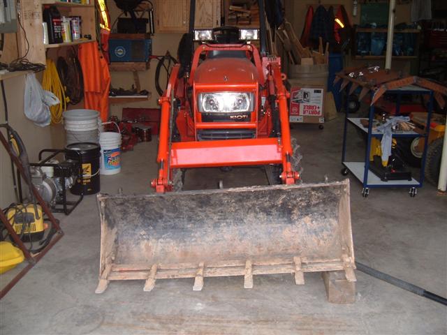

Call this stupid or whatever, but try this with your loader and maybe we can flame each brand individually. This is a six inch block of wood under one corner of the loader and down pressure until the front end starts to get light. My CK20 loader will twist this much. Is this too much or is it engineered to flex? I'm sure there will be varying opinions, but thats all they are. Maybe someone will learn something from this one way or another. But I thought is was interesting to try as I did it the first time by mistake by not moving a block completely out from under the FEL. Are other brands of loaders or tractors similar to this or are they rigid enough not to flex at all? I'm curious, are you?? /forums/images/graemlins/confused.gif
Again thanks for your time, I'll be watching with interest.
Steve
P.S. Sorry Highbeam, I hope I'm not hijacking your thread. I didn't mean too.

I don't have a concrete pad to do it on, but I tried it. Almost as some as it starts to lift, it lifts the side with the block off of the ground. It does move some where the loader is attached to the tractor. I did it on gravel. I don't know if that helped or not. In your picture, is one wheel off of the ground?

I notice the cracks always happens at the corners of the opening. Just wondering, were the bolts that attach the access cover tight? If loose I could see more of a chance of excessive flexing in that area. Just curious.

The wheel is still on the floor, it looks like it is off the floor because the wheels are turned a bit. Thanks Jerry, you didn't have to run right and do this you know.
