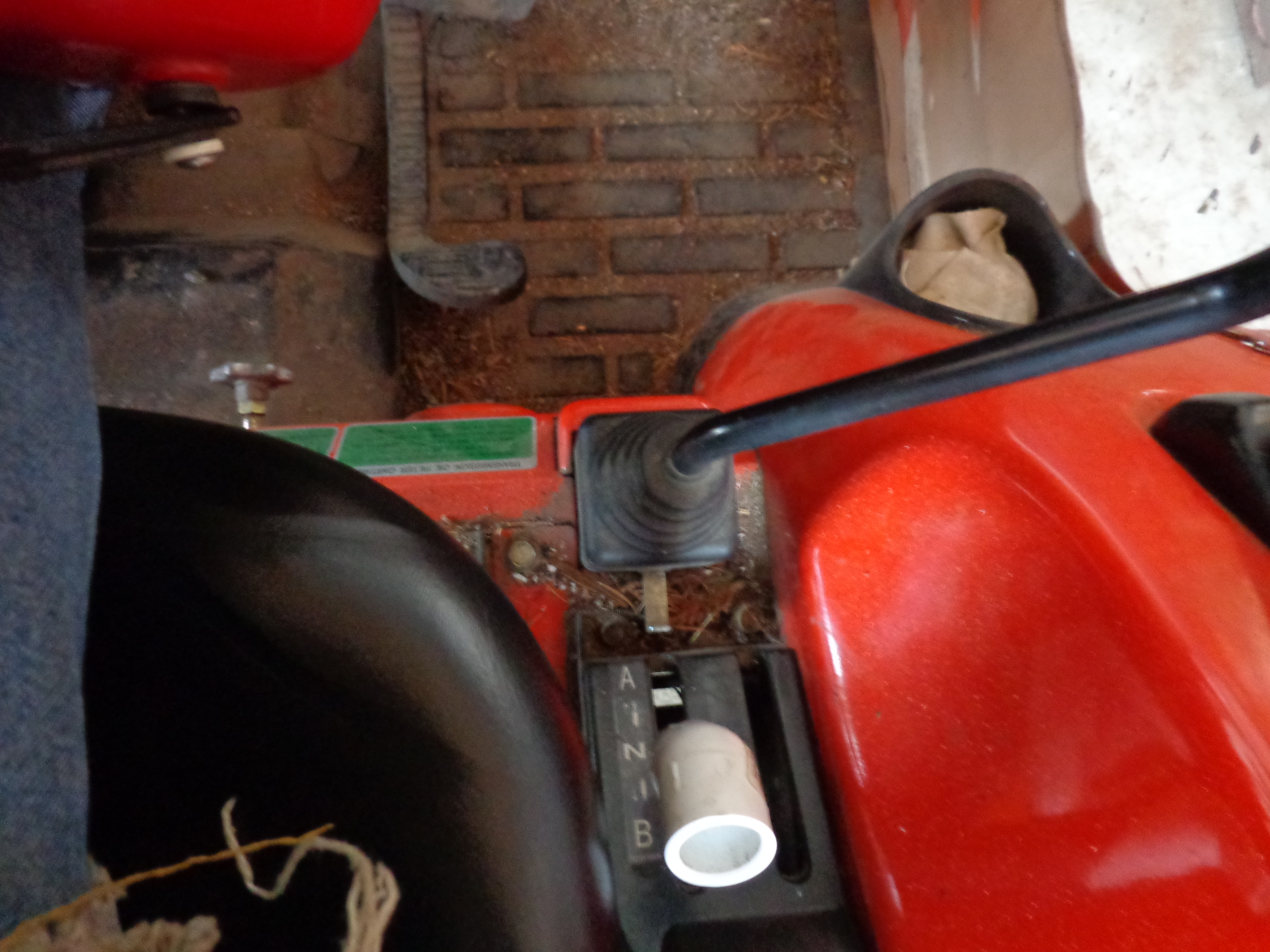

This is the way mine is looking at it sitting in the seat.
   / Kioti CK27 Joystick installed wrong... questions #12
The diagram is correct the joy stick is right just change the hoses .
the lock is fine where it is easier to get at.

Thanks, Billrog, that is the picture I wanted to see! :)

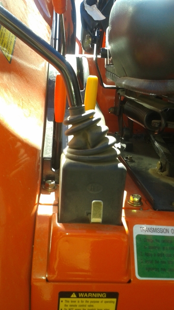

Here is why I'm working on this at all, one cable worked loose and the joystick was tilting further and further to the right.
Boot bellows show joystick leaning: boot.jpg

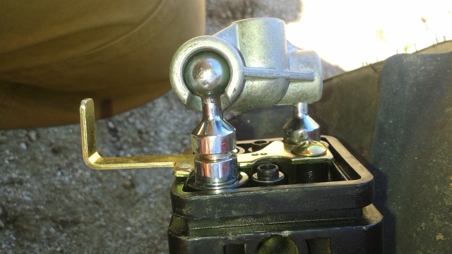

Piston out of adjustment (groove should be where locking bar can slide into the groove): plunger.jpg
Adjusted and reinstalled with lock lever pointing to rear. Float is now in correct place.

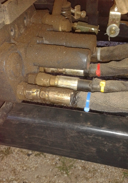

But still need to swap hoses. Blue and yellow are up/down... blue_yellow.jpg
simply (clean and then) swap them at the main junction box underneath?
Is this what your hoses look like on this block?
I ran out of daylight, will finish up tomorrow. Thanks for help everybody!
Boot bellows show joystick leaning: View attachment 501127
Piston out of adjustment (groove should be where locking bar can slide into the groove): View attachment 501128
But still need to swap hoses. Blue and yellow are up/down... View attachment 501129
I think you will also need to swap the two bucket hoses to keep bucket dump when joystick is moved outward, to right.
