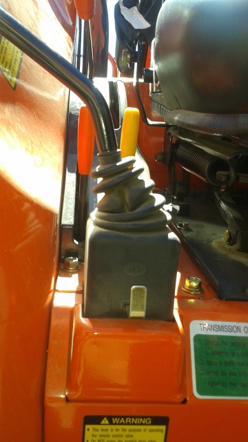

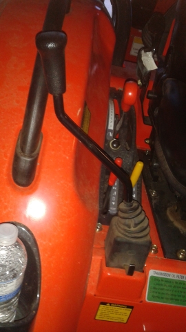

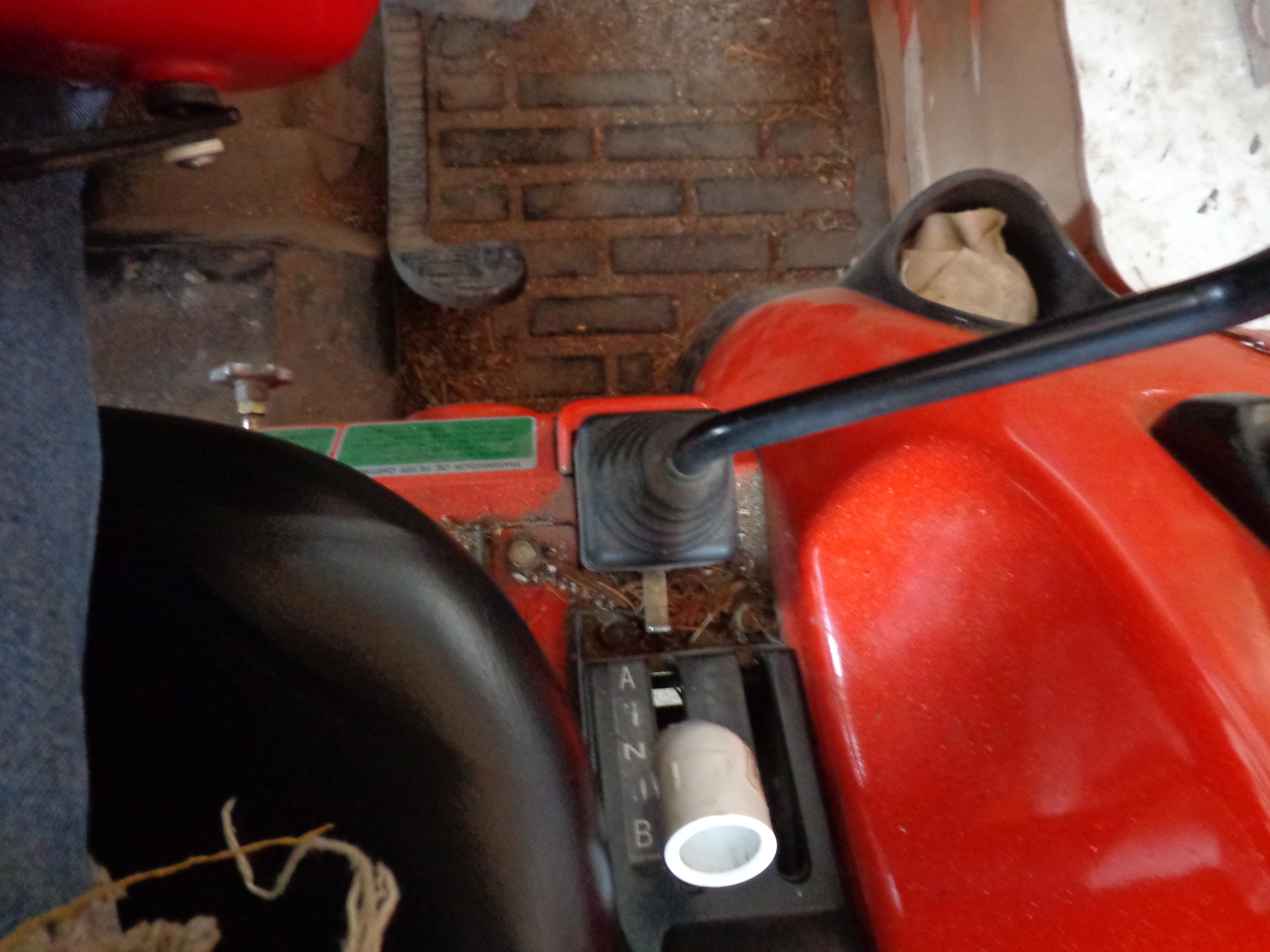

Three issues with my joystick, which I believe was installed "wrong" (it does work):
1) lock switch comes out the front, apparently should come out the back.
2) dogleg goes to right, simply not sure if this is correct or if it "should" go forward/back.
3) this is the biggie... detent for float is when I pull back (thus raising bucket) instead of forward (when dropping bucket).
Manuals are useless, other than being clear "float" should be forward past bucket down.
I figure 1) & 3) are probably related... turn control box around and "float" should be where it belongs and lock will be correct.
Anybody have an opinion on how the dogleg joystick lever should be positioned? Pics of yours?
Thanks

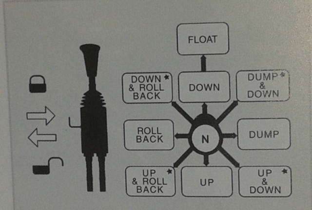

This is the way mine is looking at it sitting in the seat.
/ Kioti CK27 Joystick installed wrong... questions #12
The diagram is correct the joy stick is right just change the hoses .
the lock is fine where it is easier to get at.

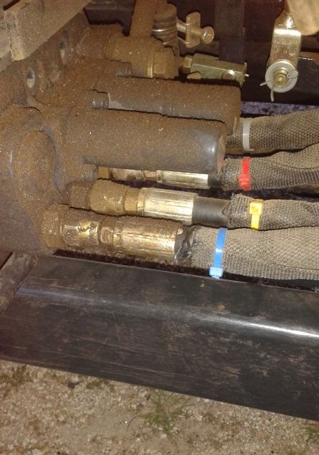

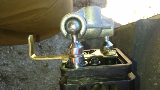

Update: Turned control box around, float is now in correct spot.
Here is why I'm working on this at all, one cable worked loose and the joystick was tilting further and further to the right.
Boot bellows show joystick leaning: boot.jpg
Piston out of adjustment (groove should be where locking bar can slide into the groove): plunger.jpg
Adjusted and reinstalled with lock lever pointing to rear. Float is now in correct place.
But still need to swap hoses. Blue and yellow are up/down... blue_yellow.jpg
simply (clean and then) swap them at the main junction box underneath?
Is this what your hoses look like on this block?
I ran out of daylight, will finish up tomorrow. Thanks for help everybody!

I think you will also need to swap the two bucket hoses to keep bucket dump when joystick is moved outward, to right.
