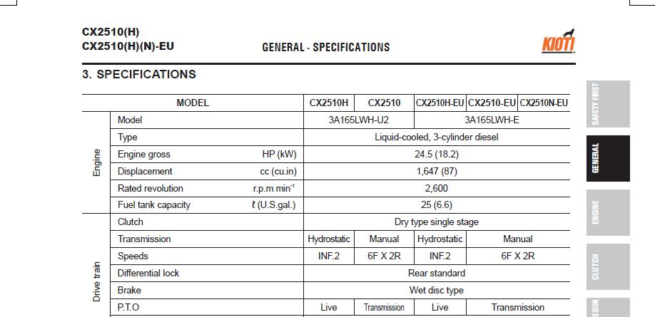

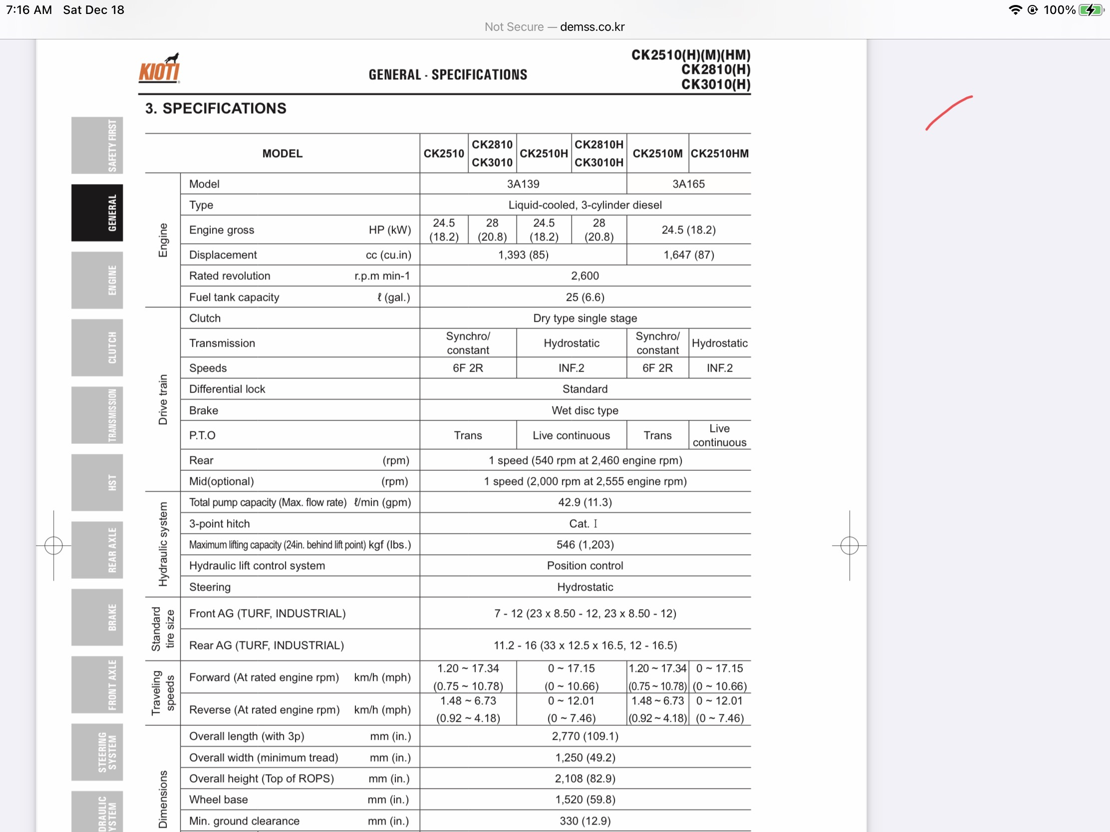

My thoughts as well...but I don't have the CX2510 to look at.
I have one. The tag on the engine sez it's the 1.6L Engine.
I don't know much about Kioti, at all, but evidently the CX2510 is a dressed-up version of the CK2510.
On the CK they changed engines in 2016. From a 1.4L to a 1.6L
You can see it here if you go to Model Year near the top of the page and click on it. You'll see the change.
Don't understand it but I learned a long time ago that I don't need to understand everything. I just accept a lot of things these days without question. Easier that way

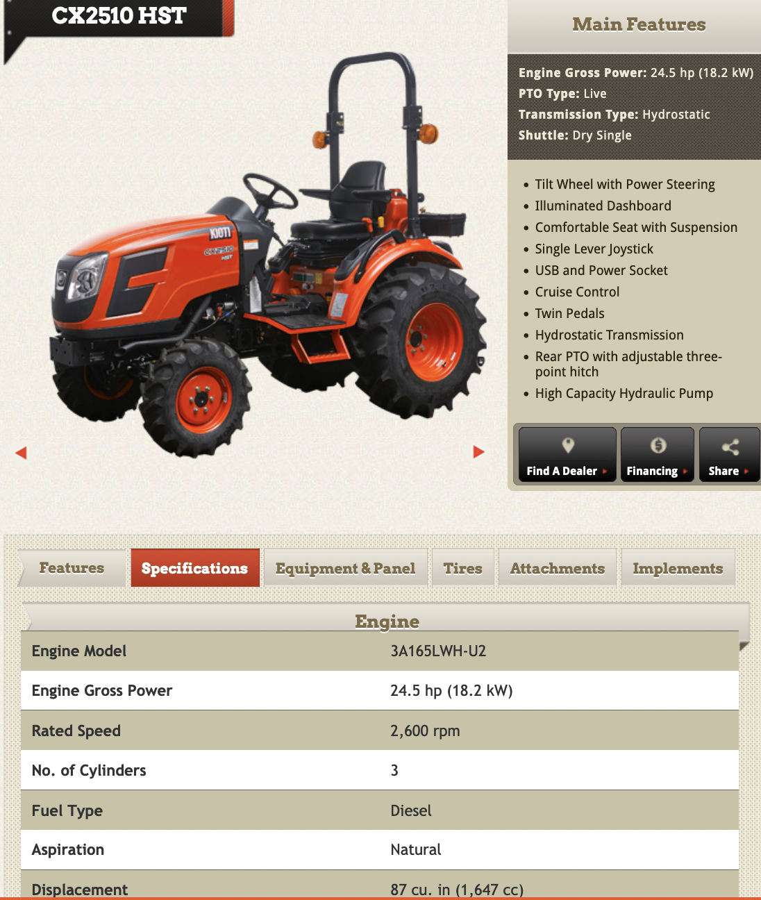

They need to remove the 87 in the manual and the specs sheets then...as that would be 100.5 CI's not 87.
As a scientist, I like to understand things.
Sometimes accepting things is easier, sometimes it is not. It depends on if the information is accurate or not, and what the cost will be when it isn't correct. Since 87 CI does not equal 100.5 CI's or 1.6L, if I owned the machine I would like to know which it is, especially when ordering filters or pouring in specific volumes of fluids (although the dip stick should always be checked).
All that said, I would imagine the label on the engine itself would be correct since that was most likely the original info...and everything after the design was copied or translated.

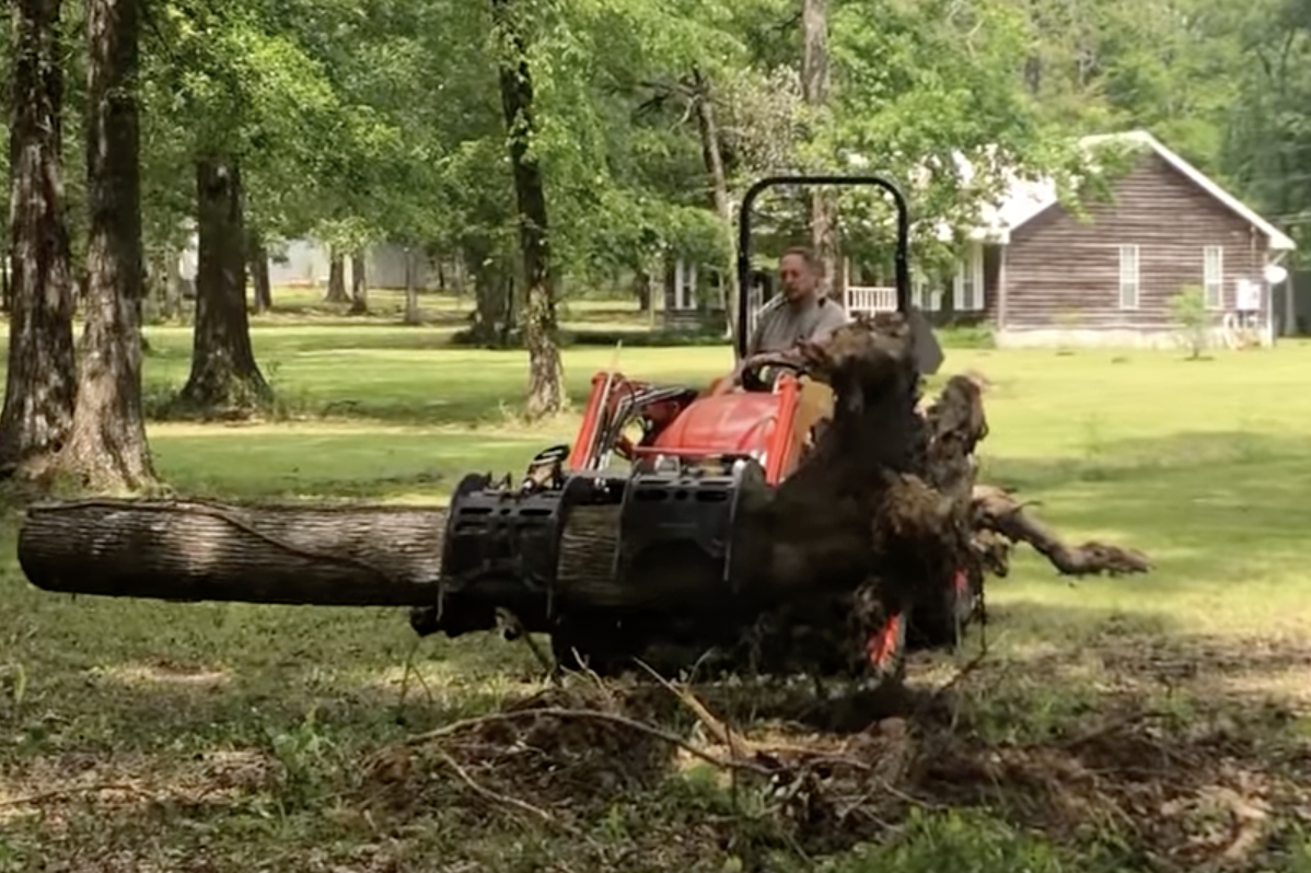

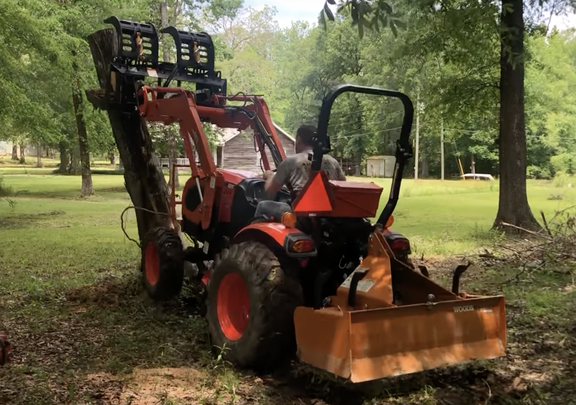

Go look at the numbers on Kioti's website. In any case, not my concern. I have a CK2610 HST with KL4030 loader...and am able to move a lot more with it than I was expecting, so I am very pleased.
At the 22:00 mark in the video at the bottom of this post...what more could one expect from a CK2610 HST?

I like the video. (y) I also do a lot of such grapple work on 33hp & 35hp NH CUTs with similar frame size and same tire sizes, but lesser hydraulics and FEL capacity.
I know other makers are catching up but IMO CK2610 set the bar pretty high for non-Tier machines when it came out.
