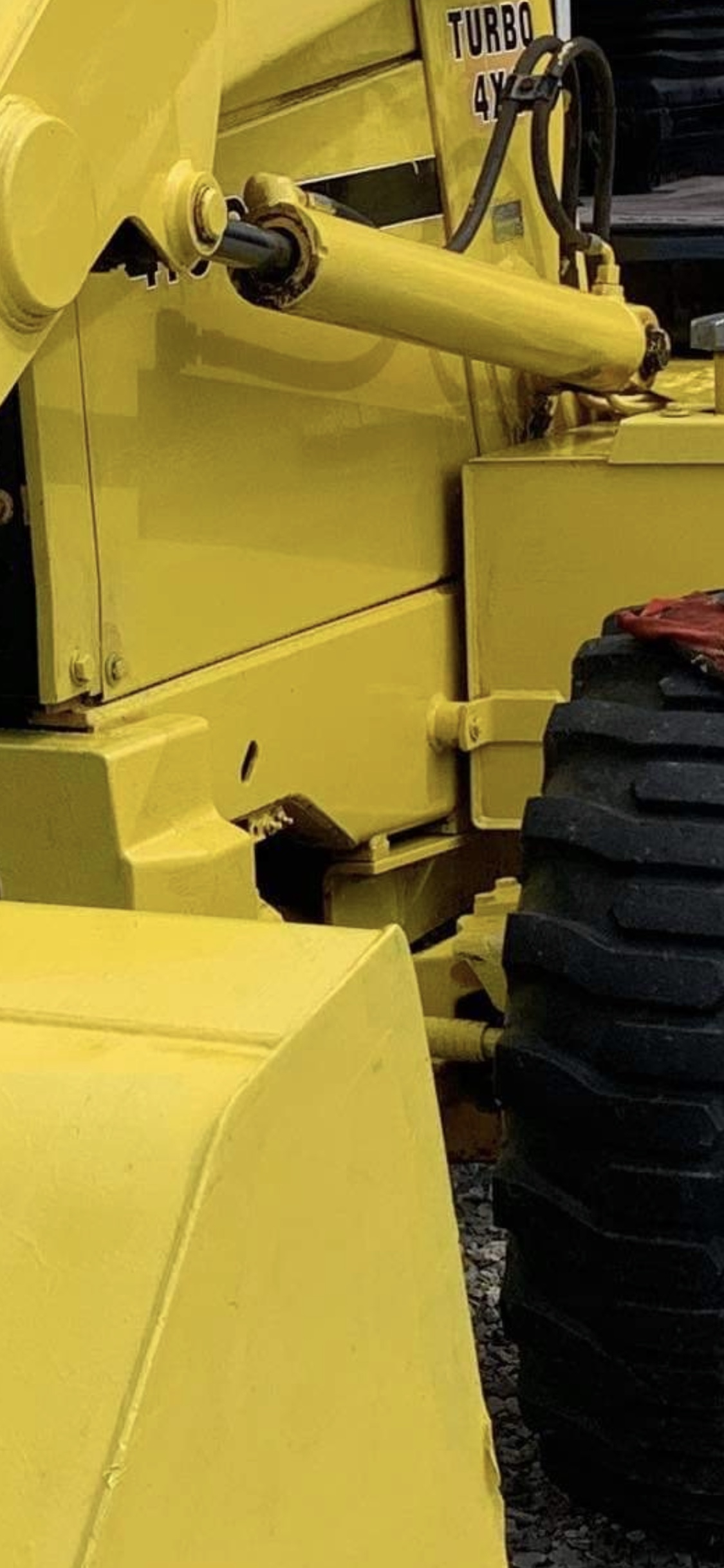

My backhoe that’s designed a bit more robust with a price tag to match has a frame that runs the entire length of the machine. That’s really how all tractors that are claimed backhoe/loader capable should be designed. View attachment 730007
Backhoes are as also a bad design, it does not do anything real good, it's a very bad excavator and a bad wheeloader baked in to one machine.
The picture is a better backhoe
