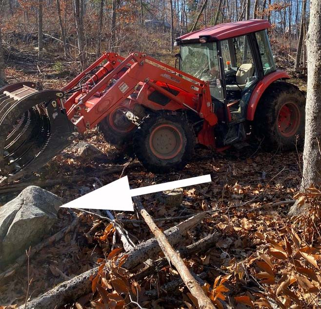

I was doing a little bit more digging on this tractor and found some comments from the owner.
One was that the tractor is a 2019 and the warranty was only 2 years, at least for the structural warranty as he said.
The other comments from him after someone pointed out that it may or may not been a case of abuse: "Not only every oil change but every week!! I owned a heavy equipment dealership for 27 years I paid guys like you. We use it in our boat yard, right application? Show me an owners manual that says you can plow grass but you can't push rocks?! Listen the reality is the machine should be designed so as not to be able to break itself apart because its lift capacity exceeds its structural integrity, keep in mind only 800 hours not 8000 hours of use."
I think it explains really well how this tractor has been treated. People see a loader on a tractor and expect it to behave like a skidsteer or a bulldozer, only to find out that it will eventually turn into an expensive expectation.

So am I seeing this right, it didn't actually "break in half" so much as the front axle just ripped off? Huge disaster but seems repairable, ultimately. A lot of grinding, welding, and new parts, for sure.
If you go bouncing off-road through the frozen woods carrying a giant boulder, well I guess that's about the worst abuse possible for a front end. Still pretty lame.

The cab step and fuel tank strap were not damaged as a result of the front falling off, my vote would be systemic abuse.

On another site, the tractor owner is selling this Kioti in "as present" condition. It's a 2019 model. Buyer must retrieve the tractor from field. He also indicates he is both a Boat Marina owner, and heavy equipment dealer, marketing skid steers and construction equipment, and this accident occurred early November 2021 or about three months ago. He is located in Maine.
From his actions to sell the tractor in the current condition, it probably means Kioti has already reviewed the situation, and denied any warranty work on this tractor. So this additional information is leading me to thinking possible abuse. I understand that many tractor manufacturers sometimes deny warranty repairs if abuse or neglect is suspected to have contributed to said damage.
