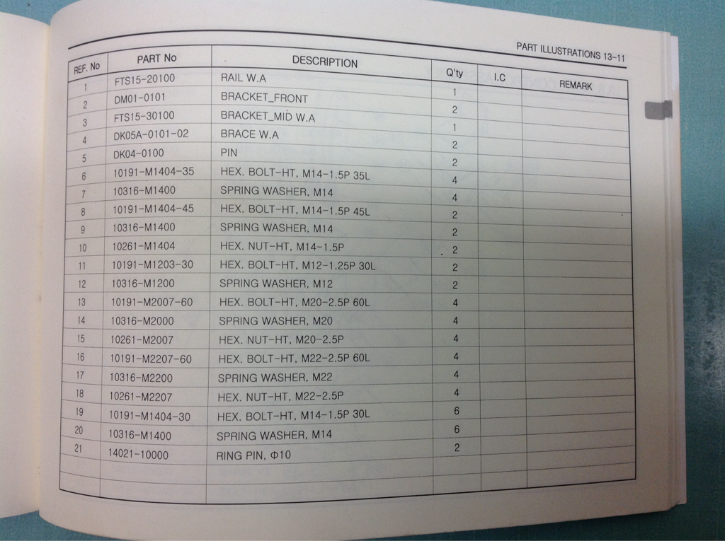

/ Kioti backhoe subframe and mounts #2
Parts diagram is here:
Backhoe Parts Diagram
Look like it's fairly reasonably priced at roughly 1200. Can't make it yourself for less than that.

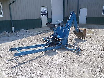

In reality part #3 might be compatible with the Ford hoe with some slight modifications.
The front attachment point will require some additional work as I think part number 1 goes in the same spot as the rear subframe mount for the front mount blower, but I think it can be overcome with a little extra fab work.

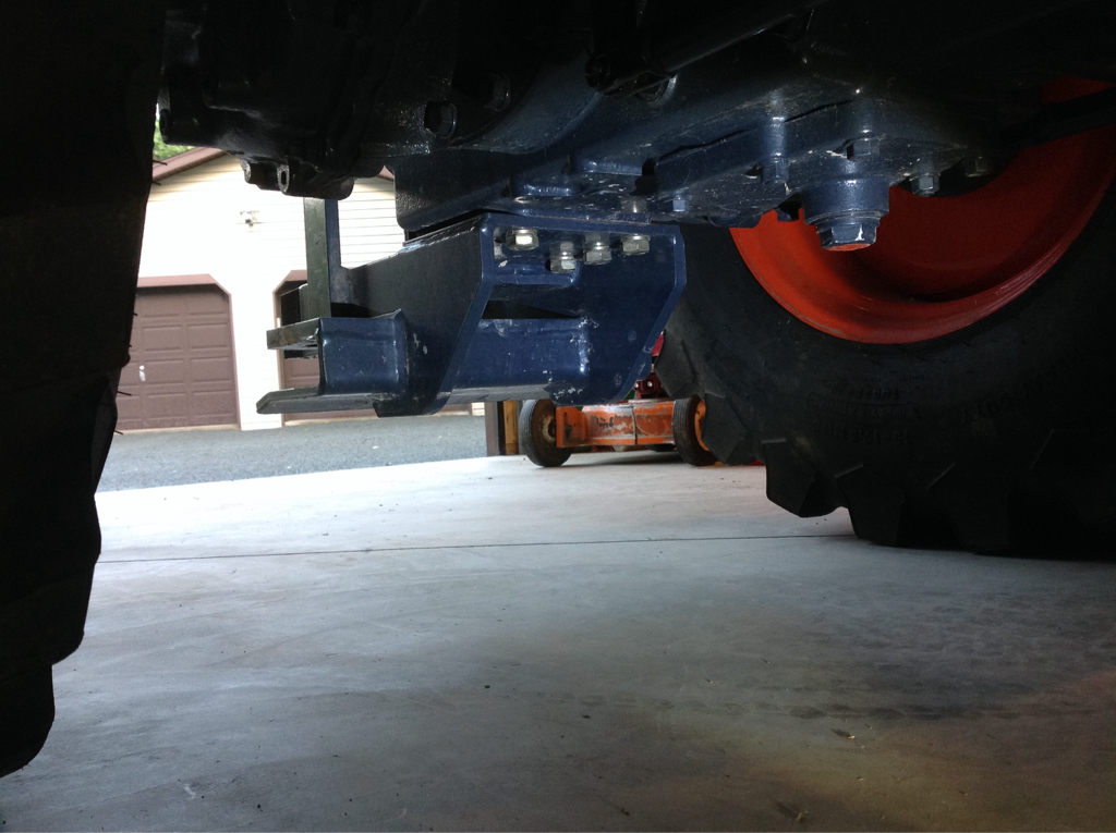

As I recall there are a couple of anchor points that get attached to the frame forward that the subframe hooks into and then another slot under the PTO shaft. I had a Kioti BH on my former tractor but don't recall ever taking detailed photos but I'll double check.
/ Kioti backhoe subframe and mounts #8

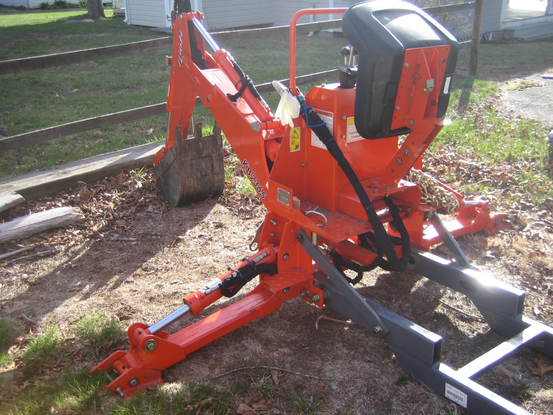

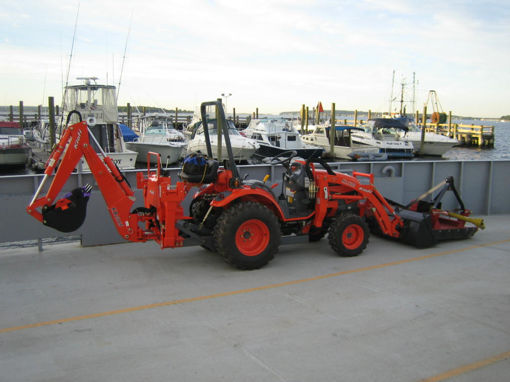

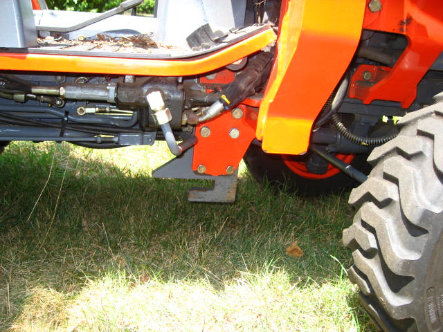

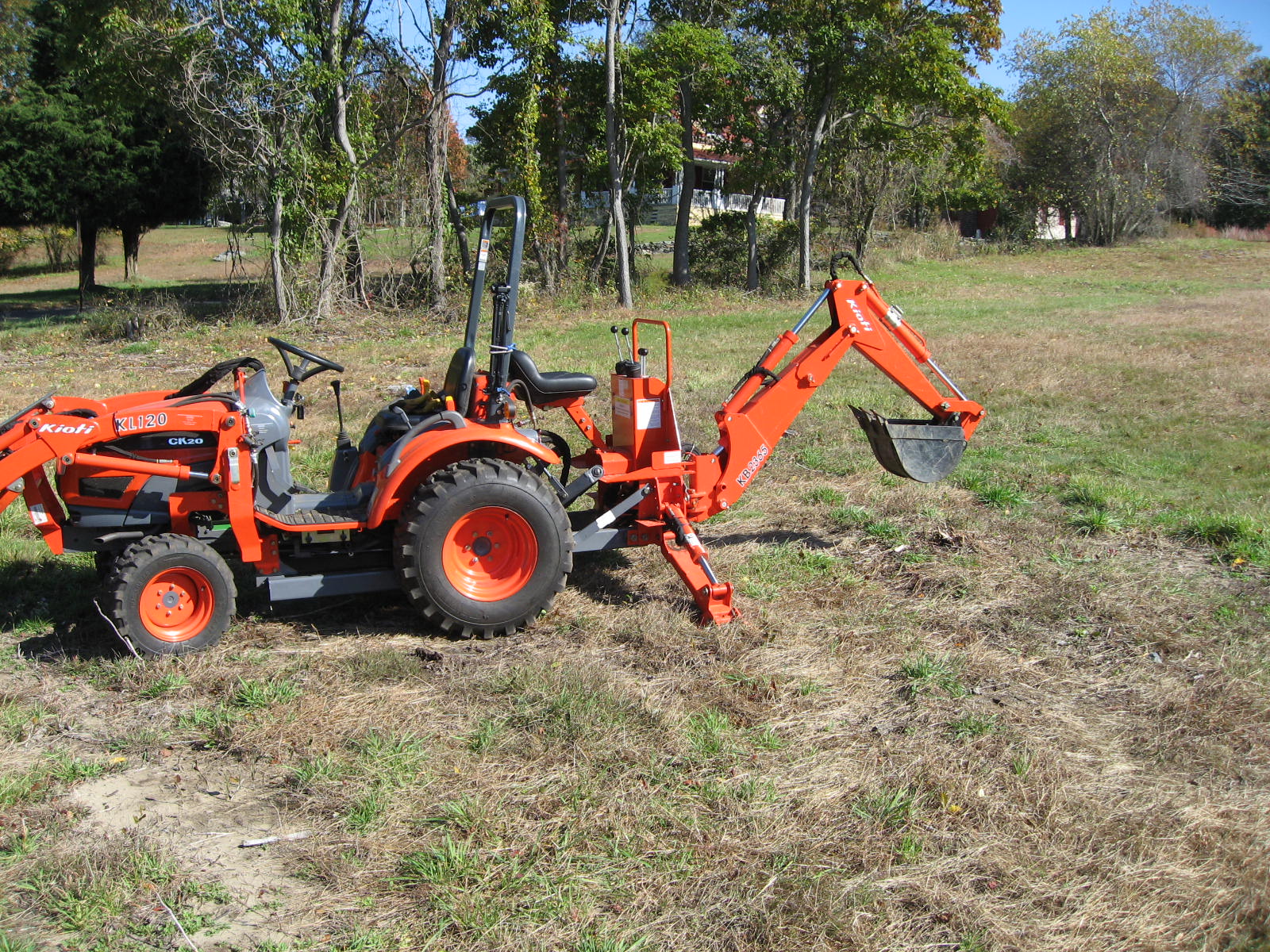

These are all the photos I can come up with. Might be helpful but I don't have any measurements to go with them. Note the hooks on the tractor frame up at the front of where the subframe attaches. No lock there just slide the tube over the hooks. The subframe is secured by two pins that drop down in the rear portion of the subframe receiver under the PTO. I think both those areas are shown in a few of the photos if you zoom in.

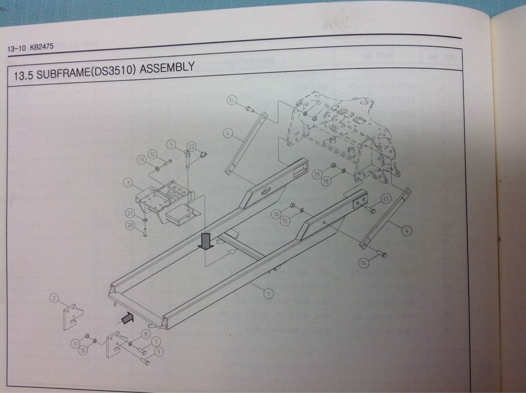

I have a KB2475 hoe on a CK35. The manual only showers a DK and a DS subframe. The DS diagram looks like what came with my tractor. Cannot get pics right now.
/ Kioti backhoe subframe and mounts #12
The DS diagram looks like what came with my tractor. View attachment 520685
Interesting. I have never seen the factory manual on the 2475. Your 1st photo shows the toplink
mount on the hoe. Do later pages tell you to use the toplink, or not?
Using the toplink connection or not, was/is an issue, but I think it should be used, based on
photos and a video of fatigue damage on well-used units. This is an old-fashioned design; I
much prefer a "4-point" style of subframe, even if you have to go custom.

This is great - thank you! Can you tell me how part #3 (the rear bracket) mounts to the hitch? I can't see how that attaches at all.
/ Kioti backhoe subframe and mounts #14
I'm not a expert on these but as for your comment re: top link: if you're talking about part #4 from the second image, I believe that's just a cross bar from the subframe to the hoe; not a top link. There is one on each side.

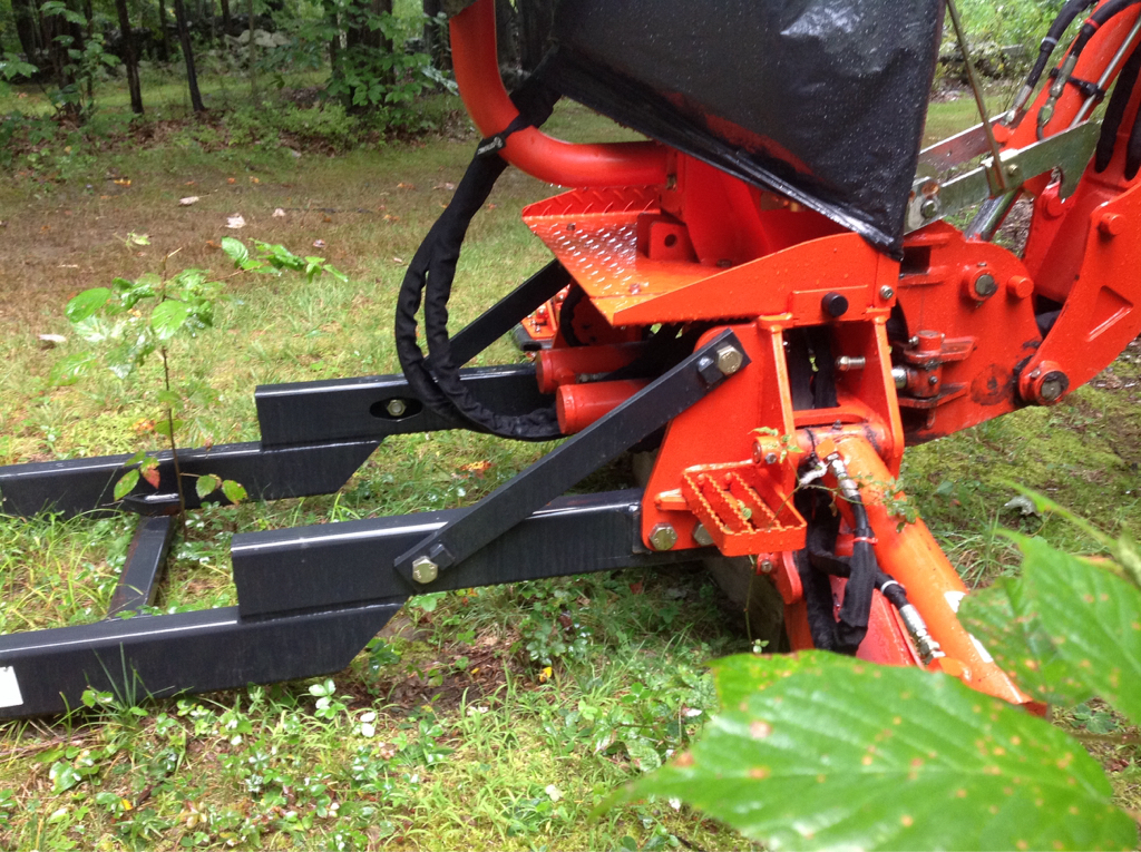

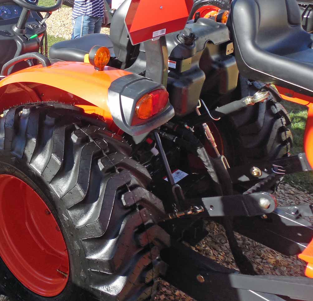

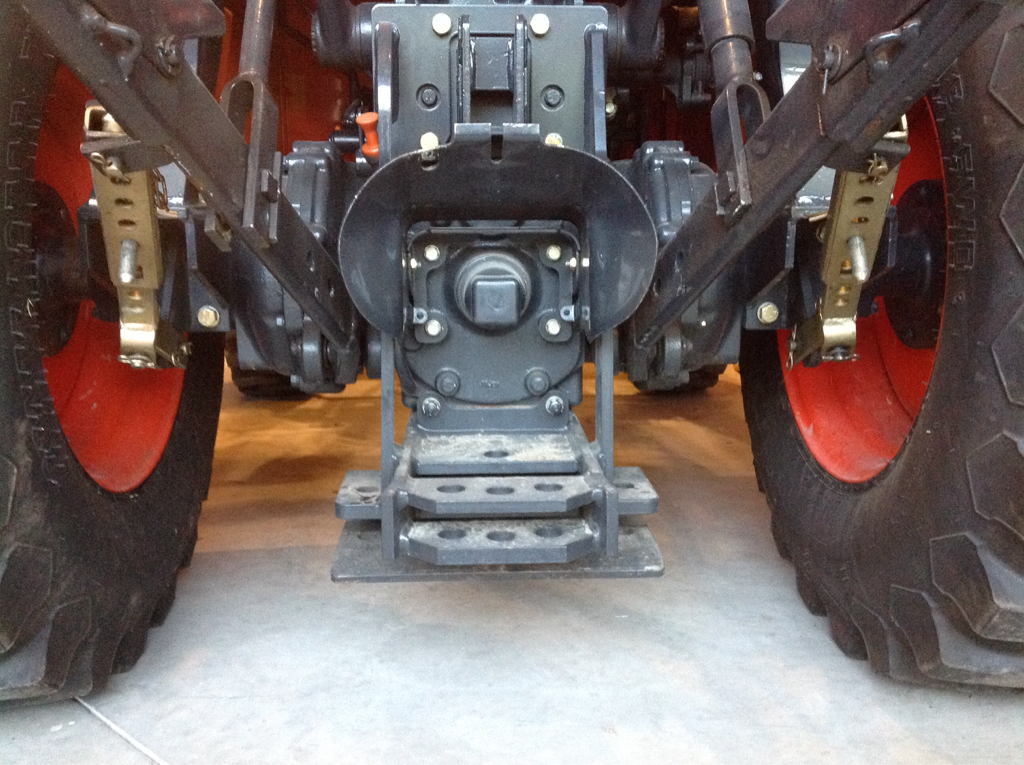

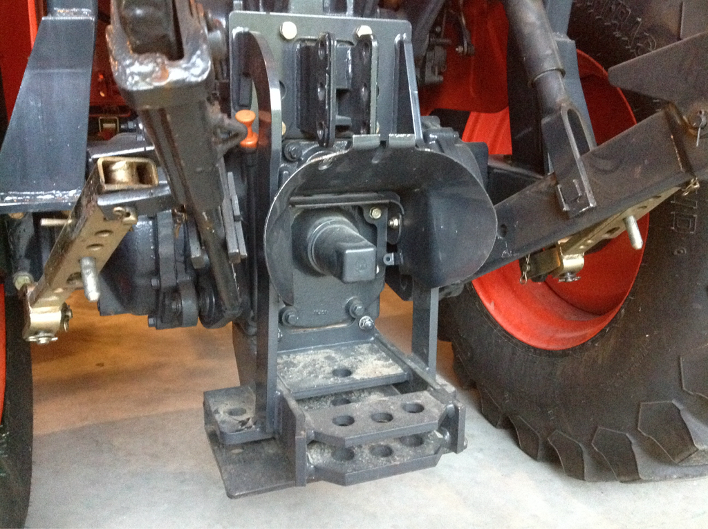

The manual does not tell you to hook up a top link. Actually the seat support and center platform is in the way. They are both removable, I'm guessing that whoever makes the hoe also makes a 3 pt hoe and this is a shared part.
Here are some pics of the rear mount 2012 CK35. Different from the parts diagram of the DS35, the rear mount has two legs and an arch going over the pto.
Yeah this is definitely different than what the diagram shows. Are both versions bolted to the hitch or are they welded?
/ Kioti backhoe subframe and mounts #19
Not sure what you mean by hitch. The diagram and pics show 6 bolts at the bottom of the tractor and 2 bolts below the pto. The unit on my tractor shows this and also, 2 legs going above the pto secured with 4 bolts about the top link mount. Nothing is welded to the tractor.
