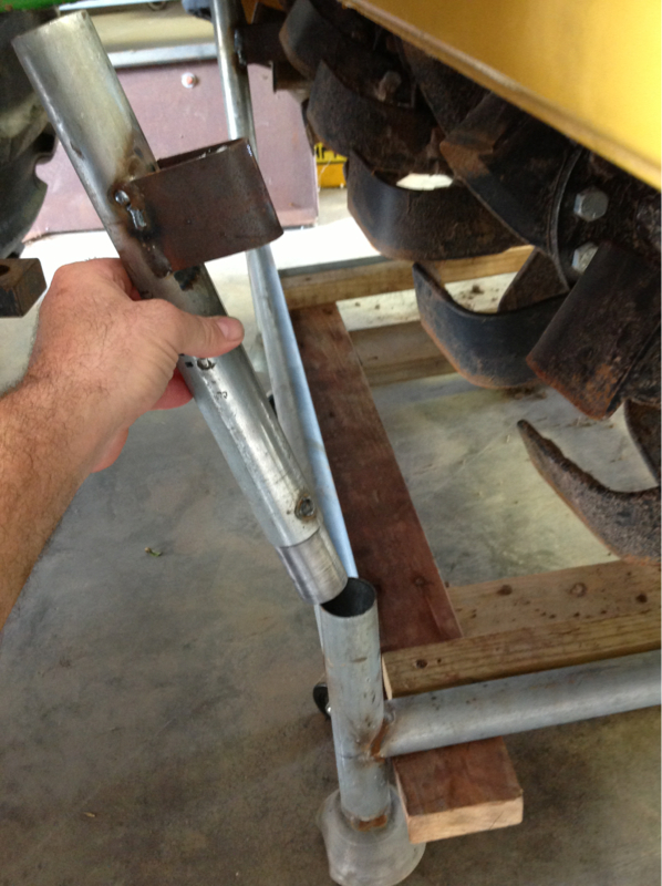

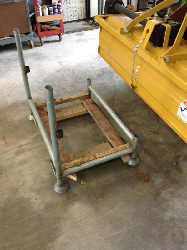

Did you get the shipping frame? It it a tubular frame allowing stacking on the truck. If you add wheels and make the front verticals into pins it makes a handy roll around storage rack. Photos show before the wheels were weld on.
