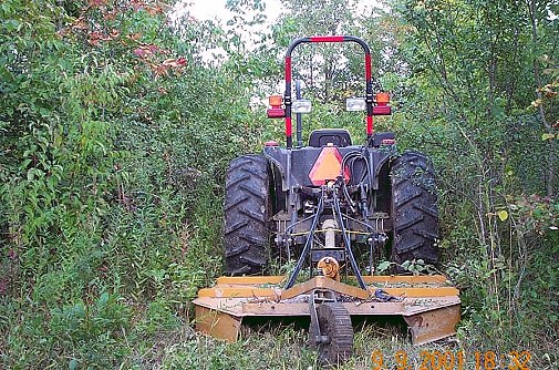

<font color="blue">… sounds like you like your kingkutter,is that what you had on in all those tutorial pictures?...</font>
Yes… that was me… I’m guilty of abusing that poor girl… Different times, I’d forget and thought she was a tree cutter… and really & truly cut some 4-5” stuff… slowly but she cut it… all with that 40 hp gearbox! (Don’t do this at home! /forums/images/graemlins/wink.gif)
If the KingKutter could survive me and the torture I dished out… it should last you indefinitely… /forums/images/graemlins/grin.gif

Am I seeing you running this KK without chainguards? I would imagine you recommend those, don't you? Also, for something like this KK, could you share the pro's and con's of shear pins vs. a slip clutch? Lastly, is the slip clutch on something like this in the gearbox itself or is it incorporated into a different PTO shaft? Thanks for your help with this.

The brush/saplings I am cutting would go through shear bolts like no tomorrow... Yes, the slip-clutch is mandatory with serious cutting... (on the 40 HP OMNI gearbox KK and many other's use, it's a smooth input shaft, so I used a Eurocardan slip-clutch with a Grade 8 bolt holding the slip-clutch on the shaft)
I cut mostly my property, very very very rural... no residences within 300 ft... in fact nothing within ~ 1/2 mile? But, this year I am putting some front chains on... for ME!
The KingKutter got a hold of the stuff and threw it... but the Brown rotary cutter is even nastier (7' blade tip speed is ~ 202 mph...) /forums/images/graemlins/shocked.gif
