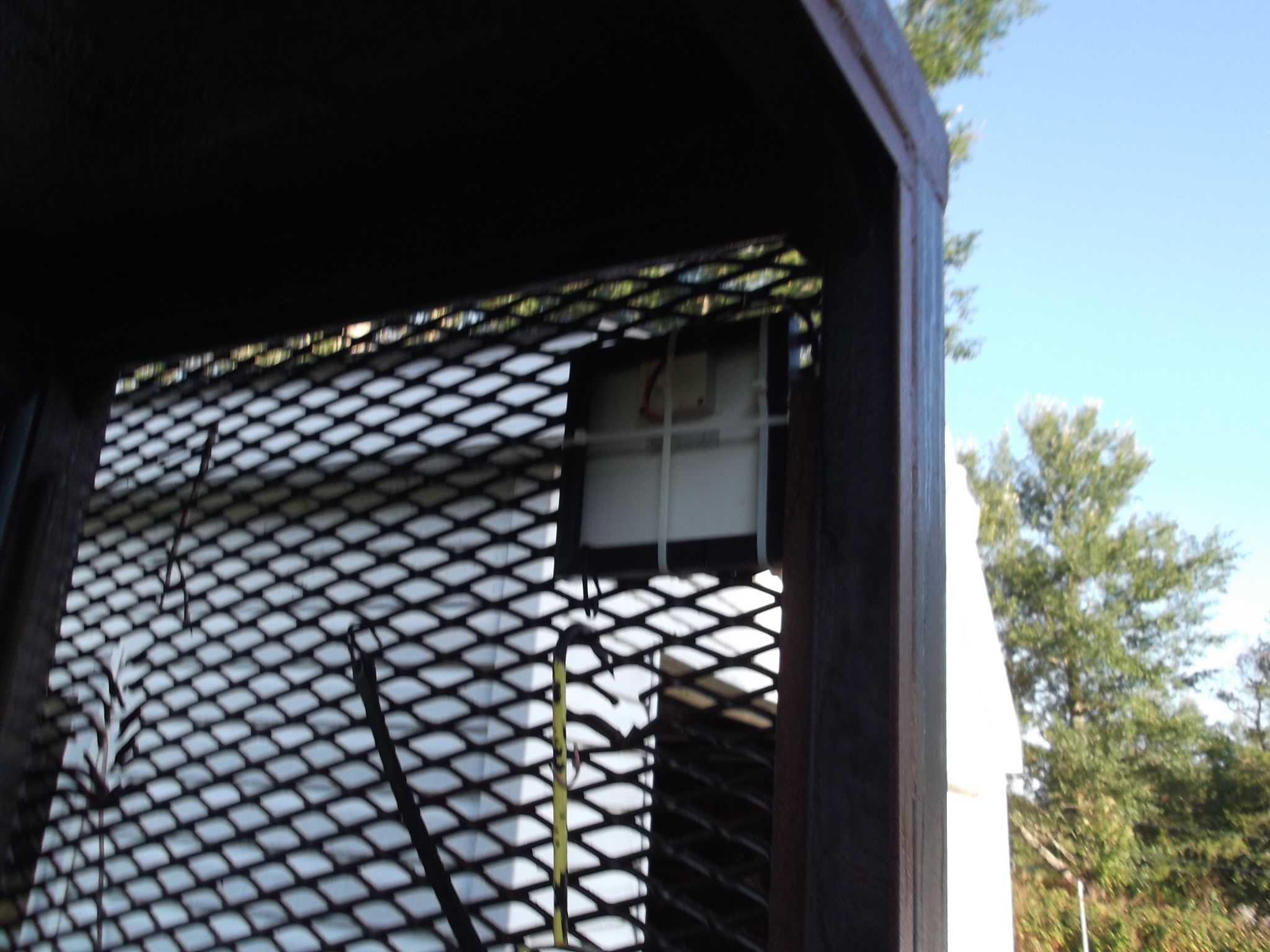

My Case 450 crawler often sits for 3 to 4 months at a time at my woodlot. It's an old tractor and has no modern parasitic drains (as long as I remember to turn the switch off ). I used to have a terrible time with the battery; it would last 2 or 3 years. It's a big one and it's not cheap. On May 3, 2004 I replaced the battery yet again, but that fall I installed Power Pulse desulfator by Pulse Tech Corporation. A couple of years later I connected a 5 watt solar panel. Now, after more than 8 years the battery remains fully charged. The desulfator wasn't cheap either : $125, and the solar panel I got on sale at Princess Auto for $30 (IIRC), but they have now paid for themselves several times over.
The first photo shows the Pulse Tech unit in the battery box (the white wire leads to the solar panel). The other pics show the solar panel mounted on the ROPS screen.View attachment 281237View attachment 281238View attachment 281239.
