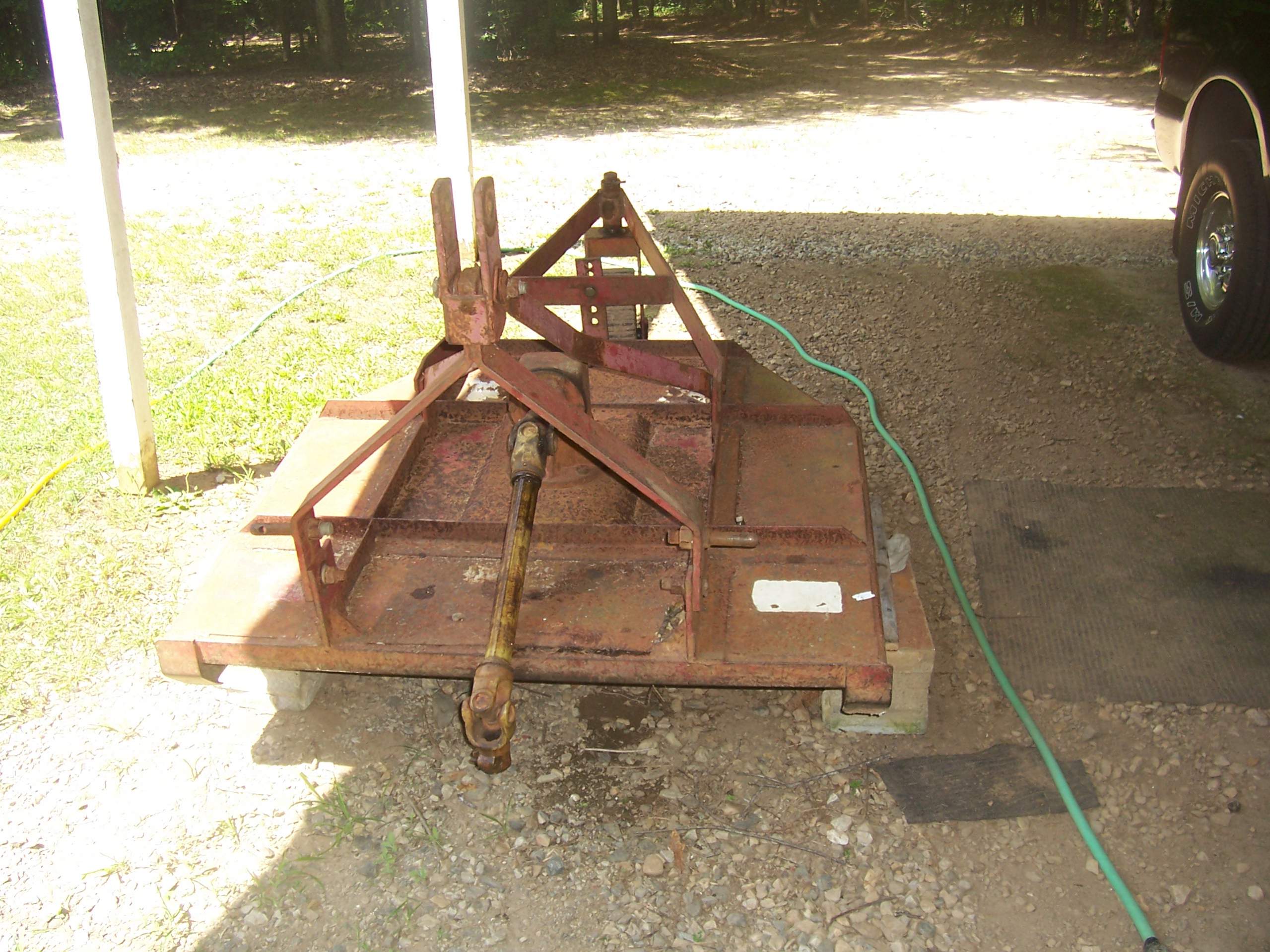

Welcome. I run a 5Ft. FM. @ 611 Lbs. and a 4Ft. BH. heavy duty on a Ym2000 same as the 240. My BH. is a old International built like a Tank! I'm sure it will handle larger implements but I don't like to have to run my equipment at full power or even close to it. I've never had to run the FM. over 2100 rpm's @ 540 1st. gear pto. but I have my 2nd. gear working now so I never get over 1600 rpms.:). I don't have a FEL. on it so I had to add front ballast also. To be honest I can't recall ever having to run the YM2000 over 2200 rpms. IMO. run like your going to since it's newly rebuilt and if it has a problem you want it to show up. The Fred. referbished 2500 did but it was easily corrected for me. If not your be able to get it corrected under warranty.

>>> I've never had to run the FM. over 2100 rpm's @ 540 1st. gear pto. but I have my 2nd. gear working now so I never get over 1600 rpms.<<<
Thanks for the info, Carey. The guy at Fredricks didn't know what RPM I needed to run the tractor to get 540 pto speed; I was planning to ask you guys. So is 2100 the minimum to run the tractor and get 540 with the first pto gear? I asked him about reducing the RPM of the tractor and using the 2nd pto gear, but he wasn't sure that would work and said he didn't know how to figure the math if it would. It doesn't seem that complicated to me if you know the speeds, but I thought I'd wait until I actually had the tractor before asking the questions here.
So are you saying that running the tractor at 1600 rpm and keep the pto in the 2nd gear will give me 540? That would sure be an advantage if it will do that. I hate having to run my JD so hard to get the needed pto speed. They have an econo setting on the newer models but mine doesn't have it.
