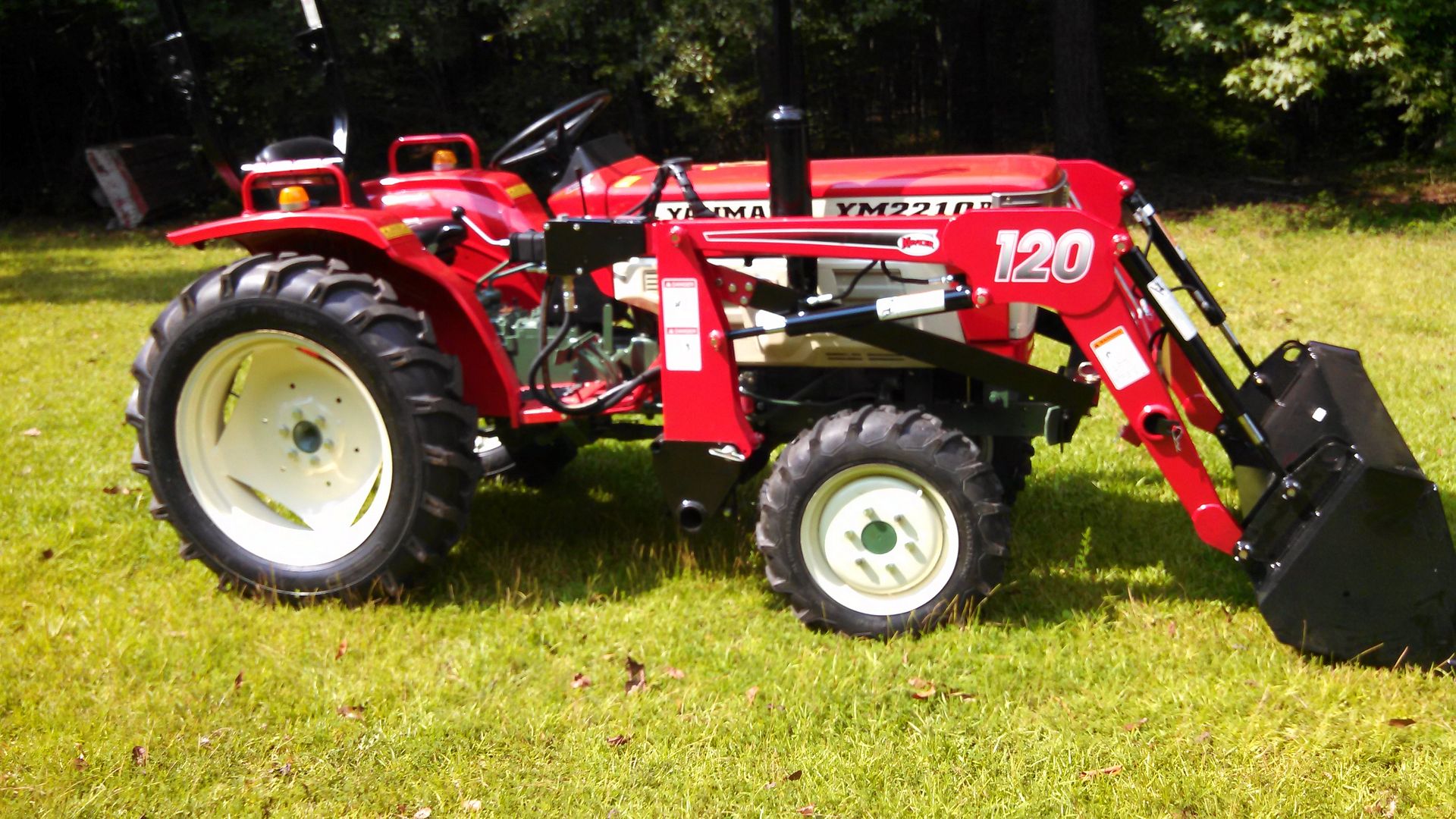

I got the tractor in today and here is a pic as promised:
I guess it looks like all the rest of them. Only thing I noticed wrong was they put 2210B stickers on it when it is actually a 2210BD. In case someone is wondering, the B was a mid-year change that had a different side panel with more ventilation and instrument gauges instead of lights. The D of course indicates 4wd. I figure they didn't have any BD stickers and just used the B. Its probably meaningless, unless after I'm dead and gone it gets sold and somebody tells my estate that a B is worth less than a D, which would be correct.
It would arrive on one of my busiest days of the year and I did not have any time to work with it until about sunset. I decided to hook up my 6' scrape blade and was hoping to make a test run with it. I backed up to the blade, expecting this to be a 2 minute job, and 30 minutes later was still fighting with it. The blade is a standard type 1 implement and has 26" of space between where the lift arms should be. The lift arms will extend out to 26" without a problem, but the length of the pins require it to spread at least 32" to hook it up. Its like the little lift arms don't have enough of a bend made into them and they just won't go out that far. I've looked everywhere to see what is the standard length for a Type 1 lift arm, but can't find it anywhere. Apparently, there isn't one and everyone does their own thing. The Yanmar arms are only 31" long and that seems to be shorter than most.
I finally took one side completely loose from the upper stabilizer and got the lift arms on, then managed to wrestle the upper stablizer back into place. If it had been a heavy implement I never would have gotten it on. I dunno if there is a flaw in the way the lift arms are made or something else is wrong. Maybe they need to be used some and they will loosen up. Maybe I will take a torch to them and bend them enough so they will open up. I do have a set of JD arms that I will put on before I fight with it like this every time I change equipment. Anyone else have a problem like this on one of these "new" tractors?
The tractor sure runs good and I hope to find a little time to work with it tomorrow and see how it handles that blade. I know I won't get to buy any implements or do any real work with it; maybe I can Thursday.

I knew it would be a nice tractor because of where it came from... I haven't had any problems connecting up any of my implements .. Of course I only have a middle buster, box blade and the andy 500 cutter. I believe you'll get good service from that tractor.. If you are going to do any diggin with the loader.. I highly recommend the tooth bar on the bucket.. I have also added a grapple to my bucket

Don't know about the blade but the ad for the 2210d the lift arms are mounted inside of the frame on that rotary cutter??
maybe that's a full 26 inch?
My FIL has a 2310d and has a few attachments for the 3 point, (snow blower, finish mower, 7 foot blade and brush cutter) have never heard him complain about not being able to get the lift arms wide enough for the pins?.? he has been very happy with his Yanmar.
He did give me a 6 foot disc harrow that the 2310d had trouble lifting and was a bit much for it to pull though..
I would ask Fredricks if they have the fix- no reason a tractor should not accept standard cat one implements.
Nice looking tractor, and nothing but good things to say about Koyker loaders to .
I'm sure you will have it dialed in in no time:thumbsup:

Thanks for the comments; I suspect its something very simple and I will figure it out soon. Would somebody measure your lift arms and see if they are 31" like mine? Seems unlikely they could have put type 0 arms on it, but if everyone else has 31" arms I'll know for sure that isn't the issue. Its possible these aren't bent properly, but that doesn't seem all that likely either. Maybe they just have to loosen up a little.
