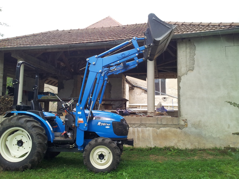

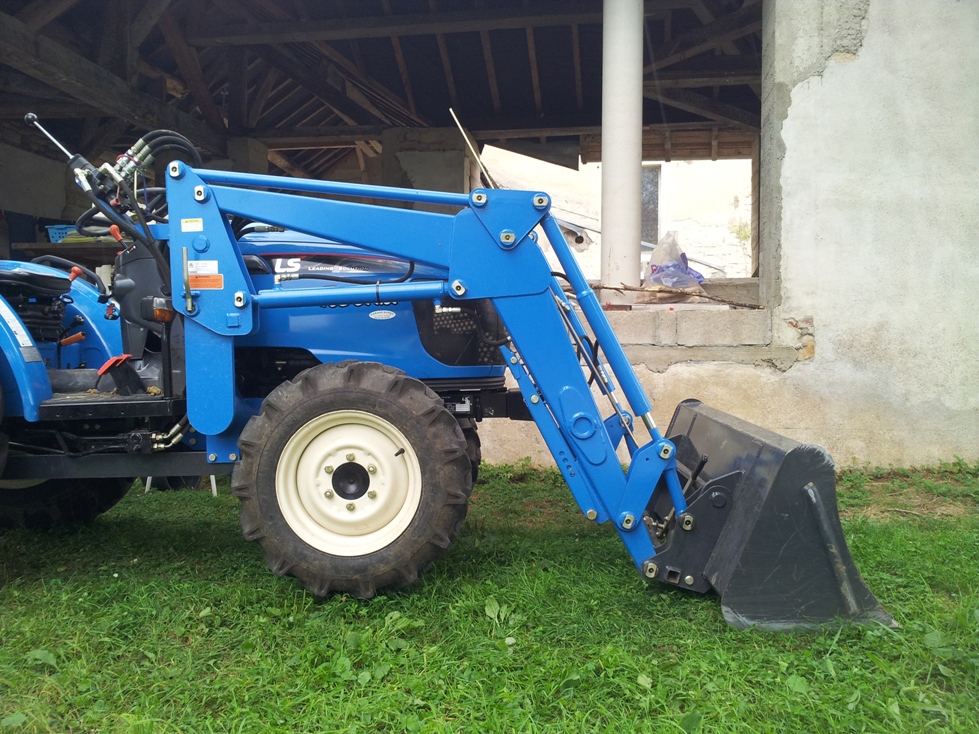

I've noticed that the self-leveling loader (mechanical) on the R36 doesn't realy stay level at all.
I believe the triangular liason is poorly designed and will proably end up making a new one.
Question is, is this a design flaw on this perculiar loader or do they all behave the same ?
Down (front wheels are slightly off the ground because the ground isn't flat, on flat ground it's just perfect)
Up, definetly no longer level....

Looks about right to me. I don't see a problem.
The self leveling loaders I have used roll ahead at full height just enough to keep the load from spilling over the back of the bucket onto the operator and machine.

I dont know if it is how they all are, but IMO, a self leveling loader should be just that....self leveling. Apparently NOT what you have there. My ford 5500 TLB is the same way. It is "supposed" to be self leveling, but is not.
I believe what you need to do to correct is make it so the pins are ALL evenly spaced ALL four ways. (The 4 pins I circled.)
If you measure the loader arm itself from rear pin to the pin the triangle pivots on......The self leveling arm needs to be the SAME length, And the distance between the two rear pins (loader arm and leveling arm) needs to be the same as the front two.
It looks like it may require shortening the leveling arm.
If the leveling arm is indeed too long, I "think" you could compensate by making the distance between the front pins a tad less than the rears, but that would require playing with some numbers and measurments. But you also have to watch out for curl cylinder clearence. It looks tight there also.

To be truly "self-leveling, the linkage would have to form a parallelogram.
It doesn't now. See the red lines below.

Cool, I hadnt thought to do that. Looking at that view though, it does look like the horizontals are the same lenght. (or at least pretty close. But taht front top pin needs lowered for sure.

As it is right now if you had your bucket level flat on the ground. Drove into a pile of material. Rolled bucket back and lifted to full height you would have a full bucket and no spill back on you nor would you have to feather to roll back to prevent spill back.
That is what the self leveling is supposed to do and it appears yours will do it.
You can also push into a pile with it level and lift without rolling back and while you won't get a full bucket you would not spill any out front or back, again, what it is supposed to do.

On self leveling loaders, the bucket rolls down slightly as the loader is being raised to help prevent the load from spilling over the back of the bucket at full height.
The loader in the picture looks like it is working as it should to me.
I sure wouldn't want a bucket that went level as soon as it was lifted and stayed there. All the material would be falling out of the bucket, making it useless as a loader.

With a parallelogram linkage, it would'nt really be self-"leveling," but maintain whatever angle you want as they are raised. It would still have the curl cylinders as part of the linkage. If you scoop, curl bucket to 45 degrees, then lift, the bucket stays at 45 degrees during the lift to full height. It doesn't tilt back and dump the load on your hood like a non-self-leveling could.
Most "self leveling" loaders have a modified linkage like this one, so the bucket does not tilt as much as it is raised, but does tilt some.

SG - If you are seeking more self-levelling, you may want to reposition the triangles by rotating it clockwise by one pin so that the long side of the triangles are connected to the curl cylinder base and the boom. That way the rod will push out, and therefore down on the curl cylinder base.
