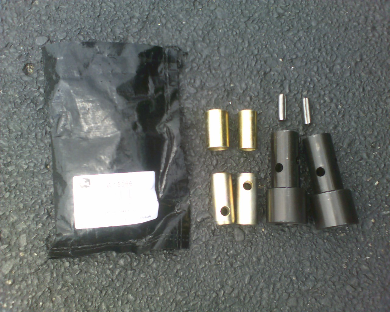

How's that working out? My biggest headache is my DR chipper but I think I'll need to fabricate an inverse iMatch bracket for it.
I'm making it happen, it just takes a little time and money. I have purchased some of the JD iMatch Bushing Kits (see attached), which makes things easier. The JD part number is BW15056 and they are around $30. These are the same kits they use on the iMatch Ballast Box.
You bring up a good point about the inverse iMatch bracket. I have been expecting to see something along these lines. I think there is a market out there for this. Perhaps one of the specialty fabricators out there will come up with something novel like a rigid iMatch compatible A-frame with adjustable links on the implement side to make up the difference.
