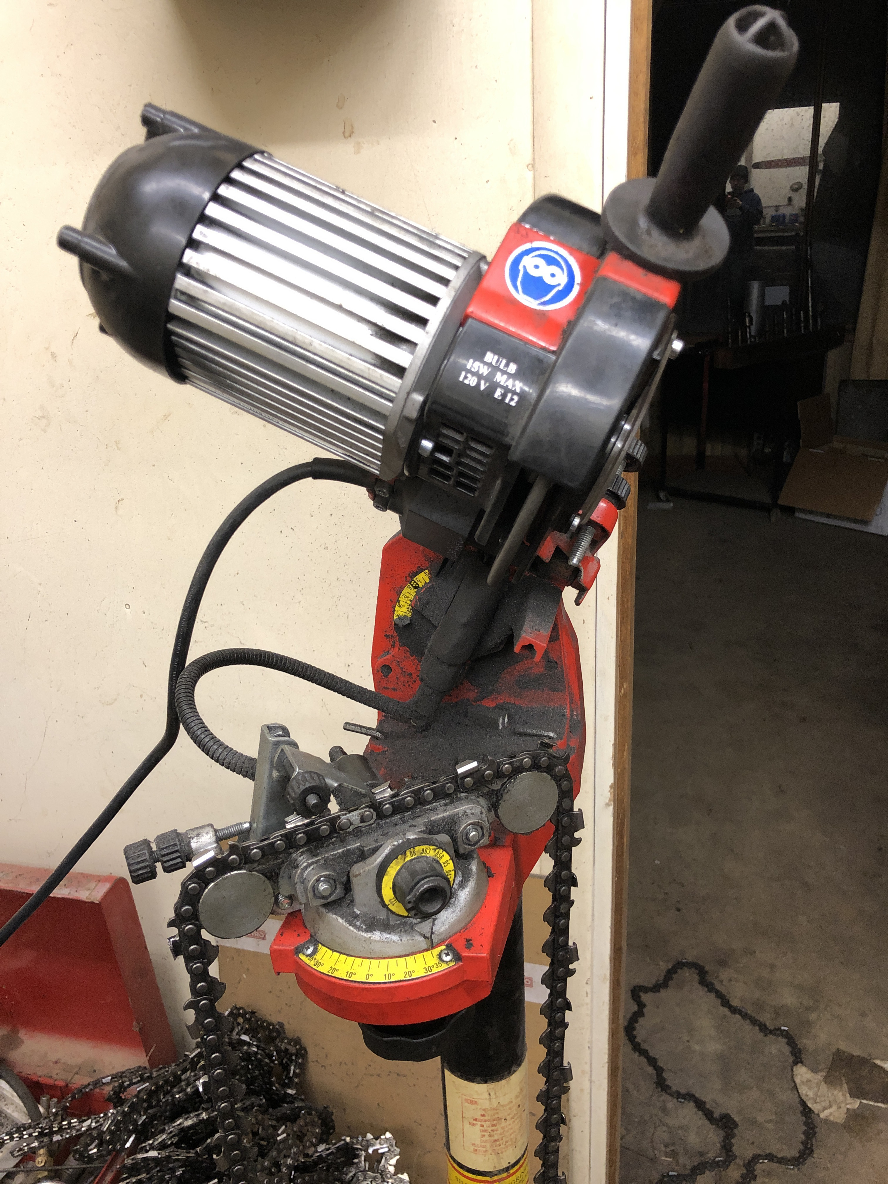

I have read what the "experts" say about the HF unit and you guys must be spewing BS if you think it works.....LOL. You need at least a $500 grinder to do it right. BTW, I am planning to get one too....but I don't plan on wearing a face mask for Thanksgiving either.
I’ve got like a $200 Oregon grinder and I can replicate the factory job the first sharpening. The results get worse as the chain wears more but that happens with anything.
/ just got my chain back from being sharpened..... #42
My buddy gav me a cheapie grinder. Very underpowered, but it actually did a good job at first. Then for whatever reason, results got lousy.
Then I got like a HF unit on sale (Princess Auto). My small engine repair guy walked me thorugh it and I had him evaluate it. He said he would get one of these before he spent the money again on his Oregon unit.

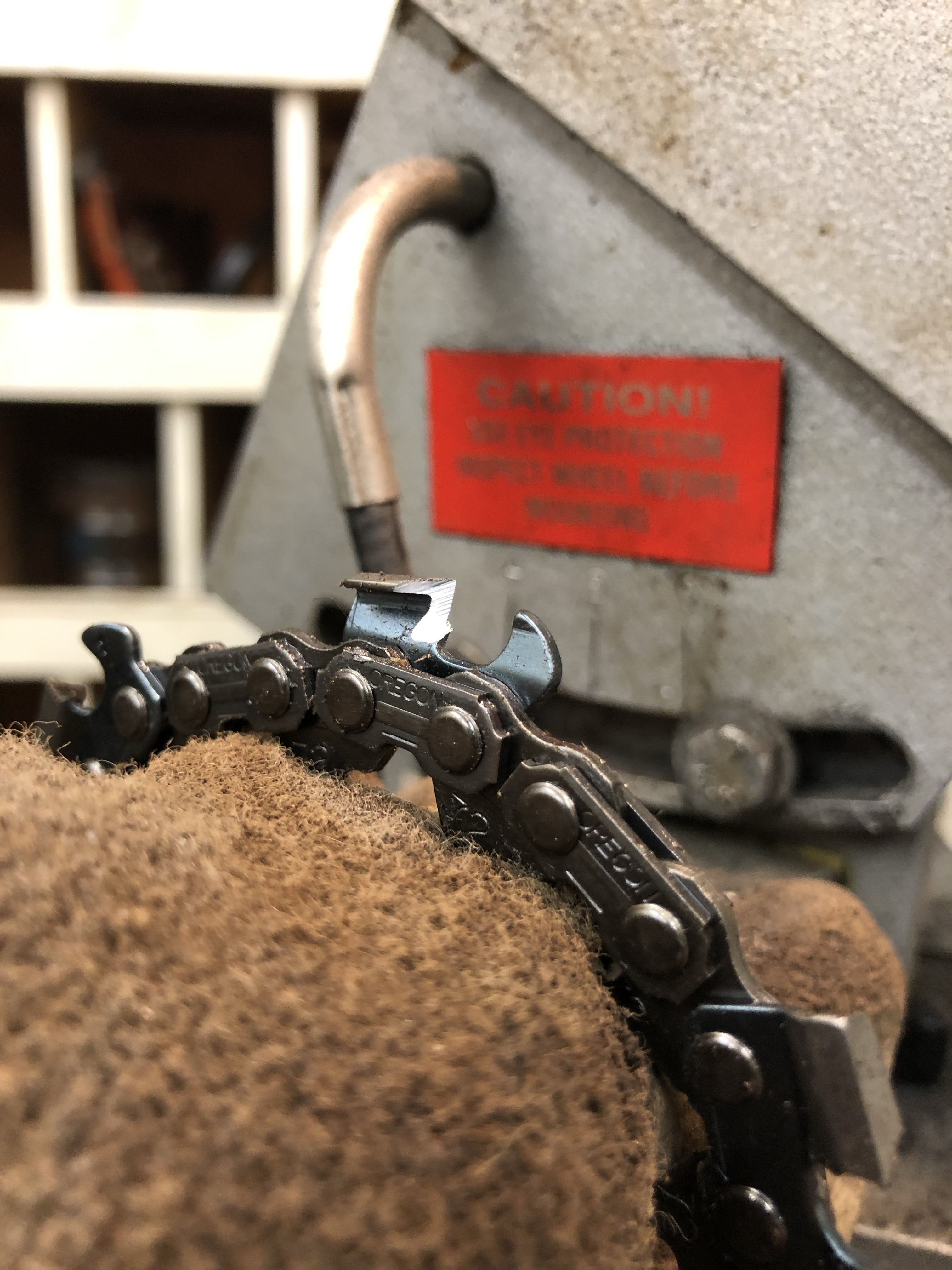

Saw racers often grind their race chains so there's just the tiniest bit of tooth left. If that makes the fastest cutting chain then they must be doing something that you are not doing on your worn chains.
Perhaps it's the depth gauges. They need to go a little lower compared to the tooth as the tooth gets shorter. That's called "progressive" filing. Some depth gauge measuring tools will result in progressive filing, some do not. The Oregon type that use the tops of two teeth as a base and then measure the depth gauge from there are not progressive. The Husky kind that measures from the tooth next to the depth gauge is.
Just taking a couple strokes on the depth gauge every 3 filings will wind up with the depth gauges either too high or too low. You need a measuring tool.
The other thing that depth gauges need as they are flled down is to be reprofiled. If you just file a flat on the top to match the measuring tool, the depth gauge will end up a different shape than it originally was. They need to be filed to match the original shape so they work like they're supposed to.

I've got the HF unit and does very well for me. I've also had the experience of using an Oregon grinder when I work at small engine shop years back. For the average individual, the HF unit will do just as good of a job. Setup is very important! Learn the machine and you chains. After a few sharpened chains, the grinder is paid for and you don't have to run around dropping off and picking up your chains!

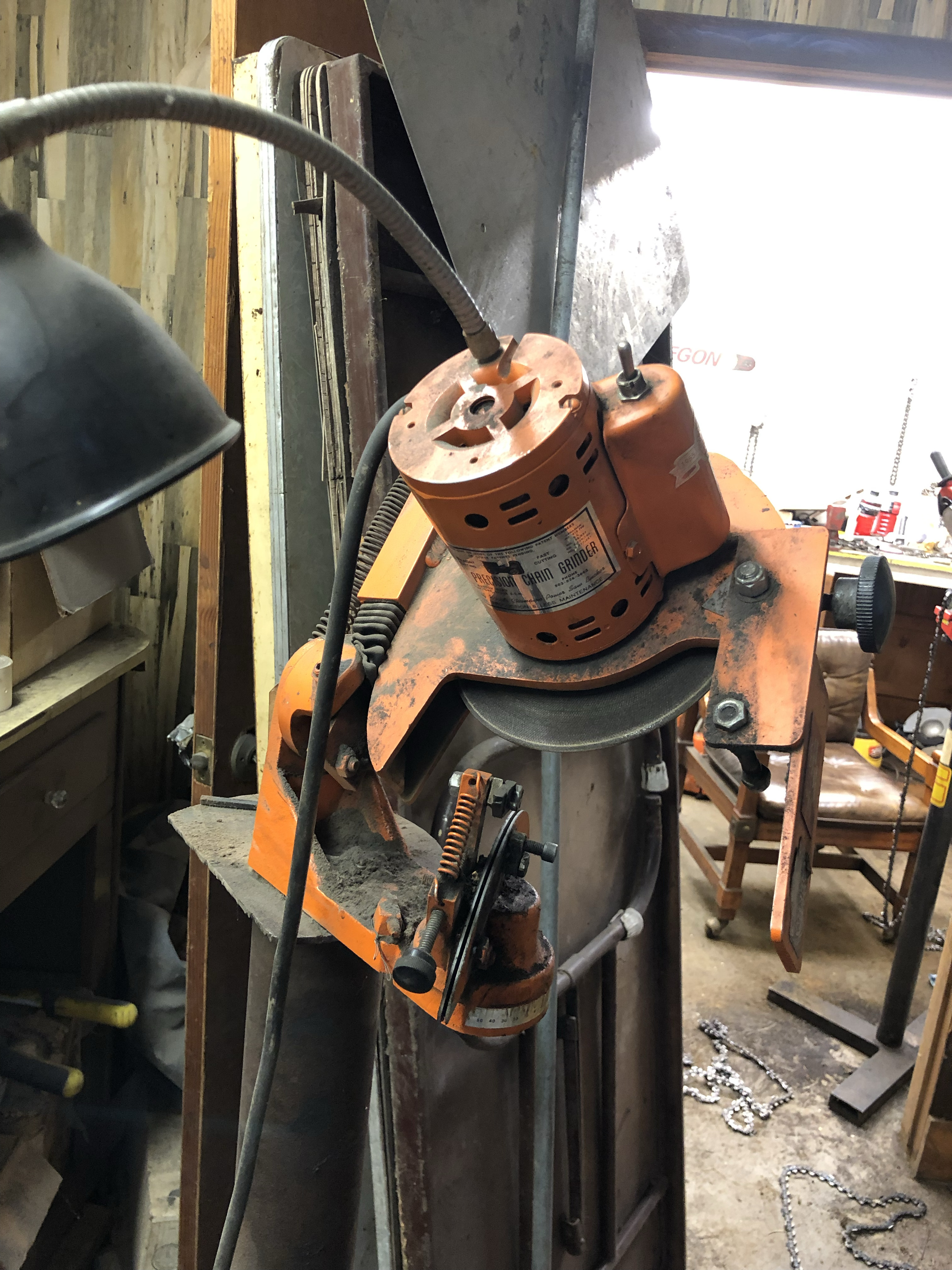

I have an Oregon 505 electric chain sharpener with a diaomond wheel. I bought it used from the local Stihl dealer years ago. I no longer use it.
I use this instead:
About $40 from Bailey's: Pferd CS-X Chain Sharp Filing Guides
Easy to use, very effective and no driving +20 miles to have a chain sharpened.

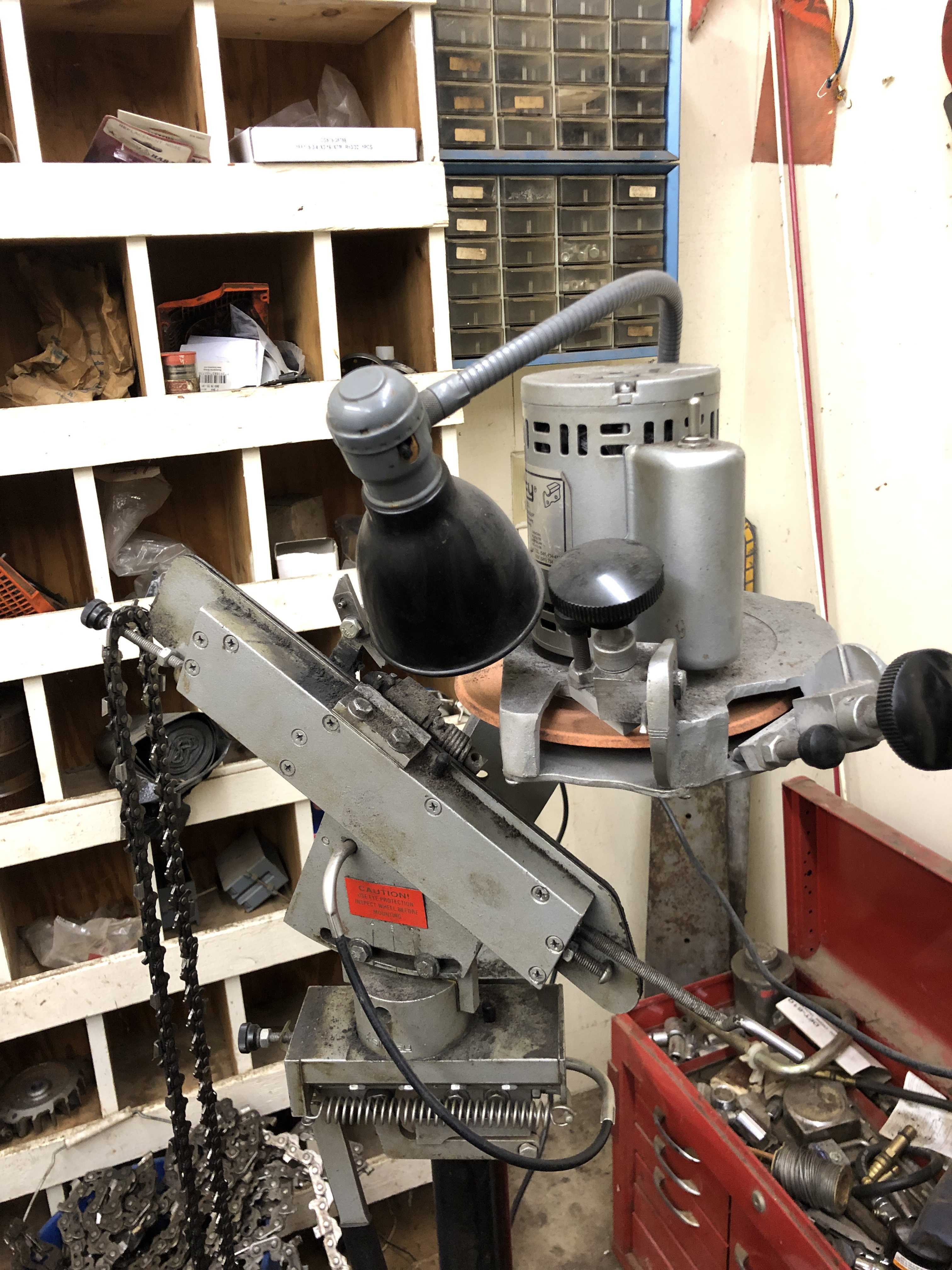

I forgot to mention that I also sometimes use the Timberline sharpener which if you get the hang of can give you consistent tooth lengths and sharp with minimal waste of teeth. You still need to adjust the depth gauge for height and profile. The Timberline has a few different cutter sizes. Timberline Chainsaw Chain Sharpening Guide (5/32") Assembly

Actually, this is true, IF you use a progressive depth gauge tool to set the raker depth. What is important is that each tooth take the same amount of "bite". One way of achieving this is to keep all teeth the same length, and to routinely take the same amount of each raker (or use one of the non-progressive gauge tools which span two or more teeth with a cut-out to indicate the proper depth). Because the height of the tooth changes as you sharpen it back toward the rear of the tooth, keeping the teeth all the same length keeps them all the same height. Taking all the rakers down the same amount (either by hand or by lying a straightedge across two or more teeth and measuring down from there - which is basically what the non-progressive depth gauge tools do) gives acceptable results because all of the teeth are the same. This method does not work when the teeth are of differing lengths, since their heights differ. When the teeth differ, the raker needs to be customized specifically to its associated tooth. Laying a straightedge across a couple of teeth of differing heights will not accomplish this: some rakers will be too high and some too low compared to their associated tooth. If you damaged all of your left side teeth on a rock, and filed everything back just enough to remove the damage and no further, you'd find that the teeth on one side cut deeper than those on the other, causing the saw to cut on a curve.
A progressive depth gauge tool is much more accepting of varying tooth length/heights, since each raker is customized to the tooth immediately following it. Using one of these depth gauge tools, I file each cutter enough to get a sharp tooth, if each raker is set to the associated tooth, the saw still cuts straight, even with a noticeable difference in tooth length. (I don't let them get totally out of whack, but neither do I spend much time worrying about whether they are all the same length.)
