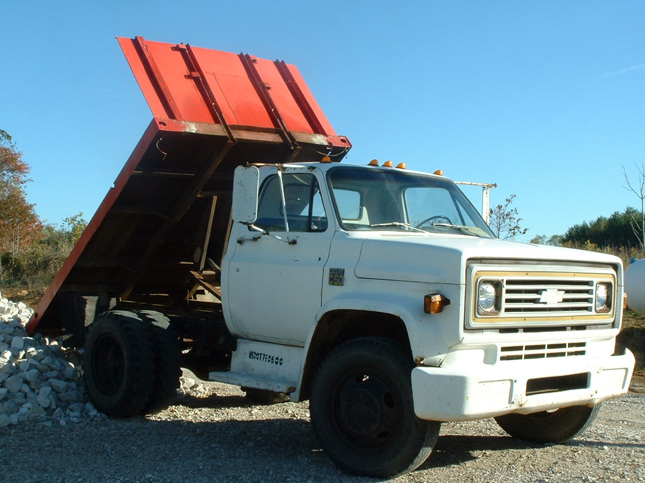

Its a 1978 GMC 6000, 7 yard.
Any idea how many ton that is?
Or what is the Gross ?
Thanks, tim

I had a 1976 GMC 7000, it was a 29,000 gvw, I think? I would think the 6000 was probably a 26k gvw, but depends upon what it was spec'd with for axels and springs.
/ Just bought a dump truck #4
The 6000 series GMC typically falls into the class 6 medium duty truck. I had the Chevy version of your truck. They made the suspension in several different GVW weight ratings in both single and tandum axle configurations. On drivers side door jamb there should be a label that has your trucks GVW rating. If you do a google search you will also find some web sites that can de-cifer your vin #. Good Luck!

Thanks for the link, it helped a little. Evidently there isent as much info in these older vins as the new ones.
I did find the door sill sticker.
It says 19500 GVW. The vin says its a 2 ton.
What is the 2 ton referring to?
The title says scale weight is 8600 ( I think thats chassis and cab only, not including the dump ?) and I have it licensed to 14000 #.
Thanks, Tim

Just FYI, when I search for the density of dirt, I get 3200 to 4200 lbs per yard.
Don't fill that bed too full...

I realize I could have bought more tonnage, but I'll be using it as a site truck when I get it to Idaho so I dident see the sense in paying more.
Thanks for the #'s on dirt, I kind of thought it would be easy to over load that truck!

Heres the pics:)

Thanks, its a 366 (first time I've heard of one).
It runs great! I took it to the recycle yard yesterday to dump a little broken up asphalt that was a little bonus when I bought it:D.
Got in a little practice with the splitter.
Bad news, empty scale weight is 11300#, that only gives me a 8200# load.
O well, at least the gravel pit is close:).

The 366 is a mixed bag. It's actually a big block engine even though it only displaces 366 cubes, so it's very tough, almost impossible to destroy. Downside is if it's a smog motor, it will have a myriad of pumps & hoses all over it. Not a real powerhouse, but it's definately a truck engine, not a car engine.
8200lbs isn't bad. That's about the same as a new F-450, but you probably paid 1/10th the price. :D

Big block you say? Hmmm... it deffenatly has a small block in it with no smog.
I was thinking a 366 was a stroked 350? (The vin says 366.)
Maybe some one replaced it.
