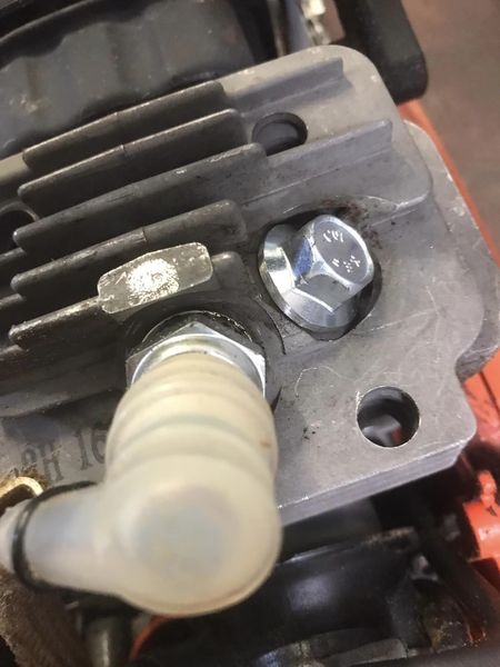

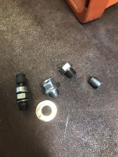

If you ever need a decomp plug for a newer echo. They will scare ya pricing one. 14 buck and if not buying from dealer add shipping too.
So for 2 bucks I made one. Just rednecking with hacksaw and grinder.
Guys with a lathe could do them really nice.
Use copper washer for crush ring. I didnt have one local so used brass for testing.
No you can not use husky, stihl, dolmar makita etc decomp plugs. One shown beside the one I made.
I'll post oem ones for echo too.

View attachment 888458View attachment 888459View attachment 888460

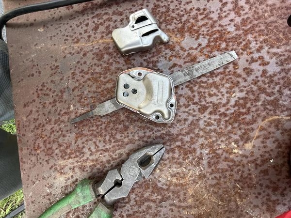

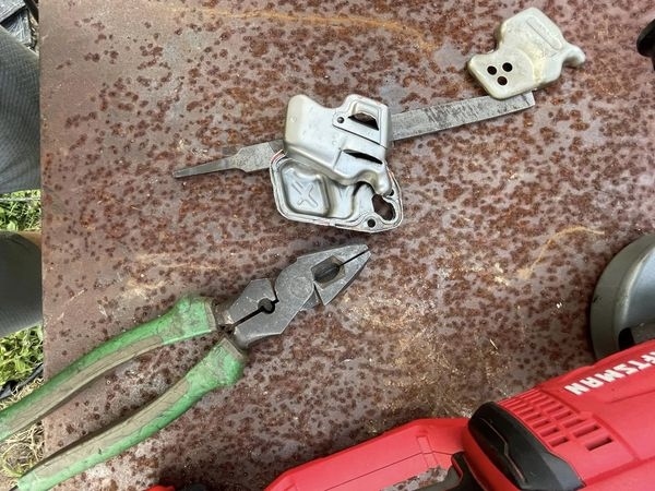

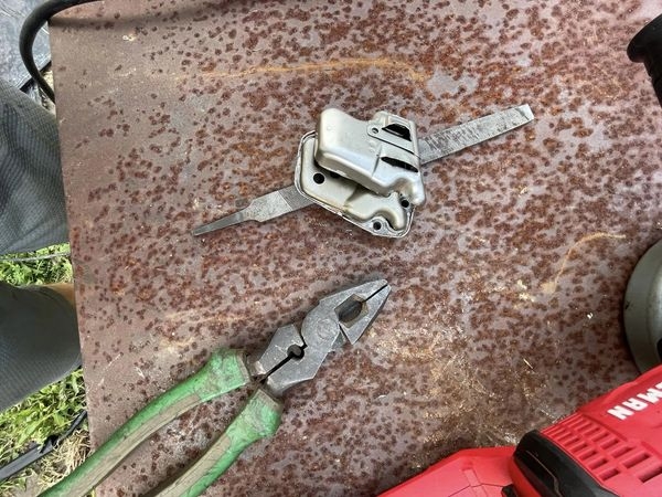

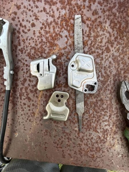

Inside a echo 2511 OEM muffler. Now you can see why they can not breath and need help big time.
Least no cat BS like in some of the others.
Friend had uncrimped his even after adding a gill exit before.
View attachment 918654View attachment 918655View attachment 918656View attachment 918657
I don't 'uncrimp' them at all. I grind off the crimped over part with my large flat plate grinder, mod the muffler and then weld the 2 halves back together again. I either use a MIG or I TIG them if they are clean.
