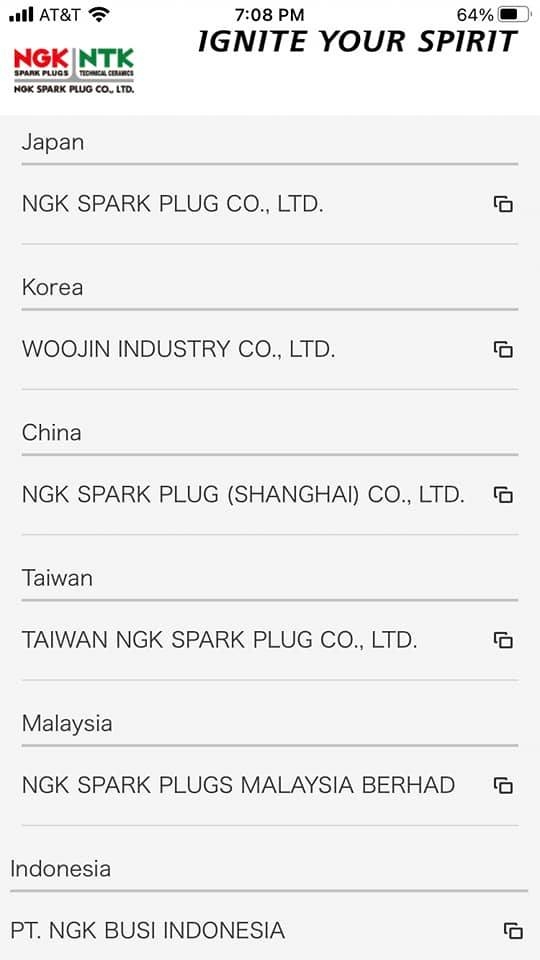

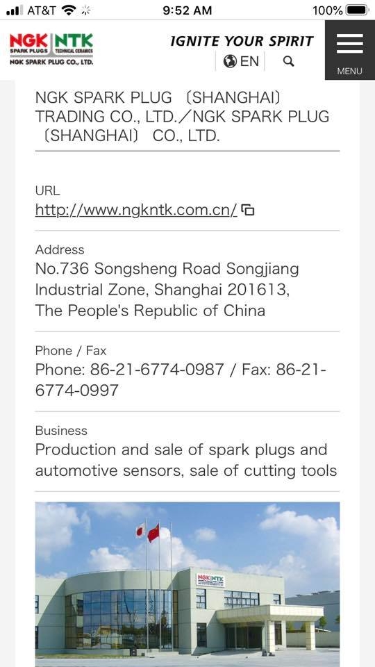

They say they put the location where their plugs are made right on plug if even a China plug.
Dont try to hide it like ngk does on their China and Thailand made plugs on boxes only. Ngk only marks plugs made in Japan on their plugs. Tries to hide the rest.
But they do use China too for some plugs. Straight from their website. All DENSO Spark Plugs are manufactured in Japan, Indonesia, China and USA.
Just so we know.

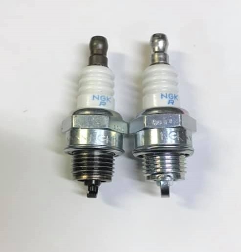

Back on the topic of plugs, I came across this website. Granted it is a UK site, but anyone know if the NGK plugs you buy in the US from Sthil are any different from other NGK plugs of the same model?
They used to be if you didnt know which one you were buying long time ago. 4 digit code was used to tell you which was which to stihl spec.
They only sell the stihl spec plug now.
Both in pic with same plug number. But when ordering they had a different 4 digit code. Stihl wanted solid tip like on left.
Also that one on left is a China made NGK
