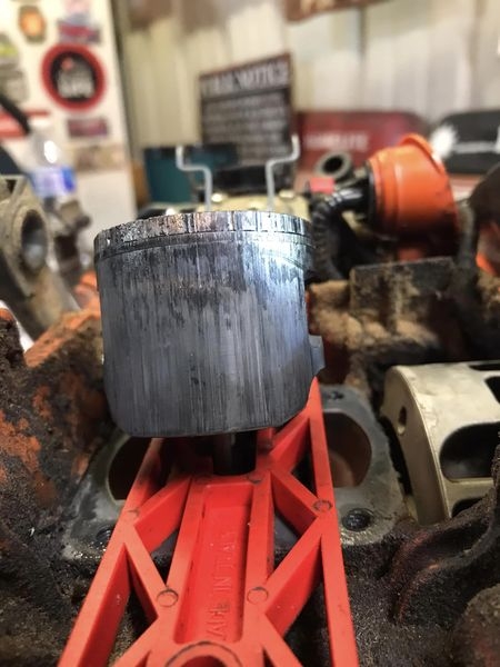

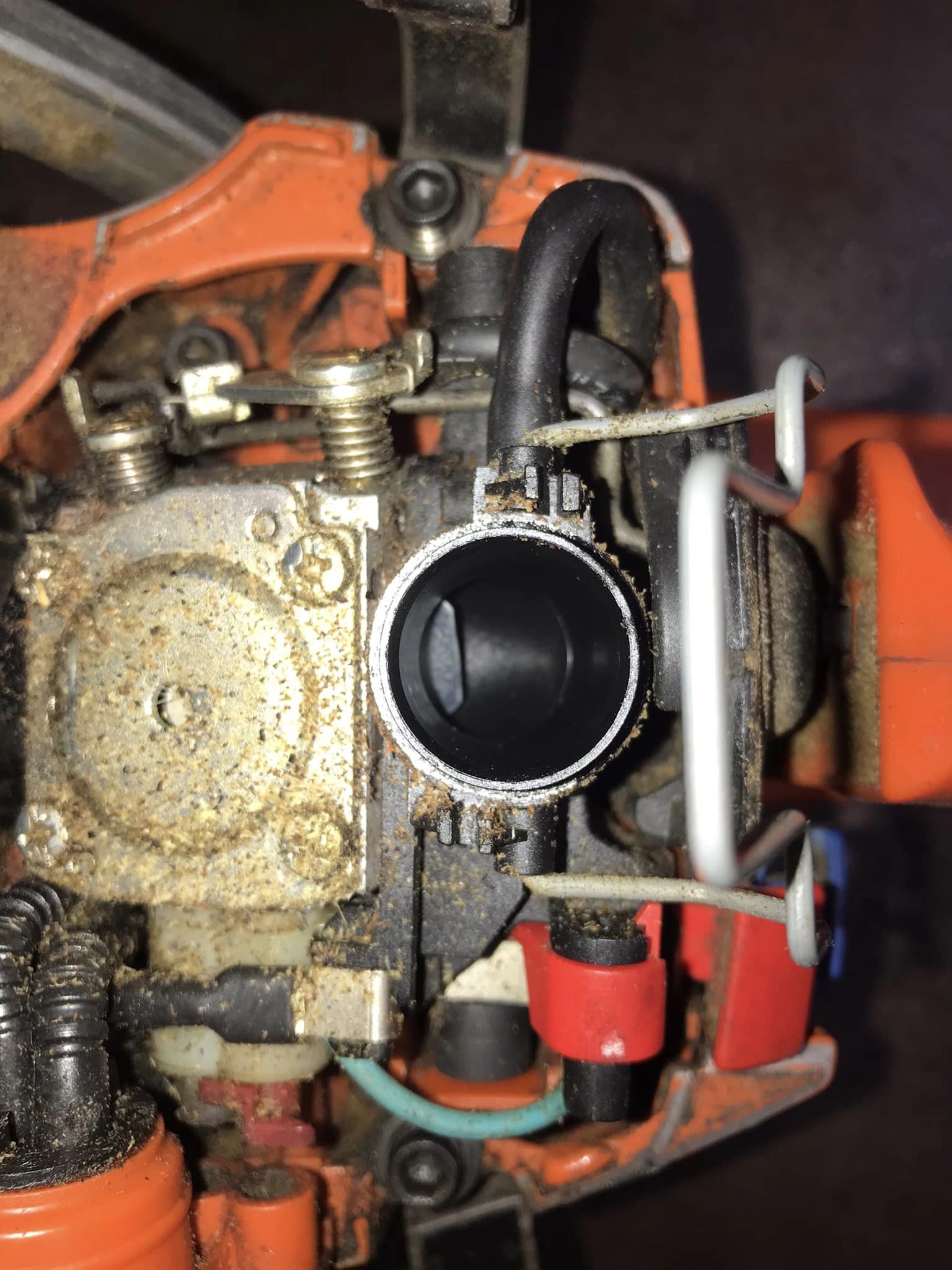

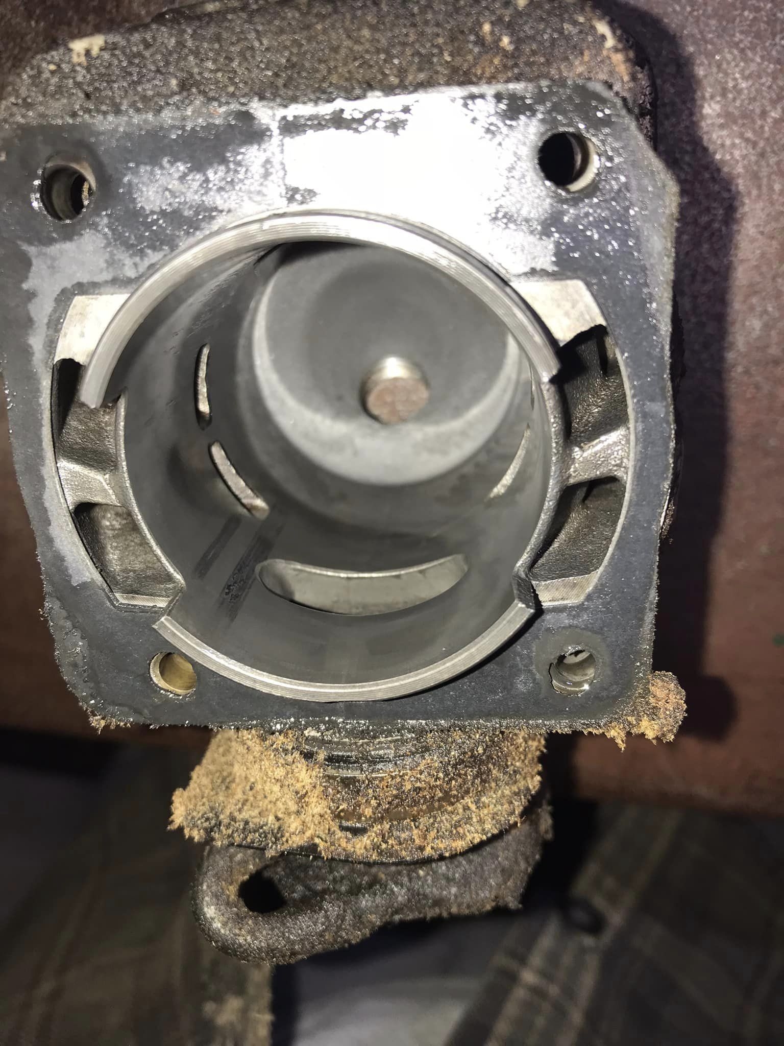

Just a typical neglected saw till she quits on ya.
Smelly old mix, plug was loose, muffler loose, 2 cylinder bolts loose.
Scored and finally stuck exhaust side ring.
Imho cylinder will clean up easily.
Just going to order piston kit and different muffler with out the cat. Tired of digging that crap out of them.
Mesh filter was doing its job. No fines in throat.
2009 346 etech

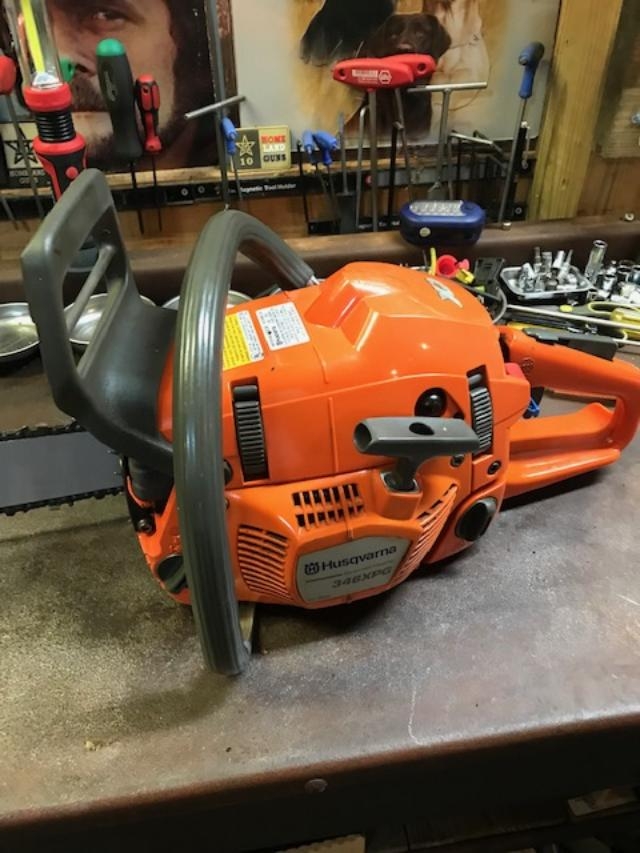

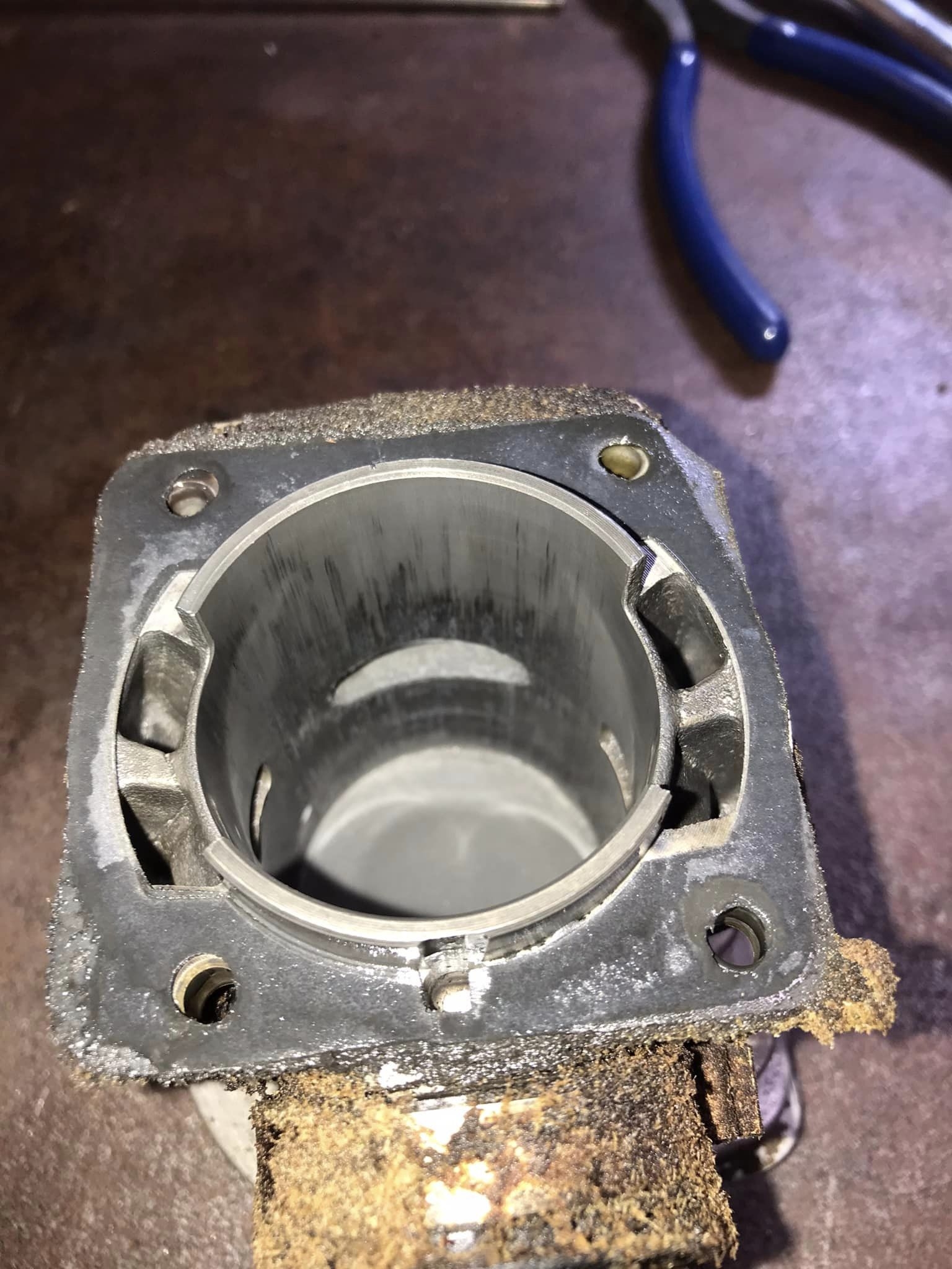

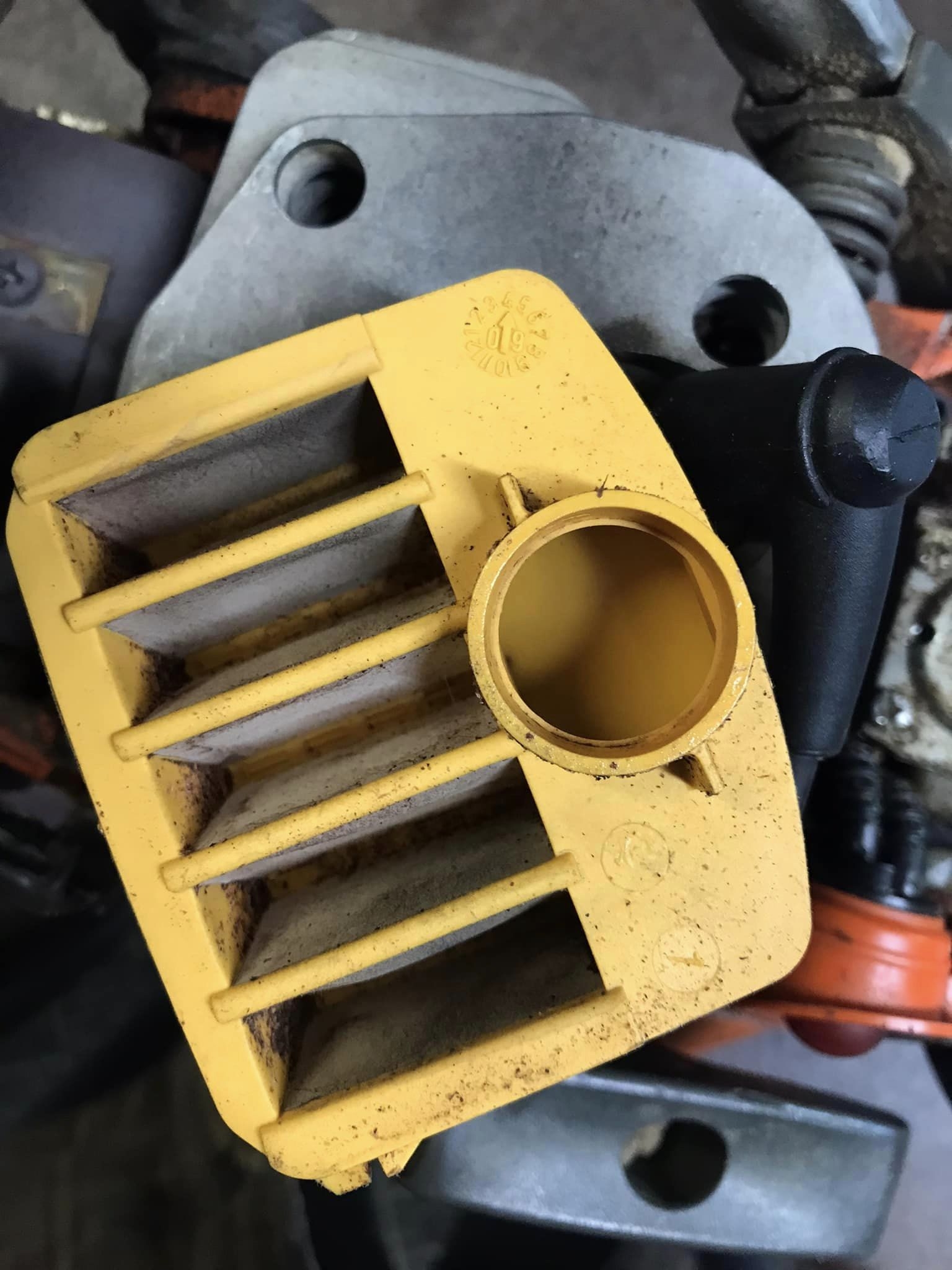

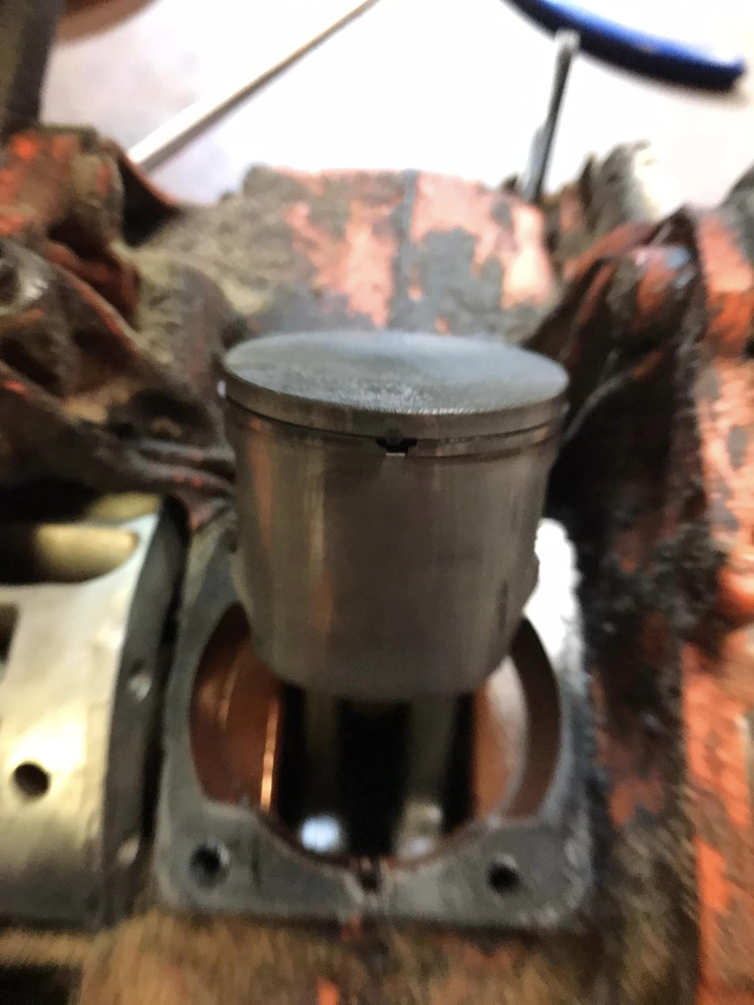

2009 346 etech
View attachment 1678880View attachment 1678881View attachment 1678882View attachment 1678883View attachment 1678884View attachment 1678885

Wanna sell this saw before repairs?
Parts already ordered.
So nope will sell after done and have a line already from my CR group and a local that bought my last OE one.

Lot of cleaning to get the crap out of all covers around coil etc etc etc.
New meteor kit in and she lives.

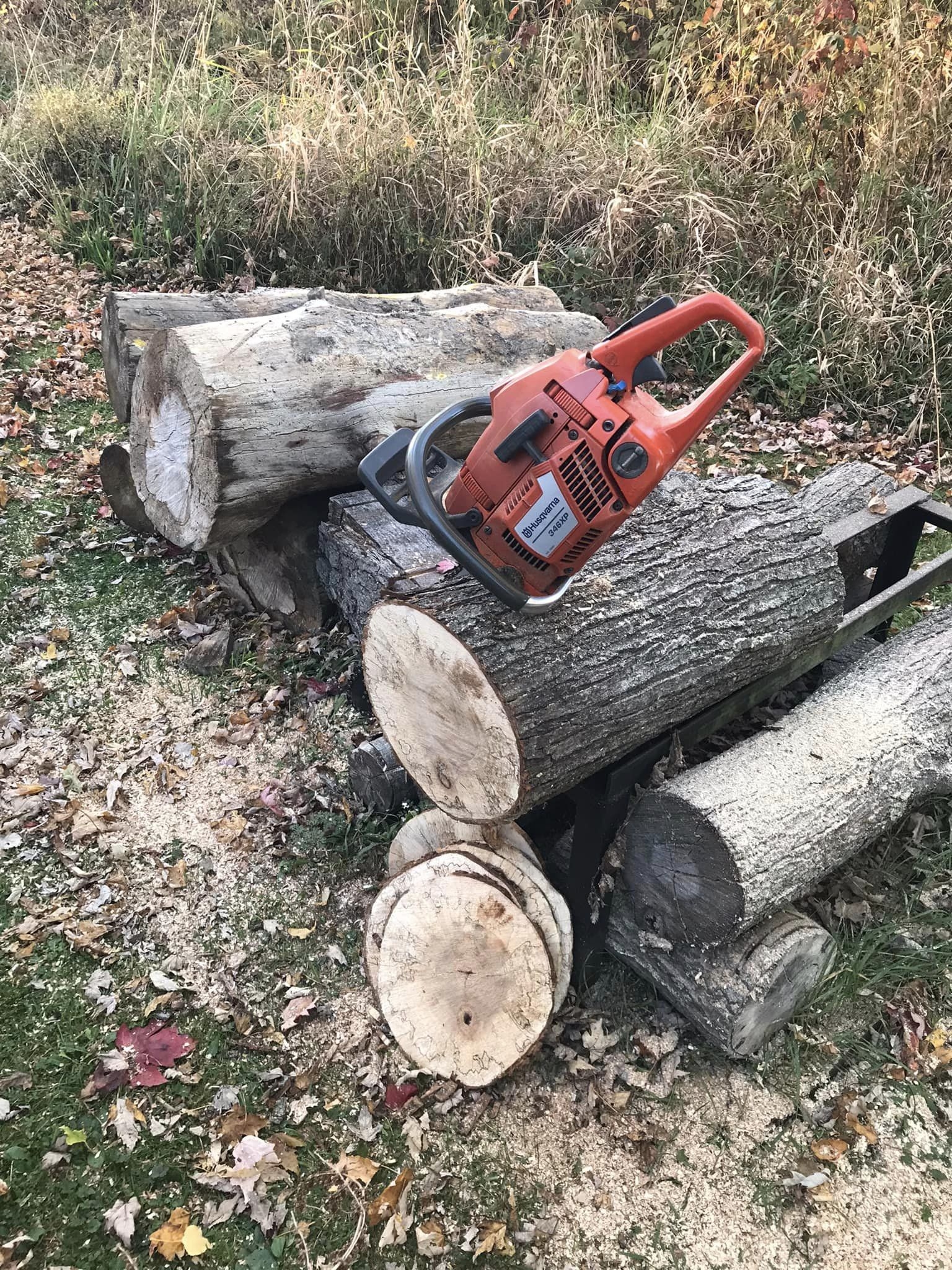

Pic from video idling.

She sweet even with new piston kit.
Now waiting on regular muffler. Tired of gutting the cat ones on these and 359 etc.

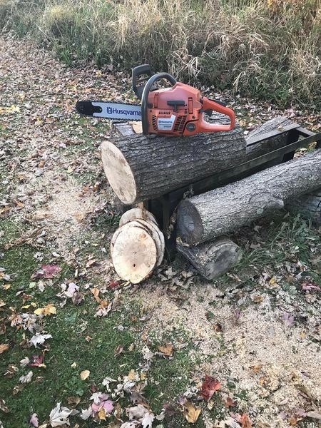

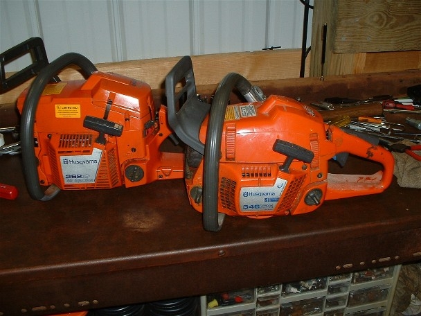

Like in an earlier picture, I have a 262xp and a 346xpg. Both are great saws. I use the 346 the most since it's lighter, but for anything bigger than 10"-12", the 262 makes much quicker work of it. I also have a 385 for the really big stuff. Had to remove a 30" downed tree a couple of weeks ago and it beasted it's way right through it.
