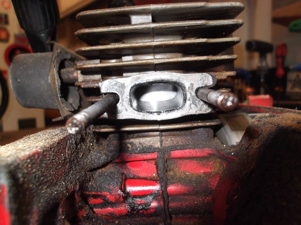

ok, need opinion.
Looks like I scratched the piston on my 49cc, 18" bar Craftsman.
I see grooves when I take the exhaust off and ring looks damaged too.
Worth fixing, might need a new clamshell, piston and ring?
Anyone know cost for parts?
I already have 2 saws and this was a backup for a while.
Not heavily used for the last 3 years. So surprised it self destructed.
Only if you have another parts saw to steal from or get on the cheap to make a good one from.
I wont put the money into new parts on plastic clamshell saws that can be bought for 50 running myself.
I also explain this to folks bringing them in it is not worth the labor cost and parts cost.
Cheaper to sell them another runner for 50.

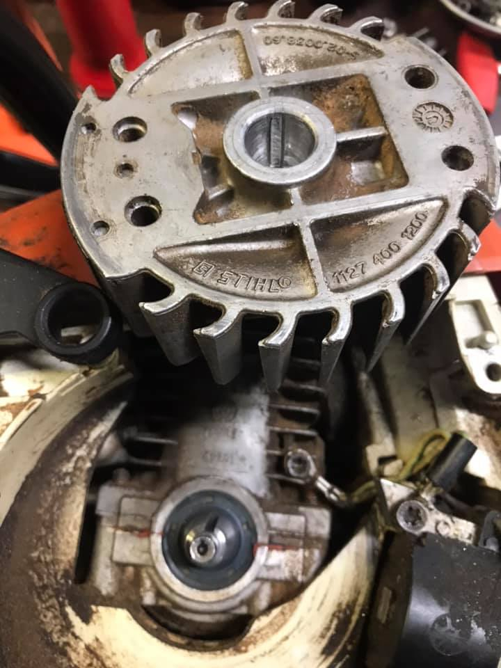

Stihl 039.
What a cluster
Guy loaned stihl 039 out to one of his workers. Looked like been trenching.
Fixed the broken recoil and removed the boot lace used to try and fix part of that and broken handle.
Missing tank vent so made one up.
Somehow it sheared the key off the flywheel and the flywheel nut is stripped out and wont come off. Just spins. :ROFLMAO:

After all back together and pulling over something didnt feel right on 039 and wouldnt start. Backfired once. So starting checking.
They had sheared the key molded into flywheel. Then the fly nut stripped all its thread sand wouldnt come off. Fun fun s o b
I had to cut the freaking nut and use chisel too. Finally off. Some of the crank threads are fubarred too.
