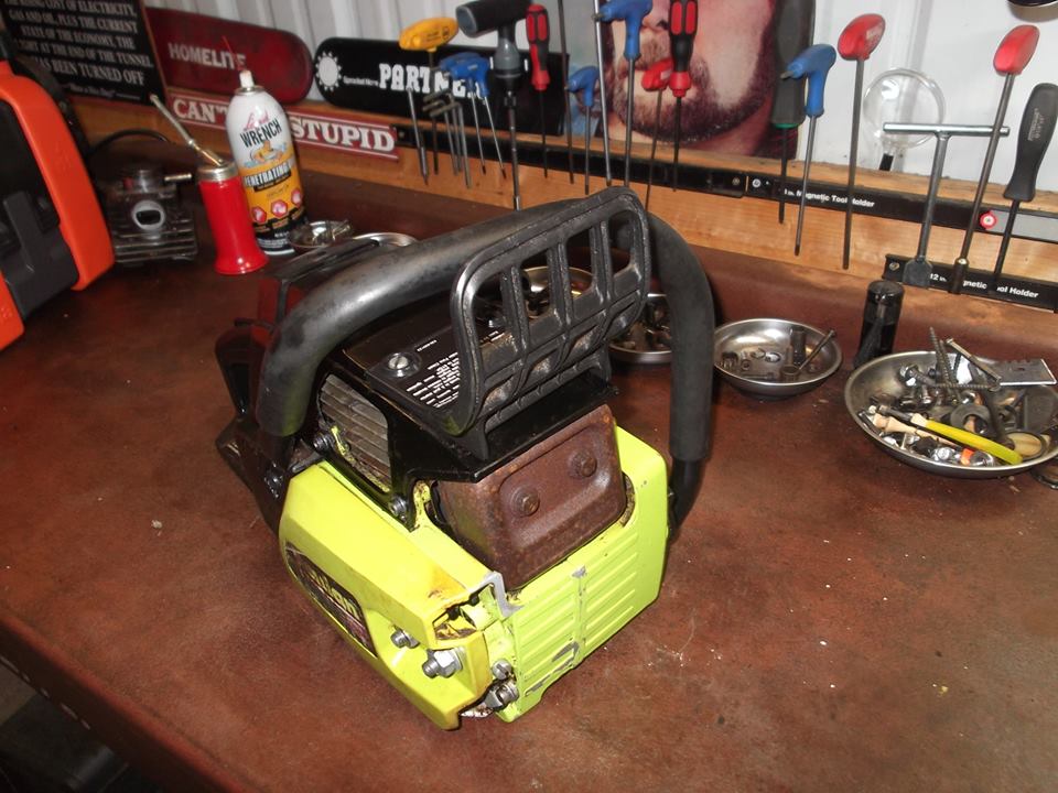

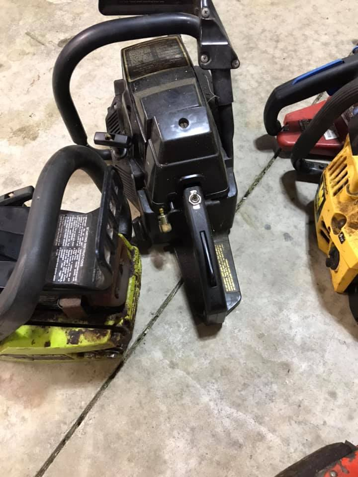

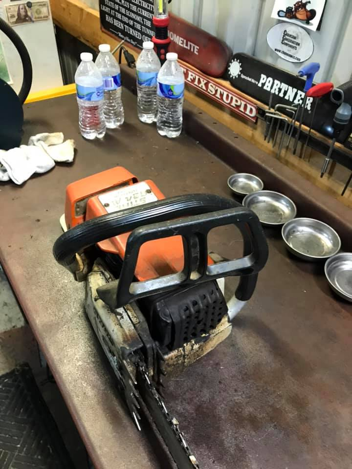

Parts are parts. Dropped off for labor to work on a saw for a local.
Only 1 in there has my attention and it has low psi by feel.
The stories some of these saws could tell about past owners. :LOL:

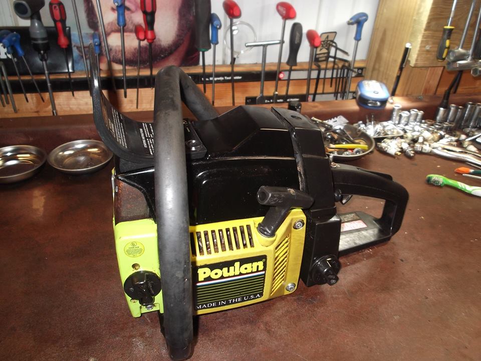

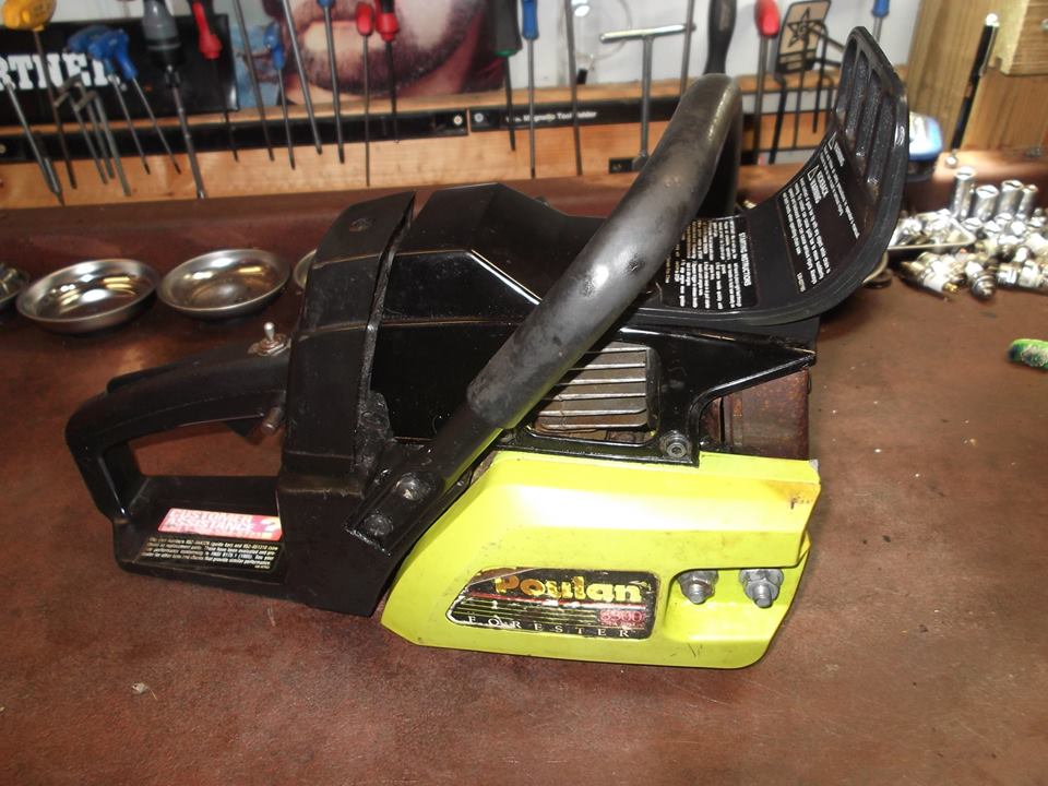

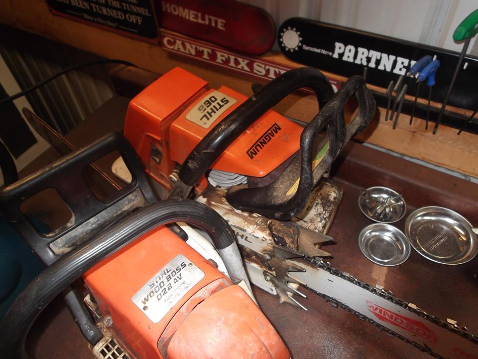

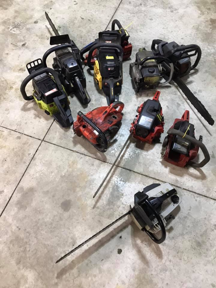

Clamshell 46cc Poulan 295 4620 2750 etc. This 2750 is chrome bore.
Some folks like them. I just send them down their way once fixed or I part them out. Not for me.
Cut close to the stihl 025 250 clamshell saws.
They are a 1/3 to 1/4 of cost of a 25.
Crap epa line that separates.

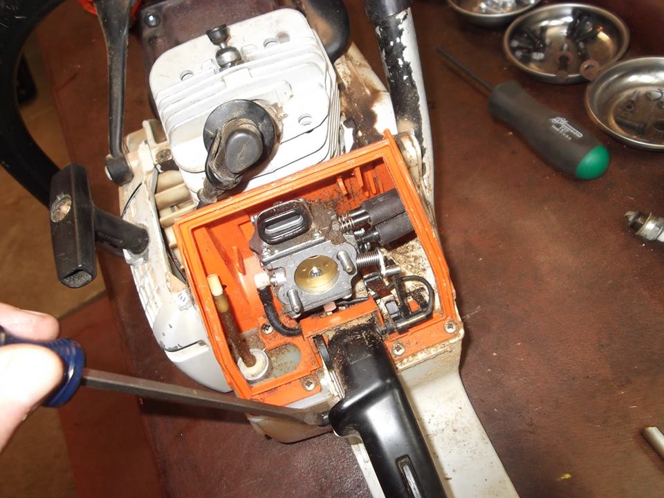

#1,143

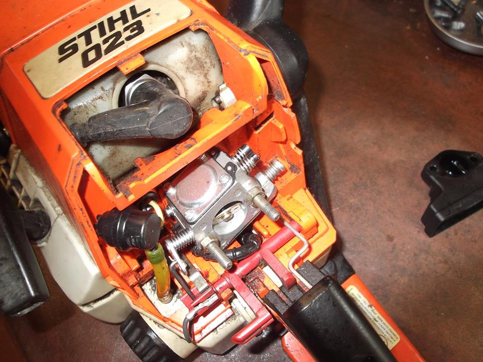

Freaking stihl cheap garbage zama china carbs. Hate these carbs. Cheaper to just buy folks new carbs.
I order ones with full adjustments once I do too.

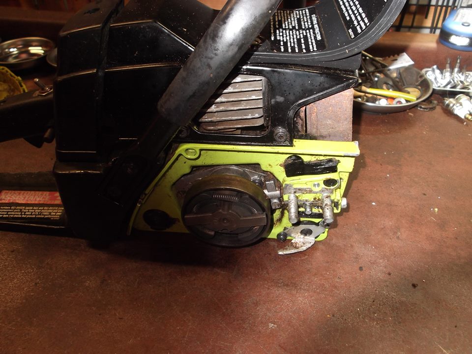

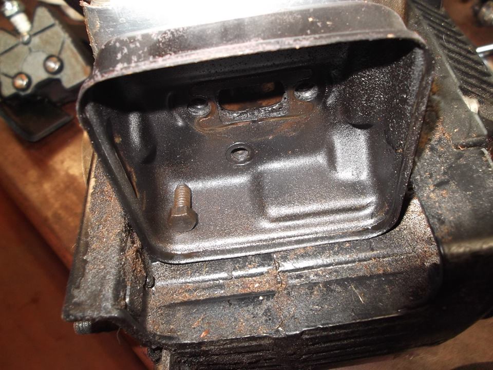

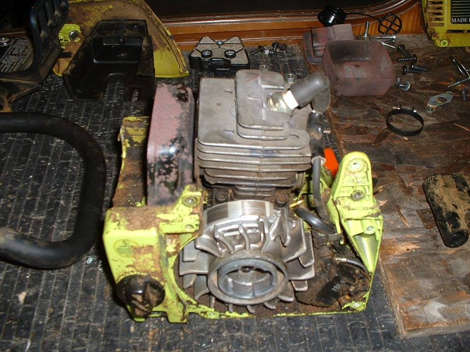

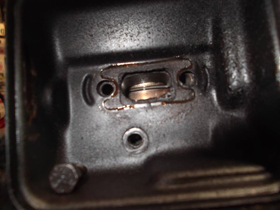

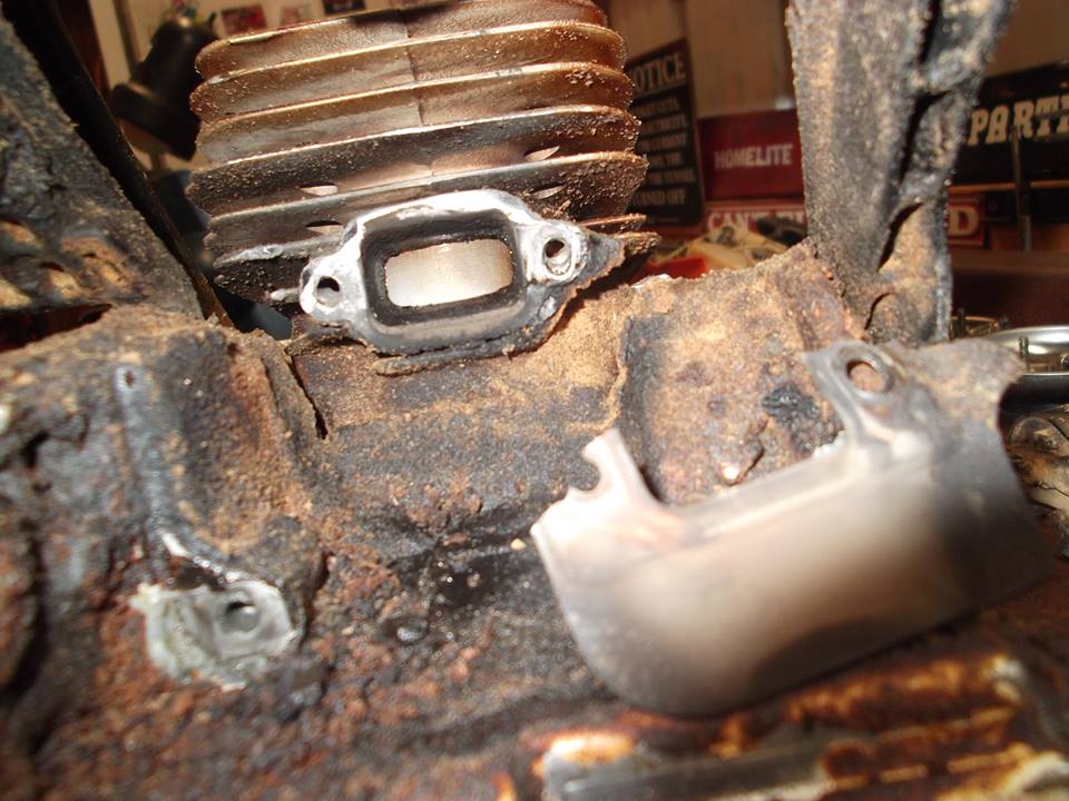

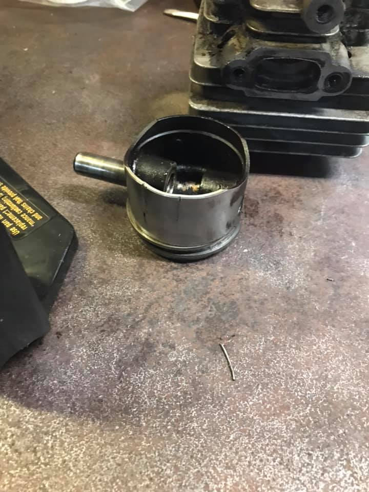

Saw came in and was low psi. Found reason why. Missing circlip.
Flushed several times and air with hose several times. Inspected thinking I found all the pieces of the circlip. Missed one.
After rebuilding with another used topend. 2nd piston locked with missing piece.
All good now though with another top end and inspection.

With a piece of metal bouncing around in there should keep the carbon build up under control. :rolleyes:
You should see what a crank bearing or rod bearing does to a piston. :ROFLMAO:

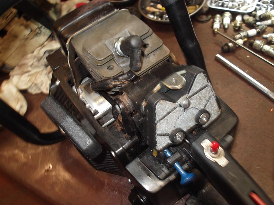

#1,147
Little used saw a local picked up. Needed fuel line. Oiler not working. So got the redneck check valve fix. All good and running and oiling now. Owner will be happy.

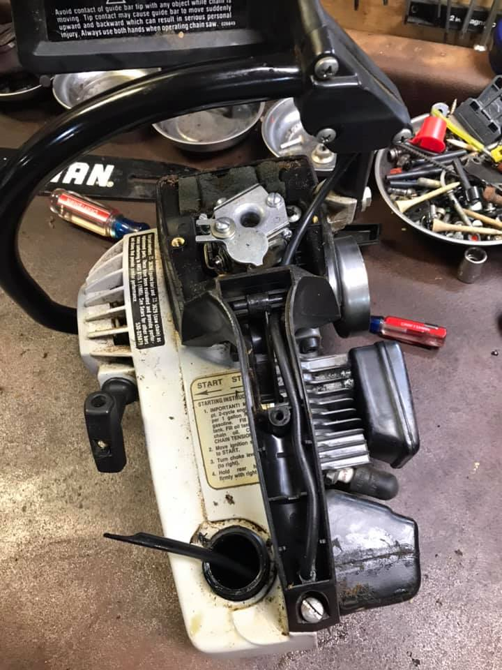

Topped the tanks off while opening the inner baffle on a plastic 46cc poulan that cut like a plastic 025 250.
Was like what the. :rolleyes:😂🤣 Freaking plastic cases.
Going to part out this runner and use for cutting roots while still whole.
Had already drilled the freaking tank to use the 3x5 echo like over that tiny tygon line oem uses in trimmers etc too. 🤦‍♂️
I have a case on the shelf, But IMHO plastic saws not worth the time to me. Maybe someone if it was their only saw or something.

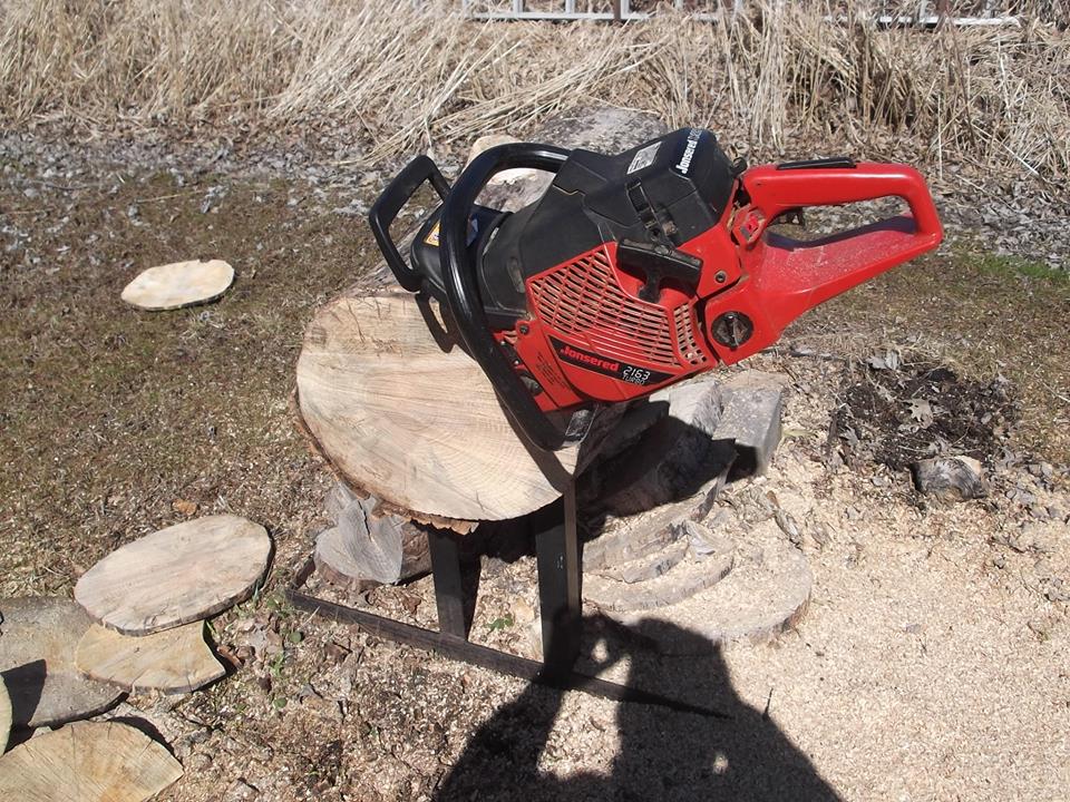

So I bought the Echo CS-620 and ran one tank so far.
Feels heavy when hauling to the cutting site, but well balanced when cutting with the 24" bar.
I will say it is a world of difference faster on the bigger Ash trunks than the 490.
And I felt less worn out while using it.
Good power, didn't bog down in the rotted core of one trunk like the 490 would.
Noodled a smaller, 2 feet long by 10" or so Ash crotch, fast, and NO clogging like the 490.
Now the 490 will be used for smaller stuff and as backup.

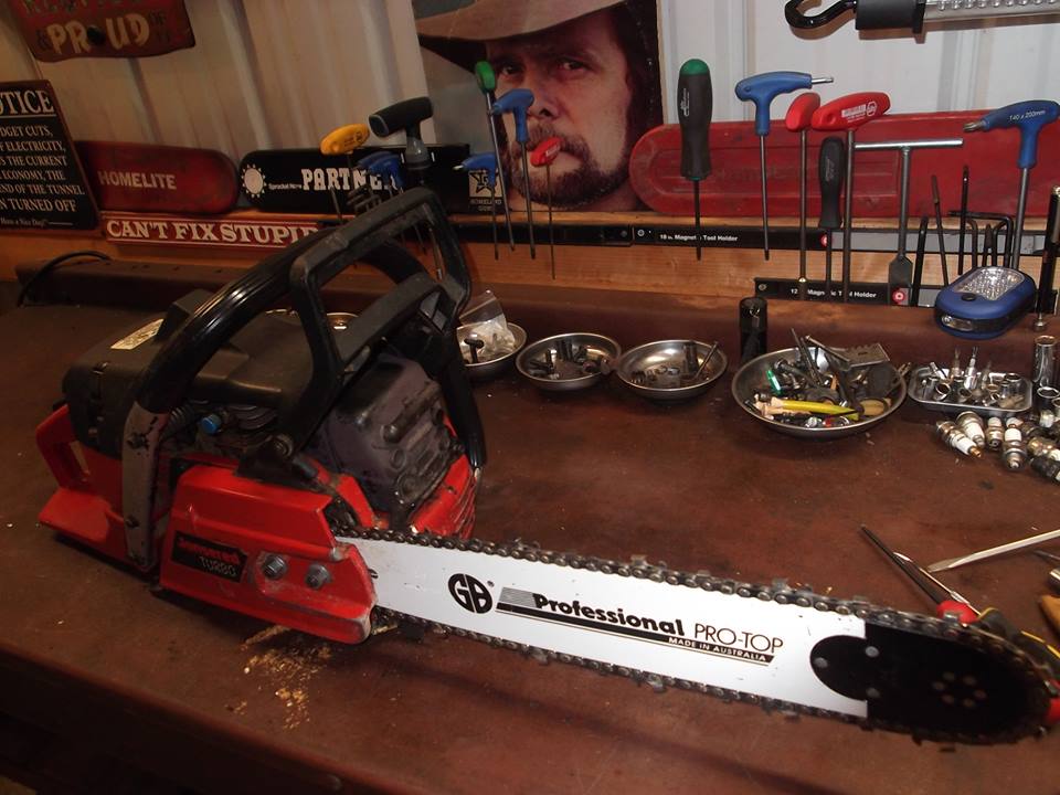

Just recieved from UPS today . A Shindaiwa 600SX I ordered online 24" bar also . Same saw as Echo CS620 . Two rings on piston etc . Of course haven't ran it yet . I felt like I got a good deal .
No one's asked me but I 'am goin to say it . $559 delivered , tax and shipping included , branded Red .

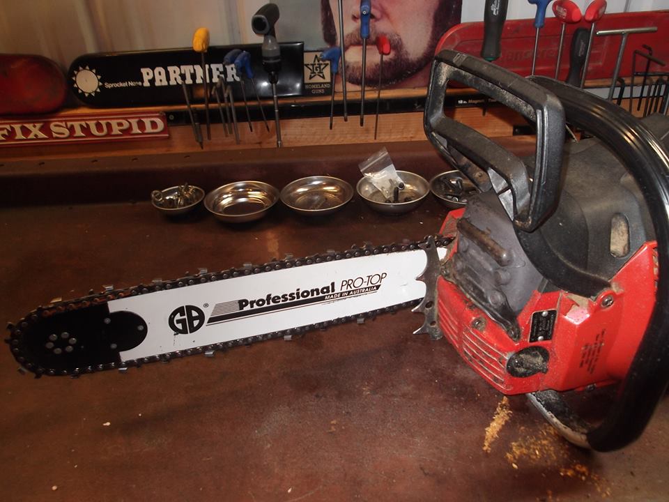

I love that nobody knows about certain good saws out there. 😆 Had to put in another piston today after a tear down to see what was up with the stuck ring.
These saws were way ahead of their time IMO. 1984 Partner 5000 plus and I had a 1979 5000 open port that was strong or stronger. This makes about 15 or more of these I have had now. Keeping a few back, well maybe.
I really like the guys that pass on the Poulan Pro 325 which is a Partner 5500. :licking:😆
Just a few.
Partner are/were fabulous saws. I bought one that had been run over by a truck but sustained only minimal damage - then used it for 15 years before it finally went to the big crankcase in the sky

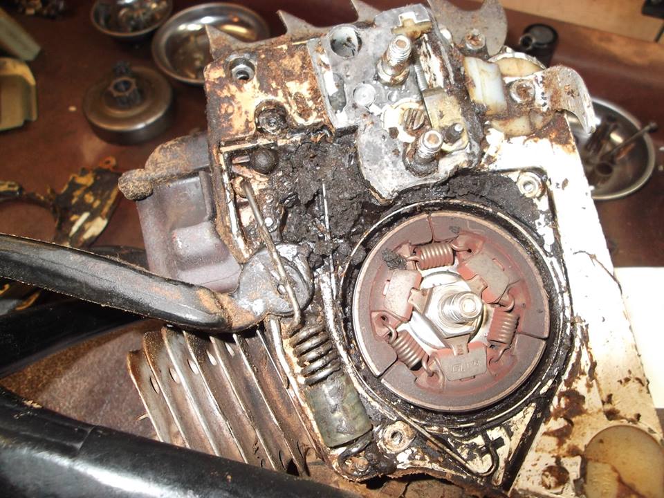

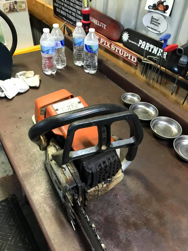

#1,154

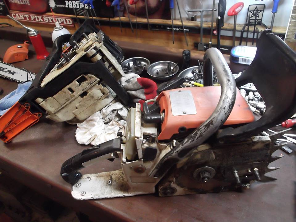

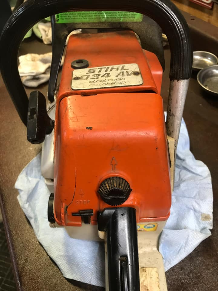

In after falling out of a tree. Messed up and wont run right.
/ Just another junk chainsaw #1,155
My favorite saw. I use one often.
/ Just another junk chainsaw #1,156
That is a fairly big saw to be up in a tree with.

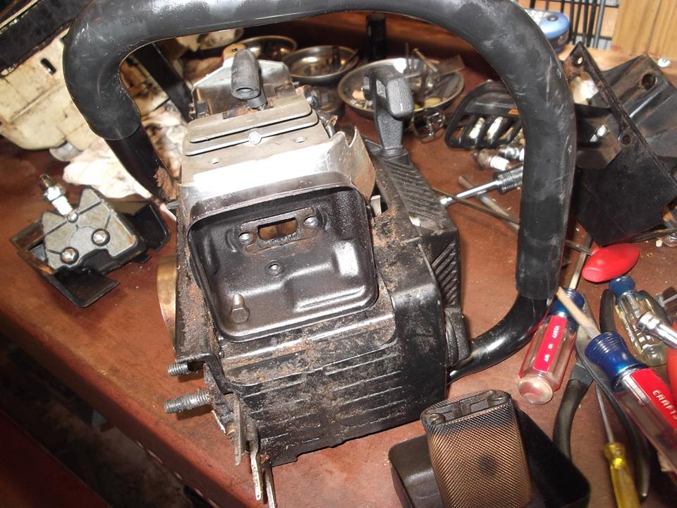

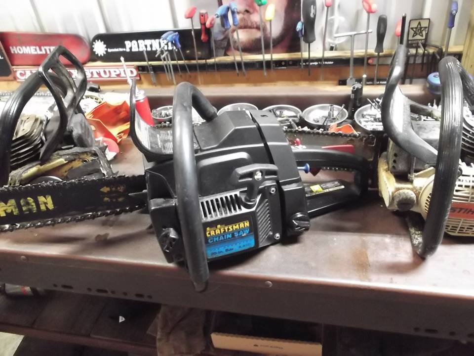

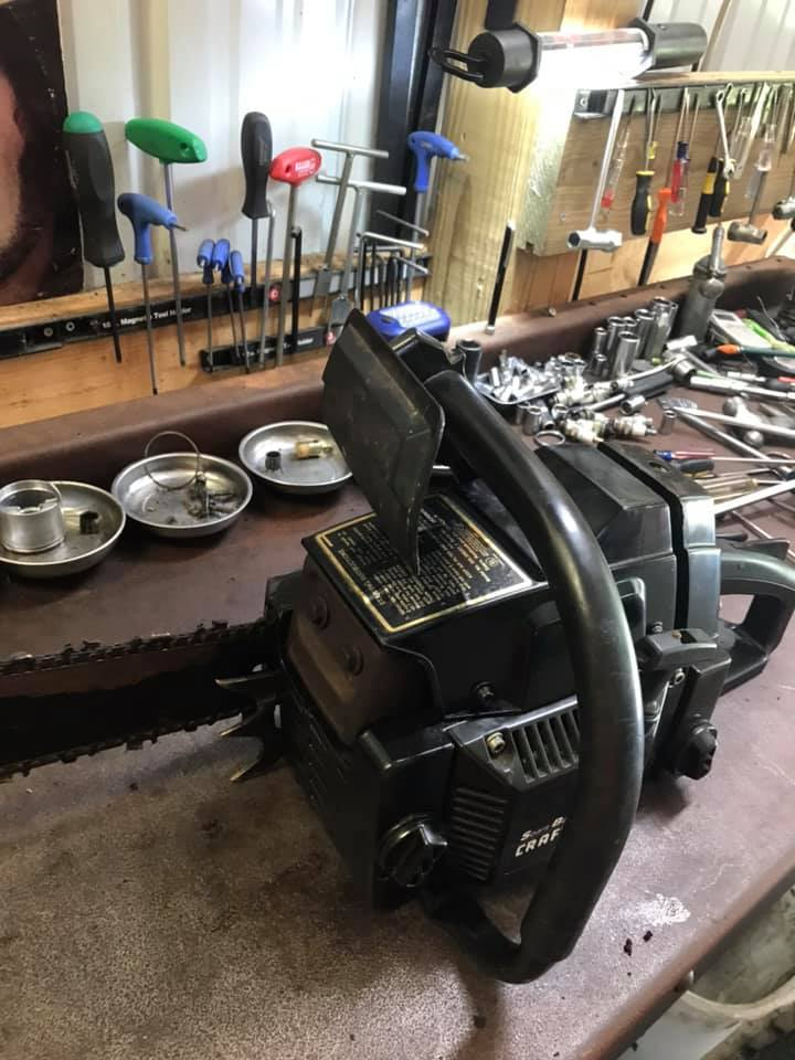

ok, need opinion.
Looks like I scratched the piston on my 49cc, 18" bar Craftsman.
I see grooves when I take the exhaust off and ring looks damaged too.
Worth fixing, might need a new clamshell, piston and ring?
Anyone know cost for parts?
I already have 2 saws and this was a backup for a while.
Not heavily used for the last 3 years. So surprised it self destructed.

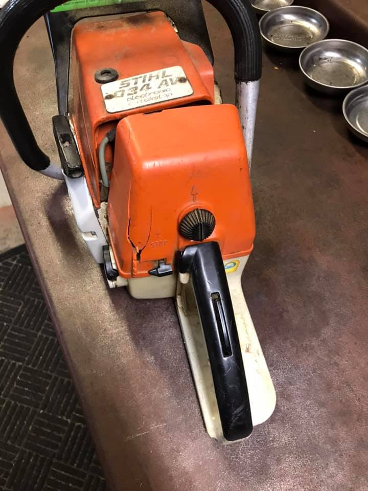

#1,160

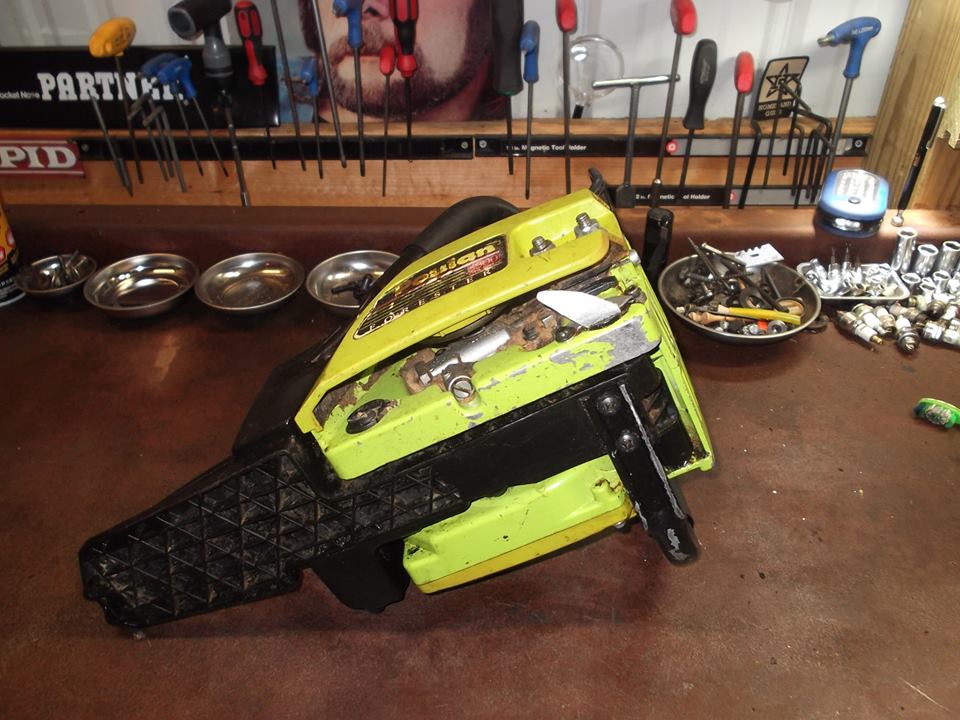

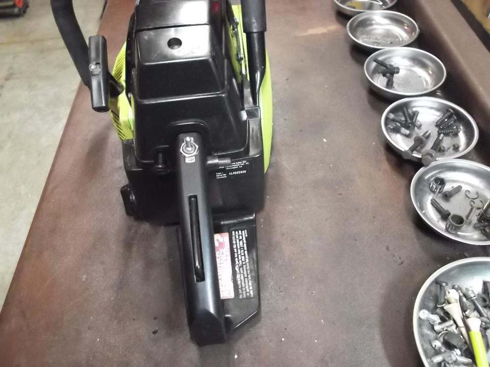

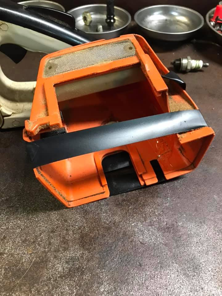

Redneck fix to try and fix the cracked up af cover.
Much better and runs like new again. Owner will be happy.
