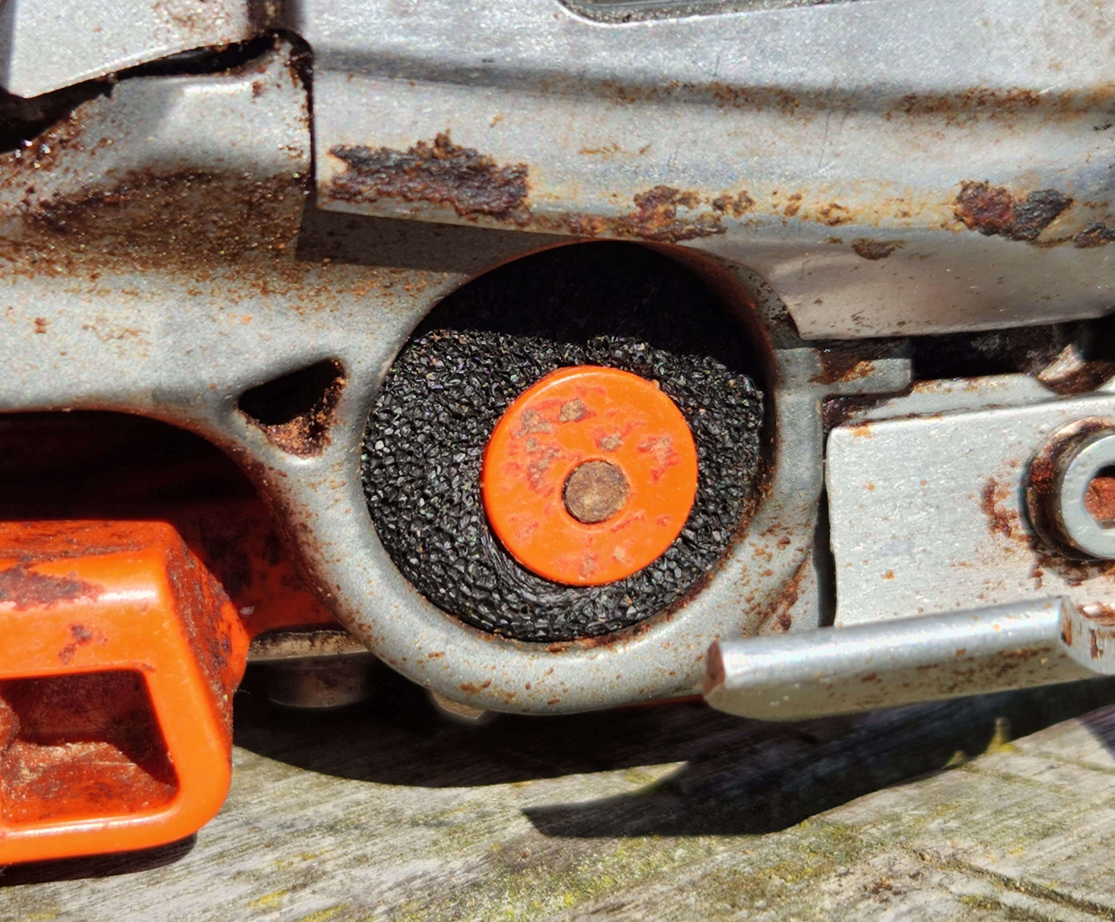

Great. Thats what the foam I have looks like. Should be pretty simple to do. Thank you
New tank to show limiter area
/ Just another junk chainsaw #2,094
Doesn't look like that pin or the end of that post removes at all.
#2,095
Why I searched it and showed you. Just slips over.
Basically the pin is the limiter and the rest to make it easier on case. Buffer deflector. JMO
Many older husky the limiter is just metal.
/ Just another junk chainsaw #2,096
The antivibration on this saw is pretty good in my opinion but it does seem to have a good bit of "travel" to it, even with the foam intact. I may experiment with some other materials just to see if I notice anything different.

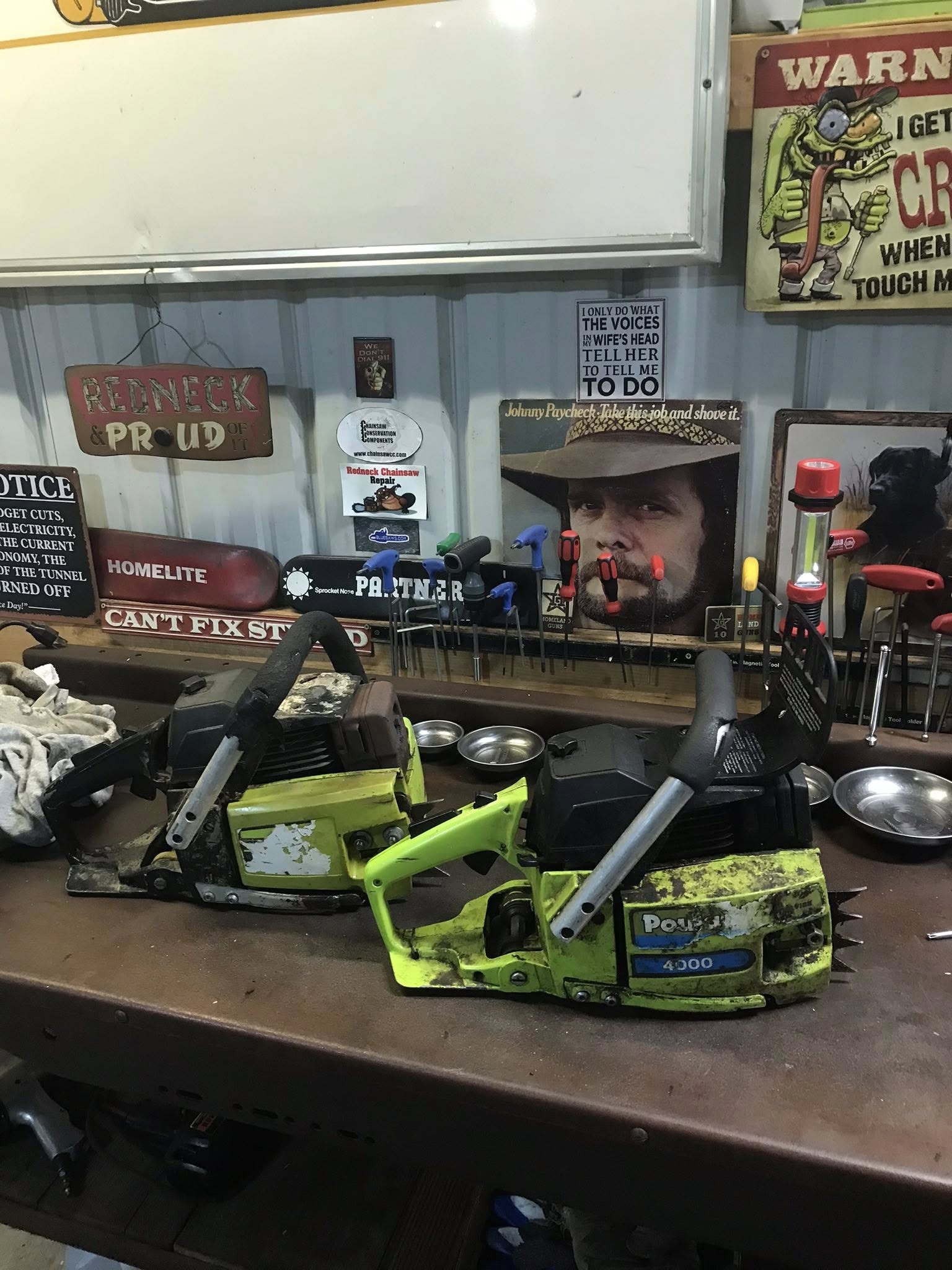

Had a couple poulan 4000 64cc dropped off just now.
Figured worst case scenario parts. But was told 1 ran last year.
Early and late versions.
#2,098
Tore both down for look over.
Later put some mix down each cylinder and they fired off. :cool:🍻👍

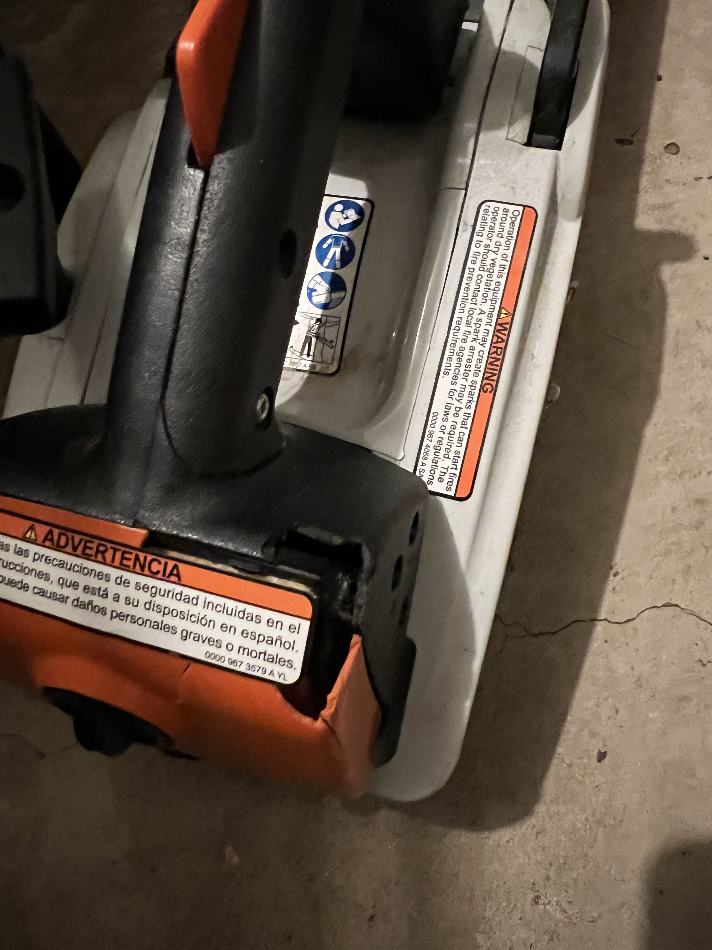

/ Just another junk chainsaw #2,099
Damn….broke my covers.
Left saw on ground near where we were clearing brush.
Sawblade on weed wacker just nicked the plastic….
Still running fine
#2,100
:oops: wow so it was the metal brush cutting blade?
