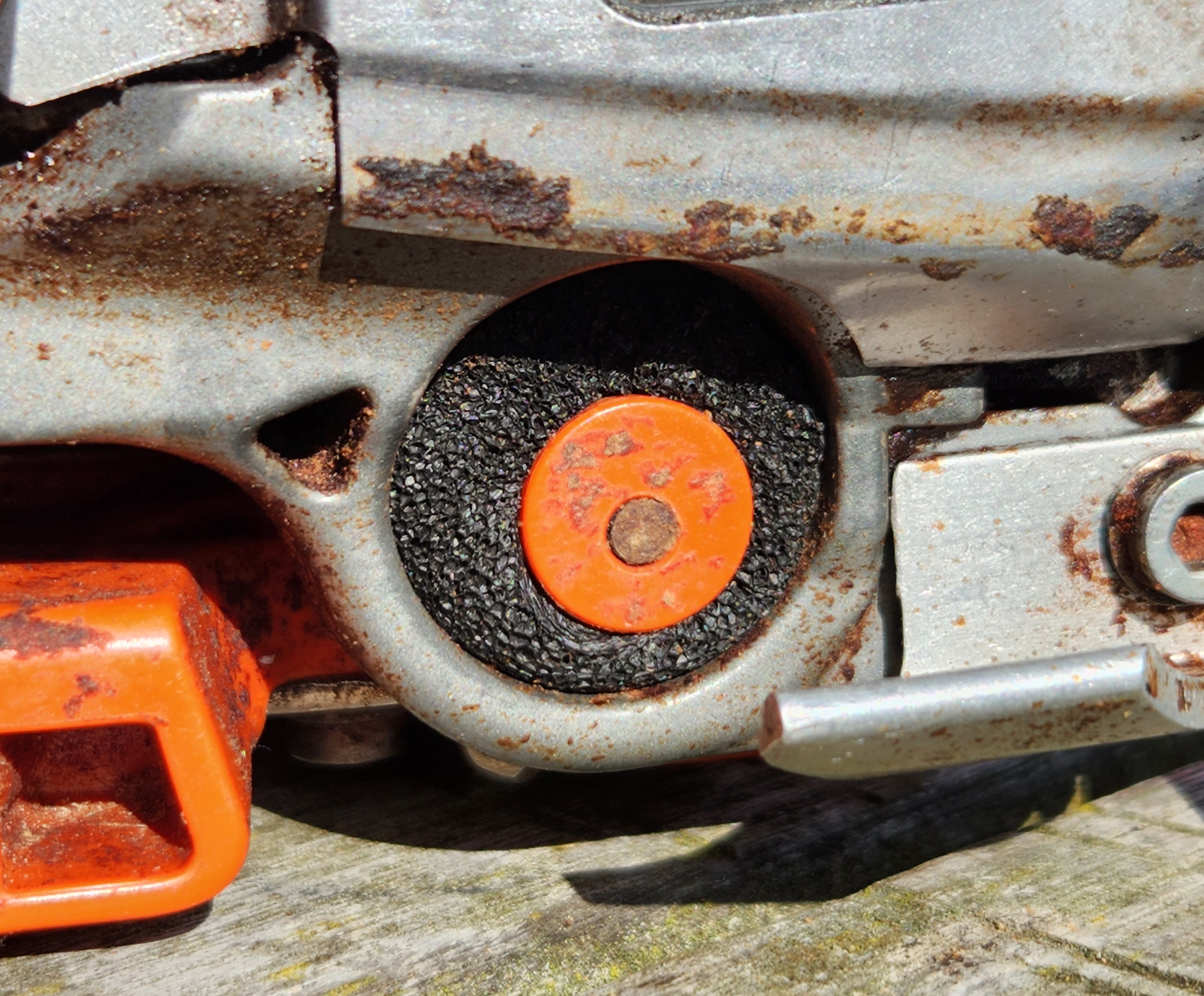

That's exactly what it is. It is a first gen 562 but looks like the same part. Thank you. Its been frustrating me.
Yep I checked 12 year old IPL just now too and same.
/ Just another junk chainsaw #2,083
It almost looks like something I could make. I've got a bunch of foam similar to it. May try that first.
#2,084
I'd try it myself.
Like said just to limit travel.

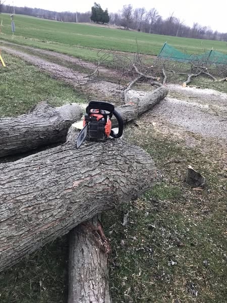

Tiny getting some more limbing time done. 12" under work. Echo 2511PN with Egan pipe for 28% gains over stock.
I honestly dont think I will ever be without the little rear handle one now.
Plus have a TH version too. But the rear handle one is getting all the use now. Just cats meow for light use.

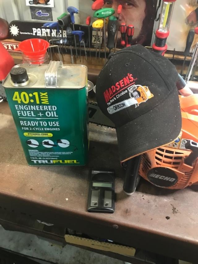

Just for info. I had ran out of my 40:1 Efree mix with VPracing. I put in some of my ER mix I keep on hand the Truefuel 40:1.
Just like when I tested in the echo 501. Ran same in 2511 with no changes I could see at all switching over to it. Perfect to end.
Folks just need to check what they buy and make sure not returned colored water. 🤦😂 Canned fuels not sealed.
Not bad when only have 6 bucks a gallon in it. I would never pay the regular prices for any of them myself.

Rear handles are very nice for limbing. Just keep a good grip on the handles if the tip catches a branch you did not anticipate.

I'd try it myself.
Next question...
How do I replace the thing? I just pulled the old one off because it was brittle but is the pin supposed to pull out? Do I just stretch the new one over top?
View attachment 3199360View attachment 3199361
They are such a great saw for the small stuff. They are so small and light that you can really make quick work of stuff.

Next question...
I have never had to replace one. But sure looks like it just pushes over.
This one guy said he made one from high impact foam.
