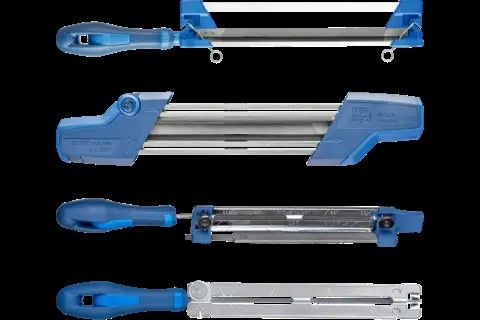

I still say for guys learning. Just get the cheaper one with just the guide that fits across the raker and cutter.
Then only use a raker gauge to do those as needed. Rakers dont need done every time you file if they are where needed.
I do suggest the 2 in 1 to some folks that just cant get it though. But buy the pferd ones as they make them for stihl. So cheaper in blue pferd ones.
I have the Stihl branded version. It's good.
But what is your opinion on the Timberline sharpener?
   / Just another junk chainsaw #1,626
My friend had a simple stihl 2 in 1 file and I was very impressed with it. Just a few quick runs of the file and we went for a few tanks with no issues. Think it cost him 60 bucks as opposed to 124 here.
Yes sir. I have one and like it. I was interested in the experiences people had with the Timberline jig though.

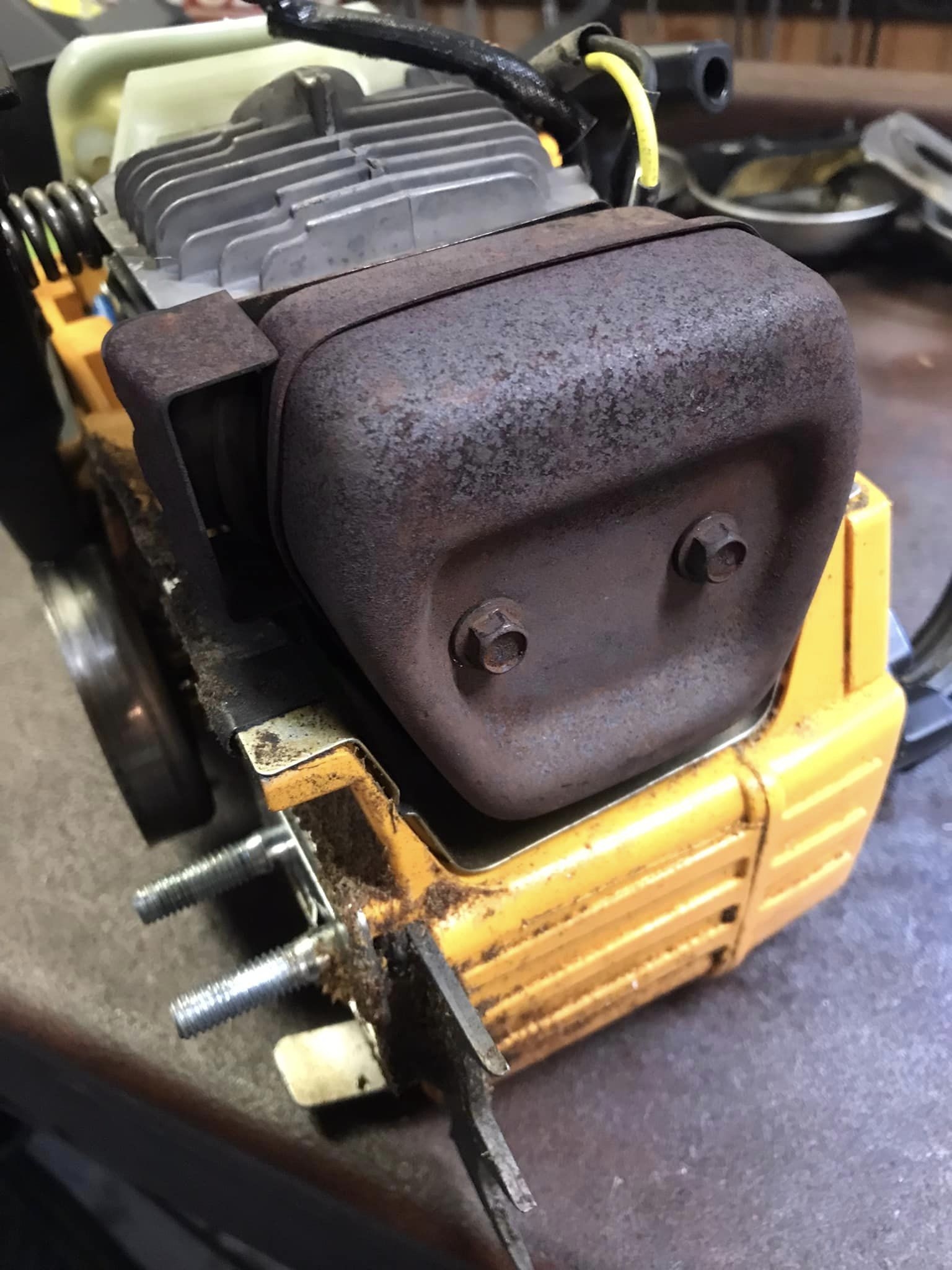

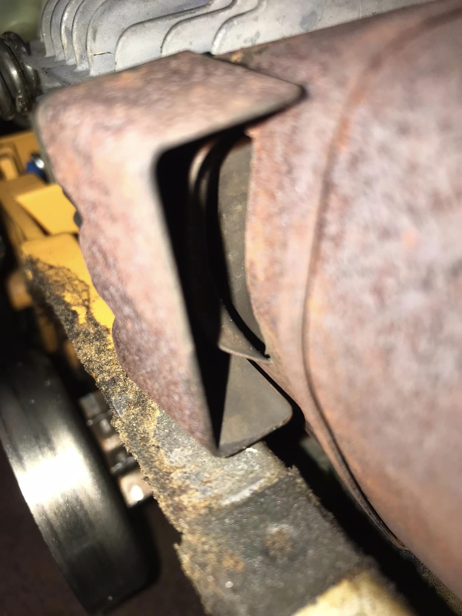

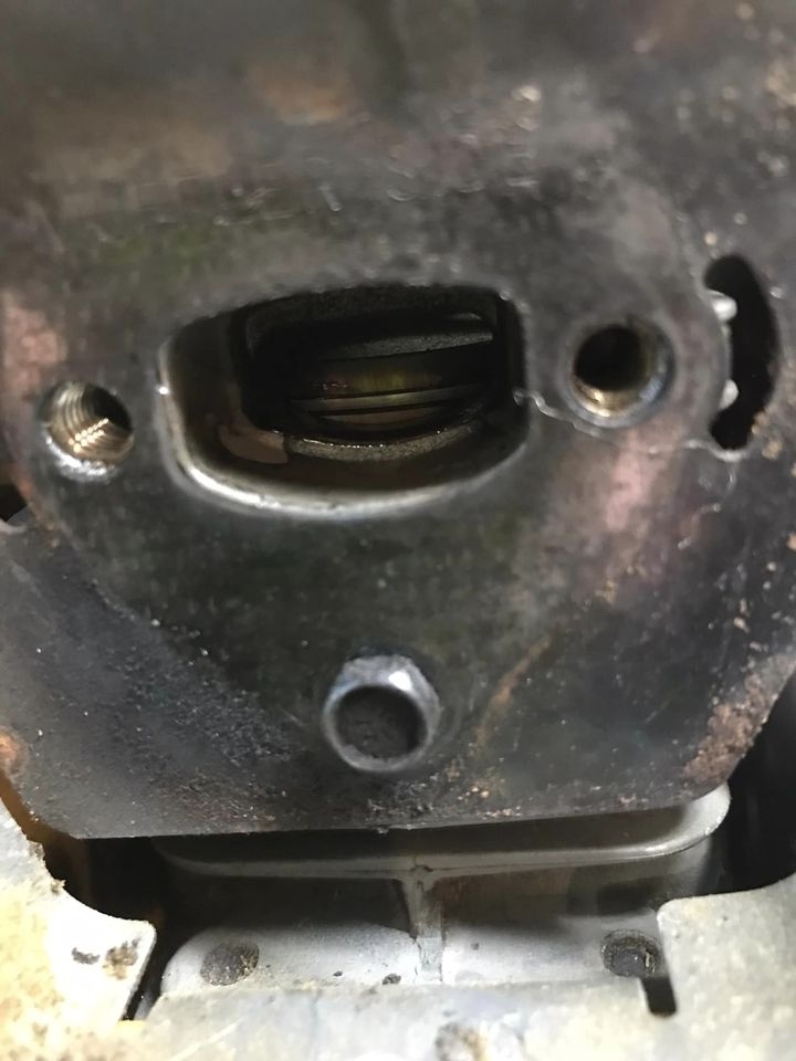

#1,629

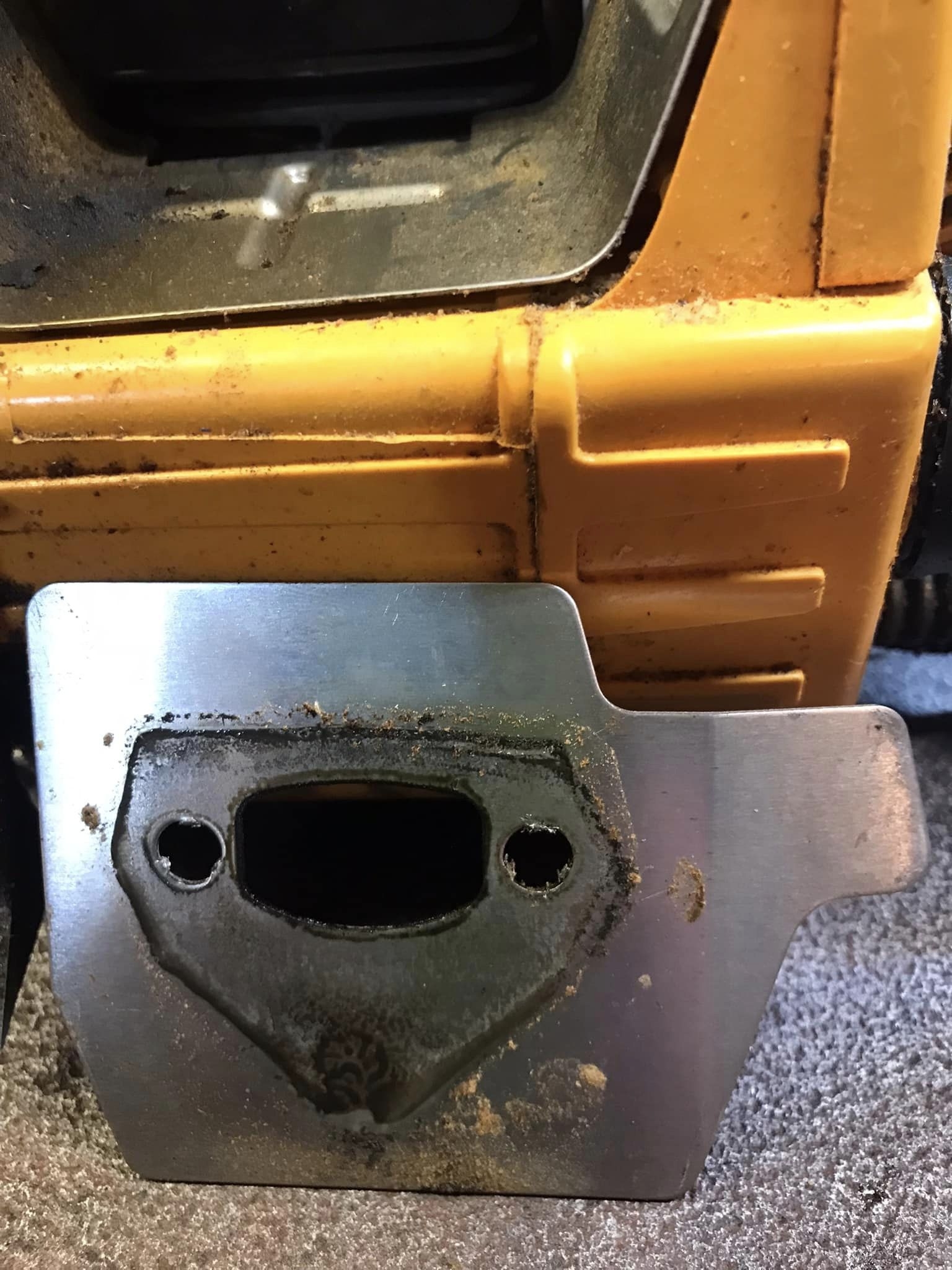

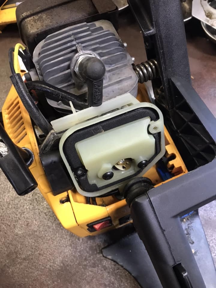

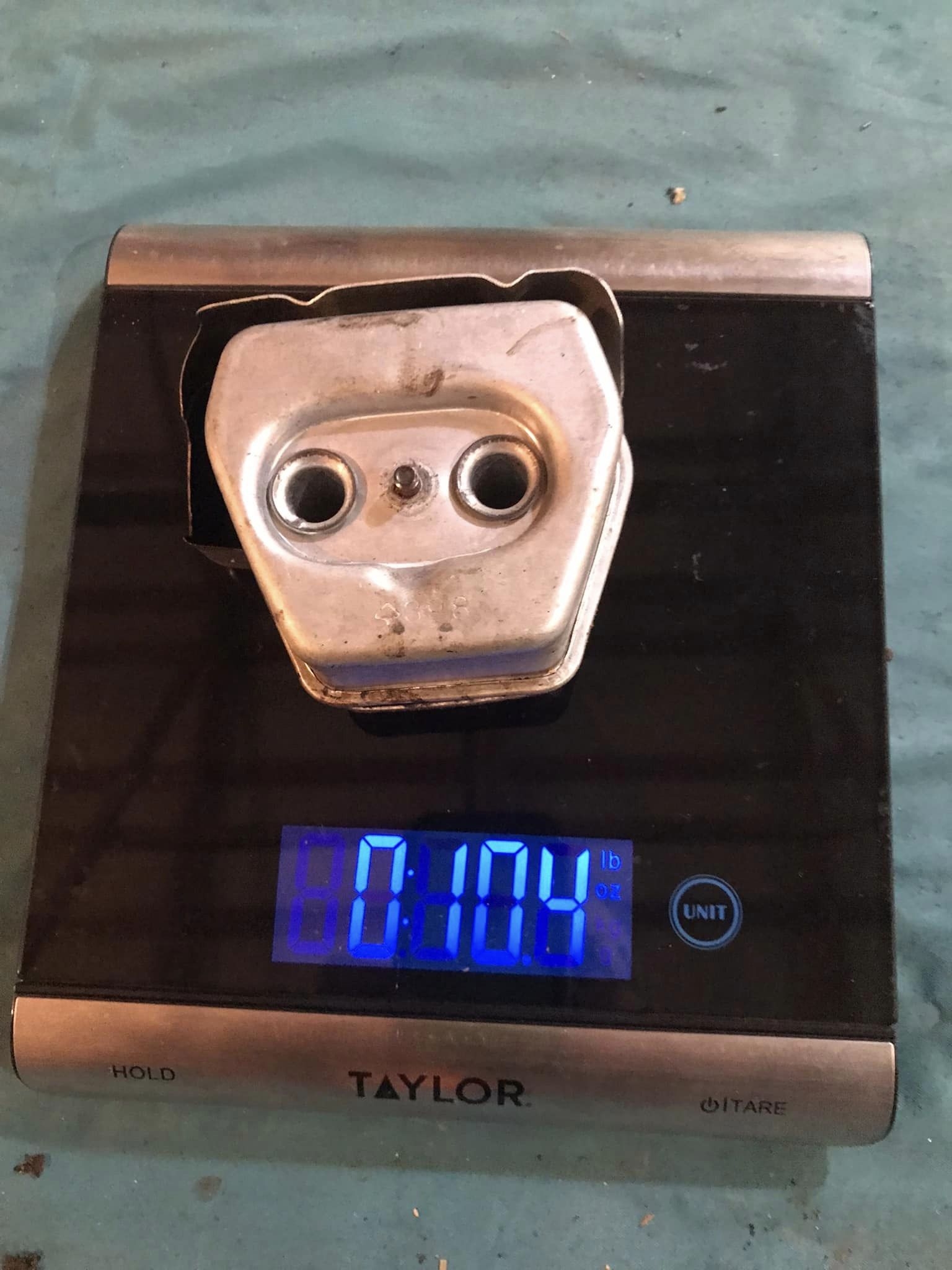

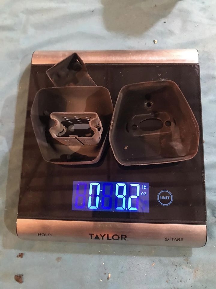

46cc
Like the 2 piece muffler on the 99 2750 better then the newer 1 piece ones. So going on this 2005 295.
Funny how the newer did away with support bolt. Well she is thread and back in this one now.

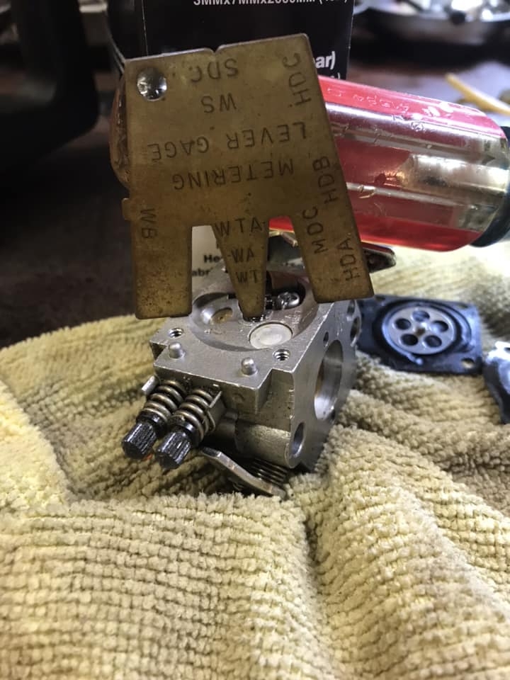

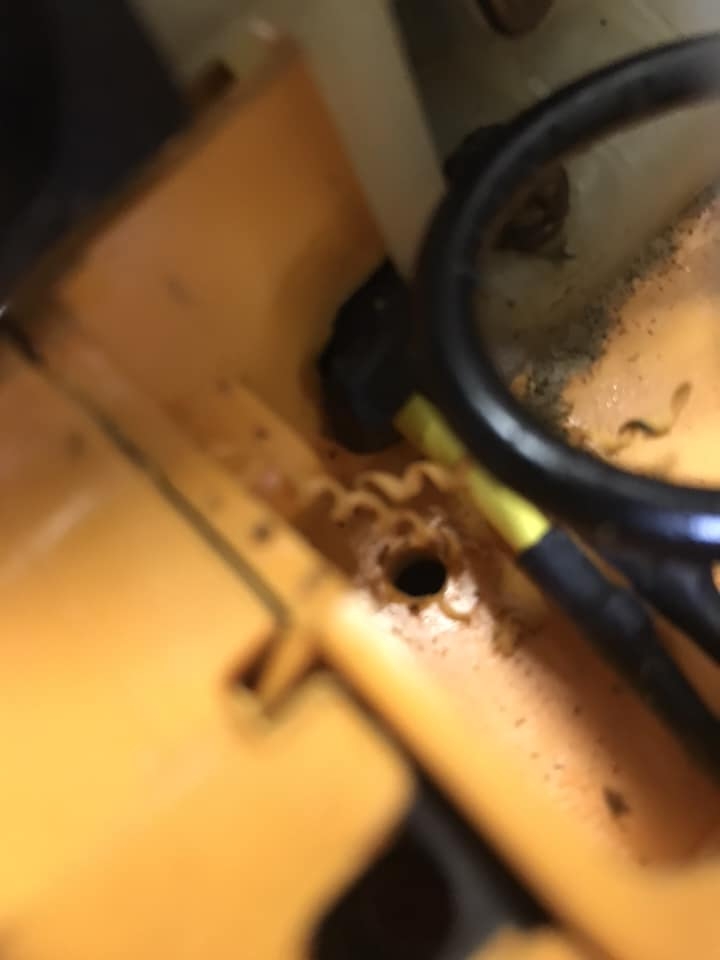

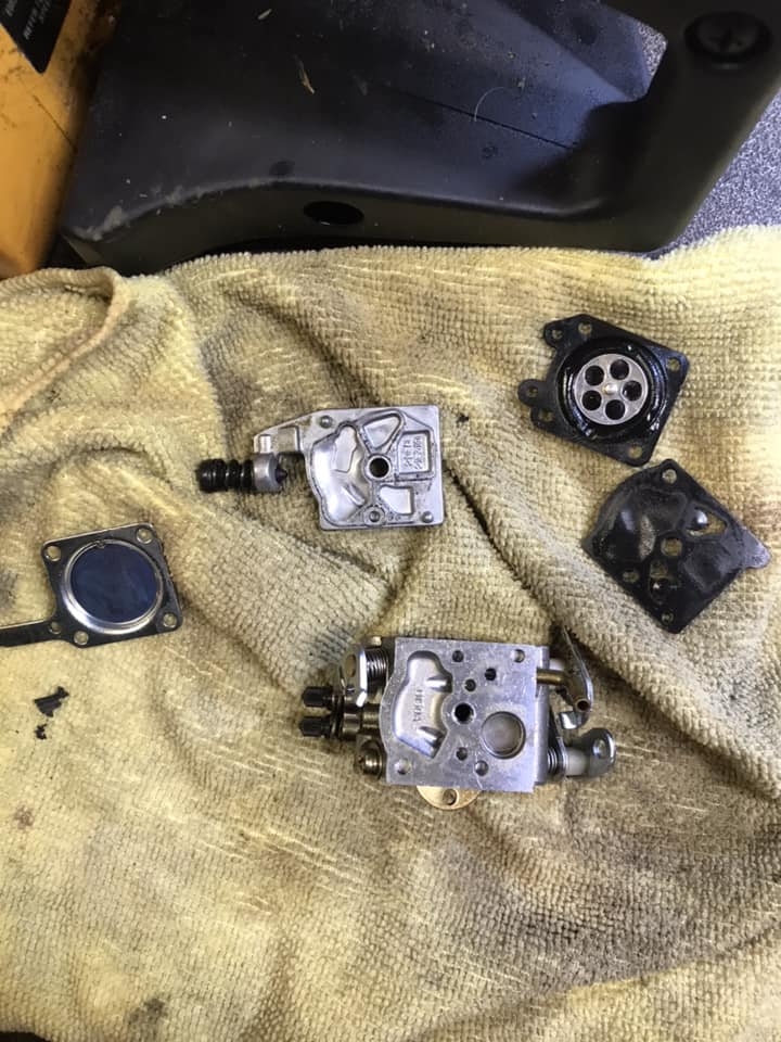

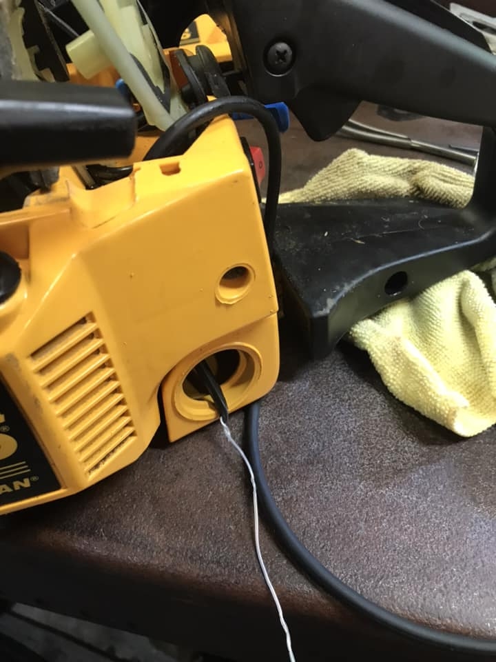

Drill hole run regular 3x5 echo fuel line. Runs after carb rebuild.
When my long curved forceps cant reach the angle cut line at top. I do this.
