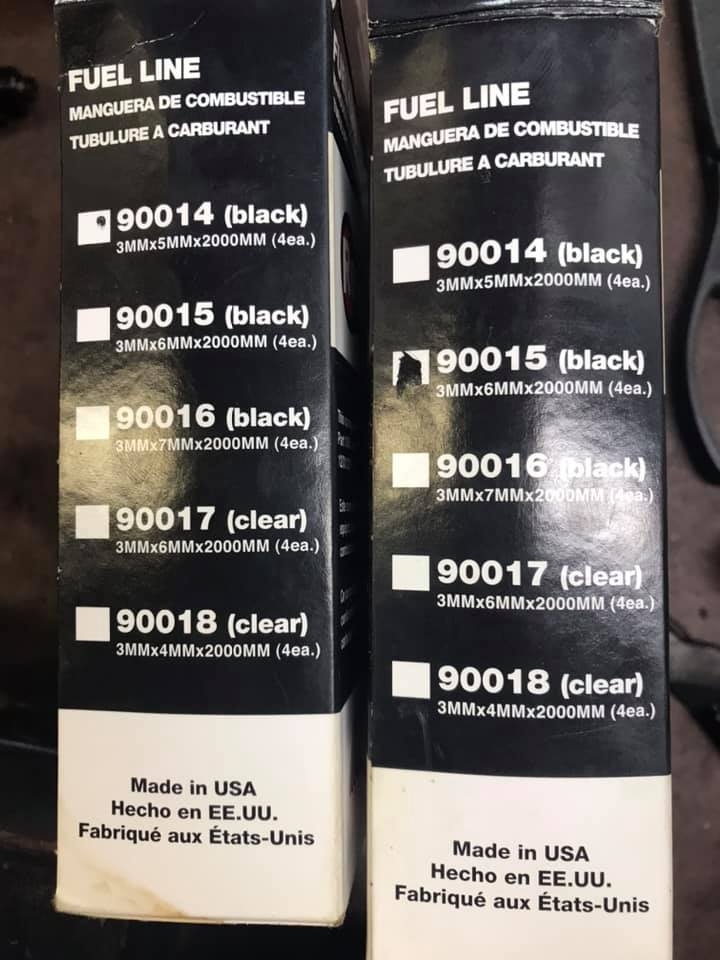

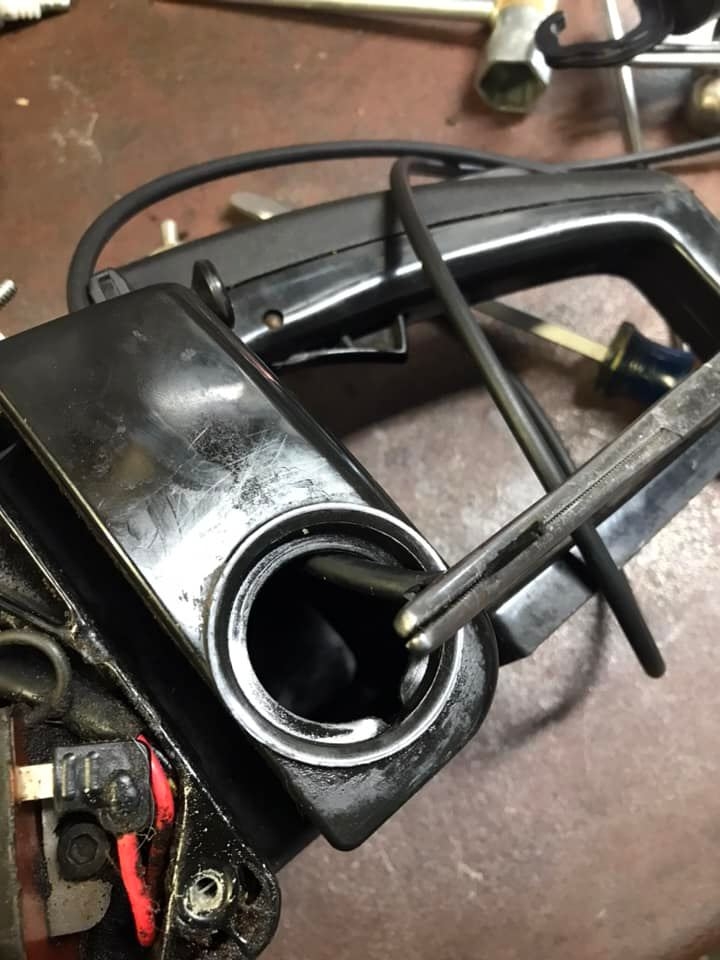

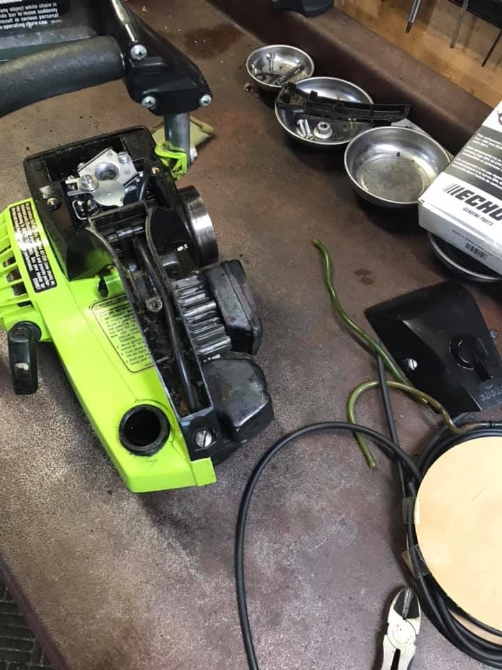

Wow! Is that some sort of a liner inside that yellow tube?
Yep, to try and make last longer against ethanol users. They come rated good for 20% etc etc etc. But IMHO the epa lines are a fail.
I like using OEM echo lines when I can.
I even use it in place of oem molded lines. Saves time and money for owners if that dont mind the switching.

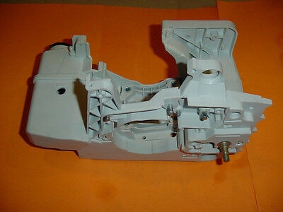

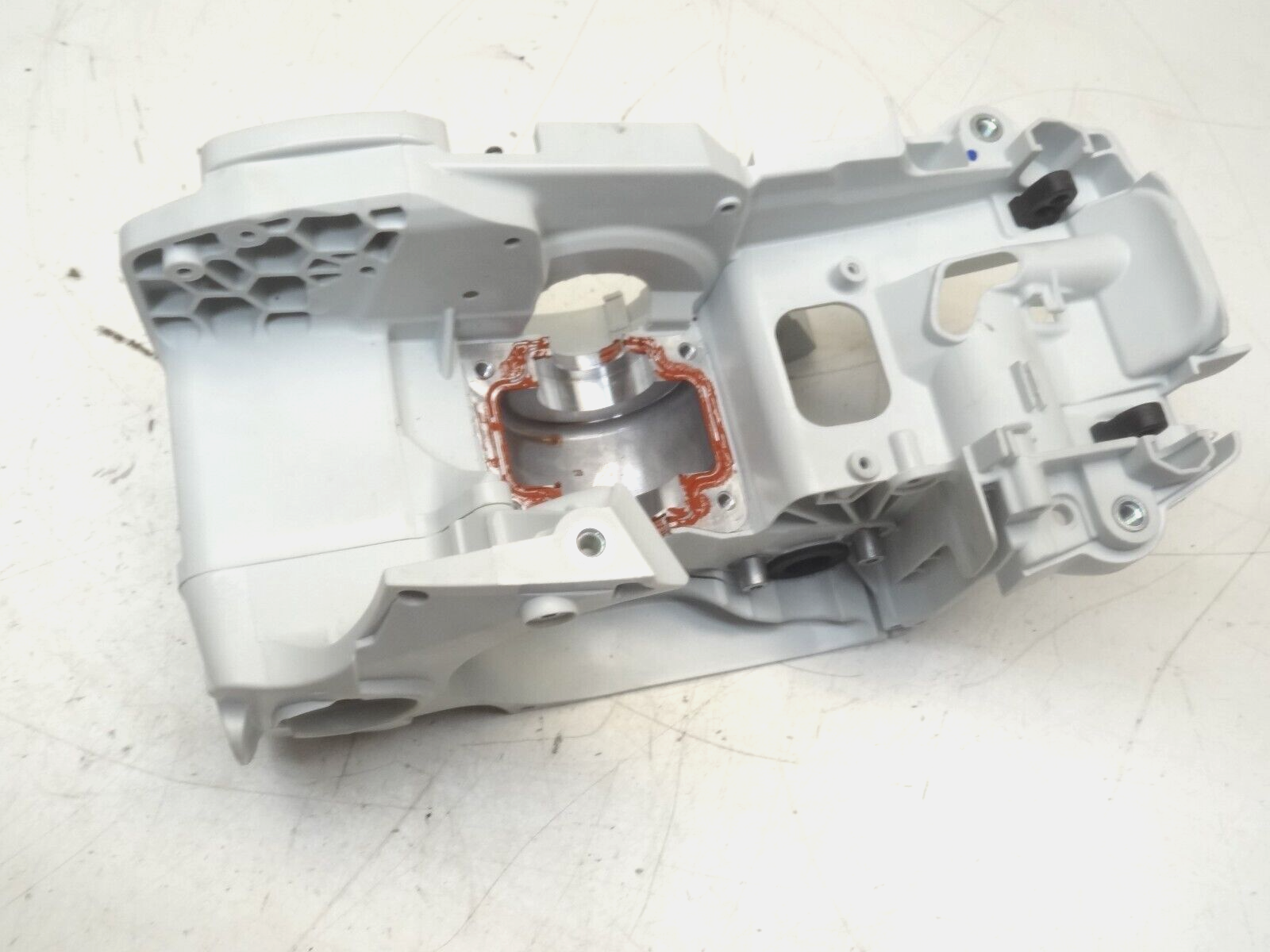

Most stuff is plastic
Then your looking at the cheaper saws. Most Pro grade saws have mag metal crankcases.
Compare showing crankcases. Plastic 290 311. Mag crankcase like a 400 and 036-360.

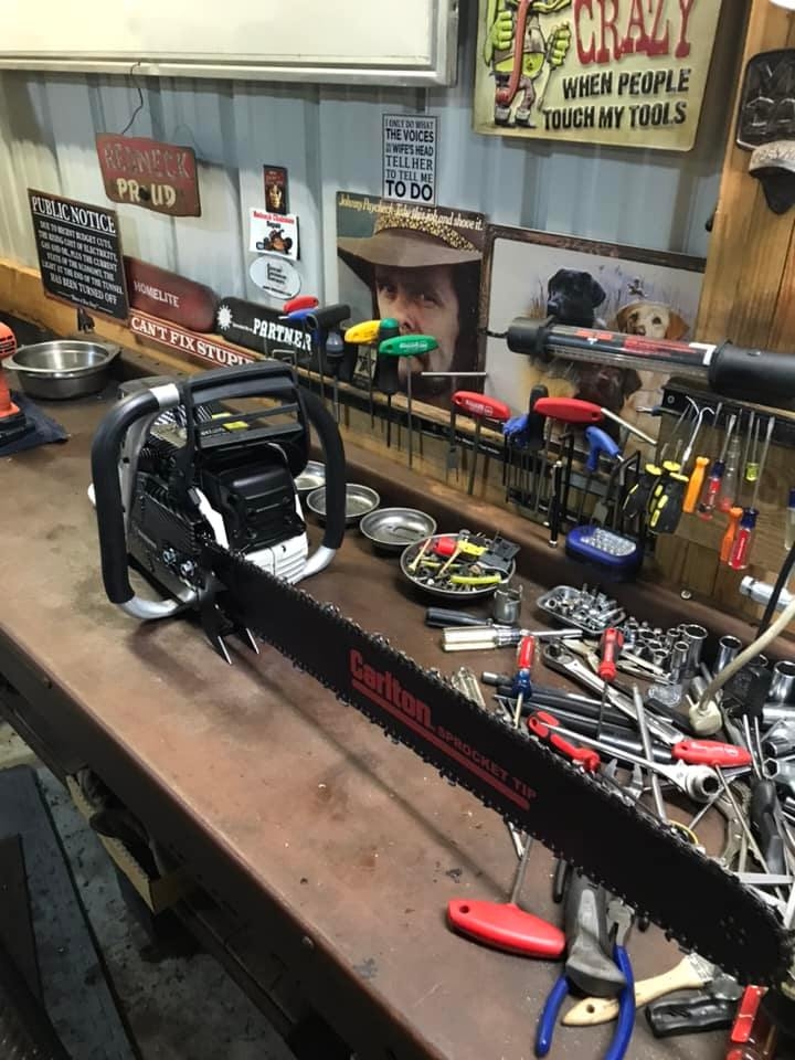

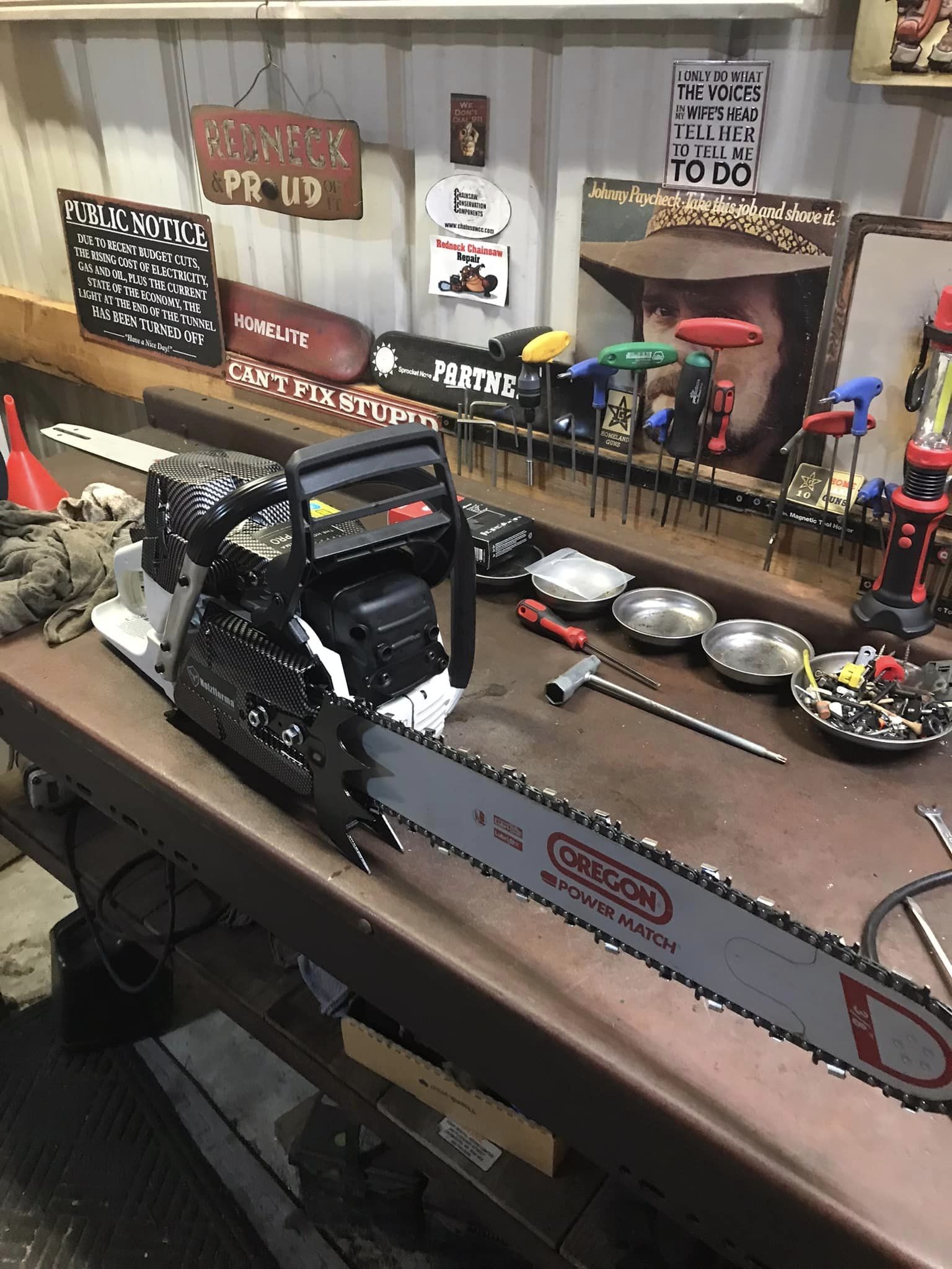

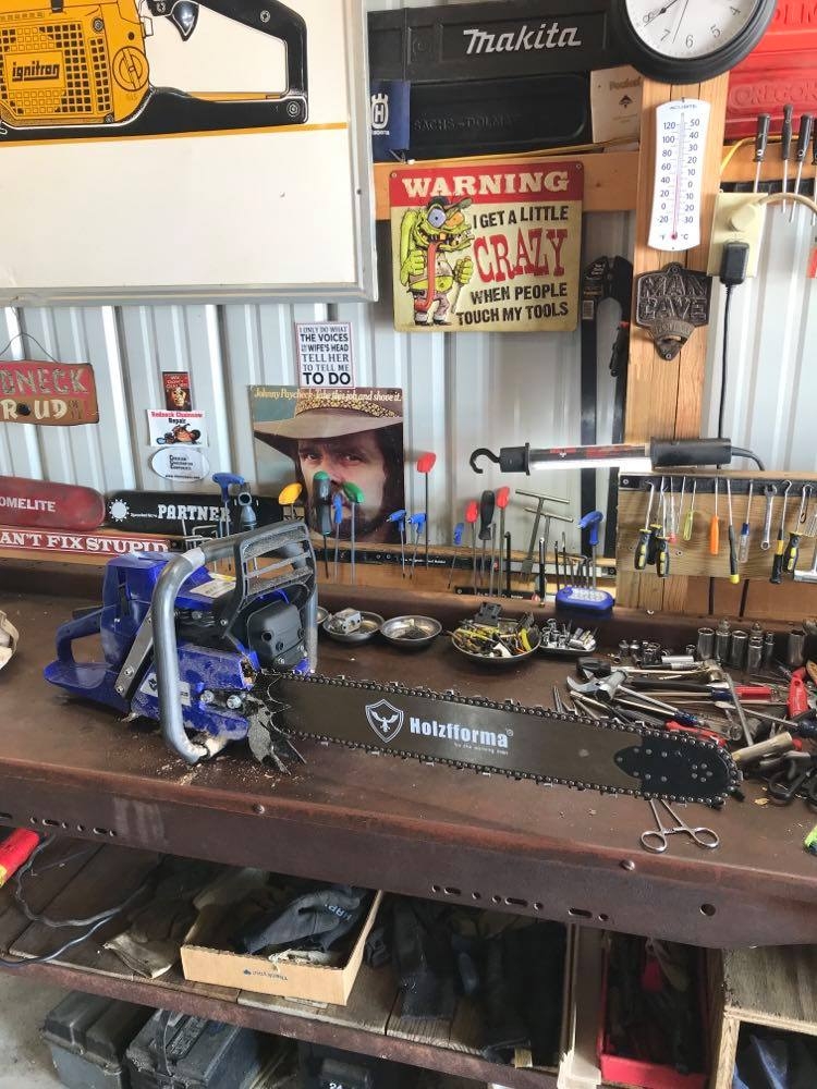

Older local showed up with a unopened Farmertec box yesterday. I had him order it from a trusted dealer I deal with in MT.
So I sold him a bar and got paid labor rate to finish putting together and start and check over and tune.
Well worth the 364 shipped for the G372xp pro ones that come with meteor topends cylinder piston and walbro carb etc.
Fired right up. Easy money.

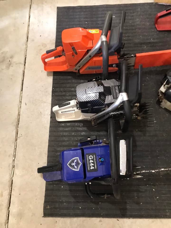

I owned a few of those and the pro version of 372 is the way to go in 372's
OEM OE 372, G372xp pro and G444 440

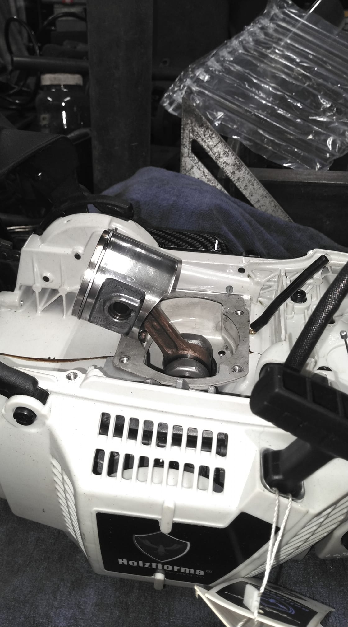

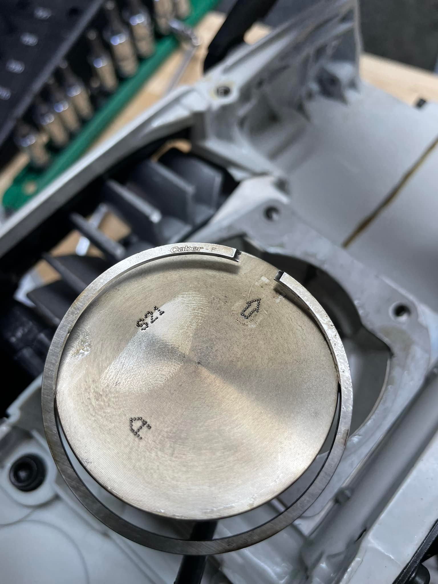

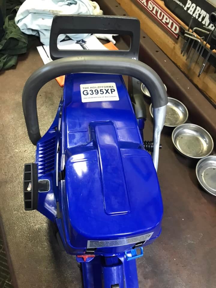

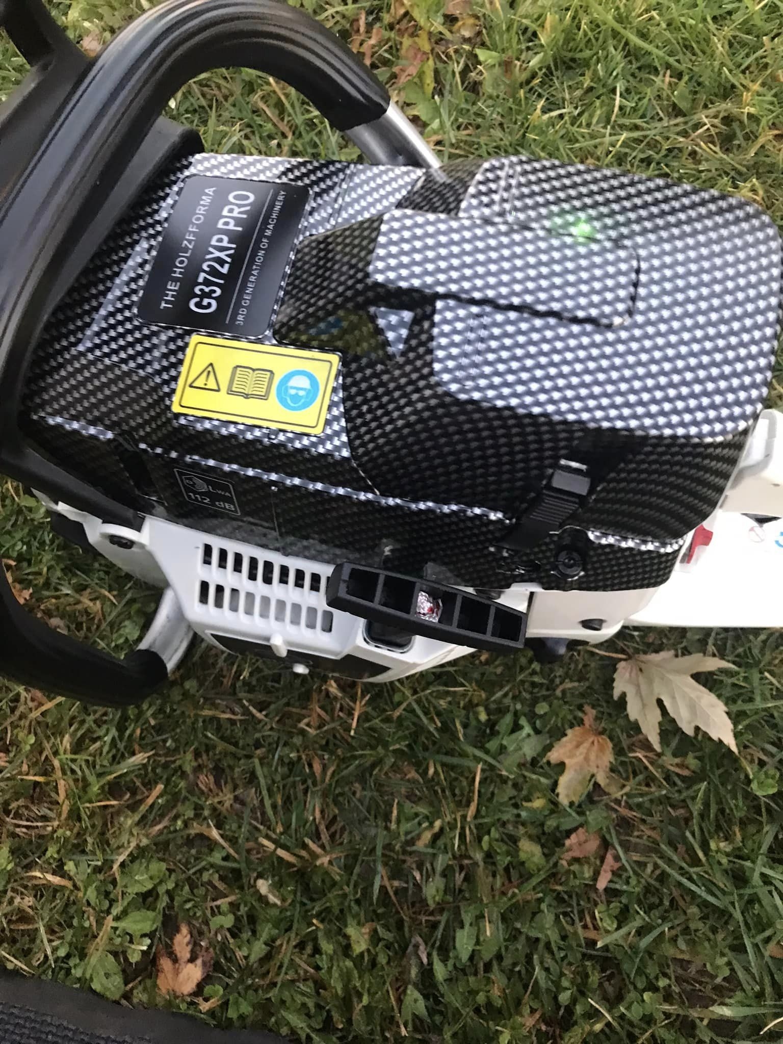

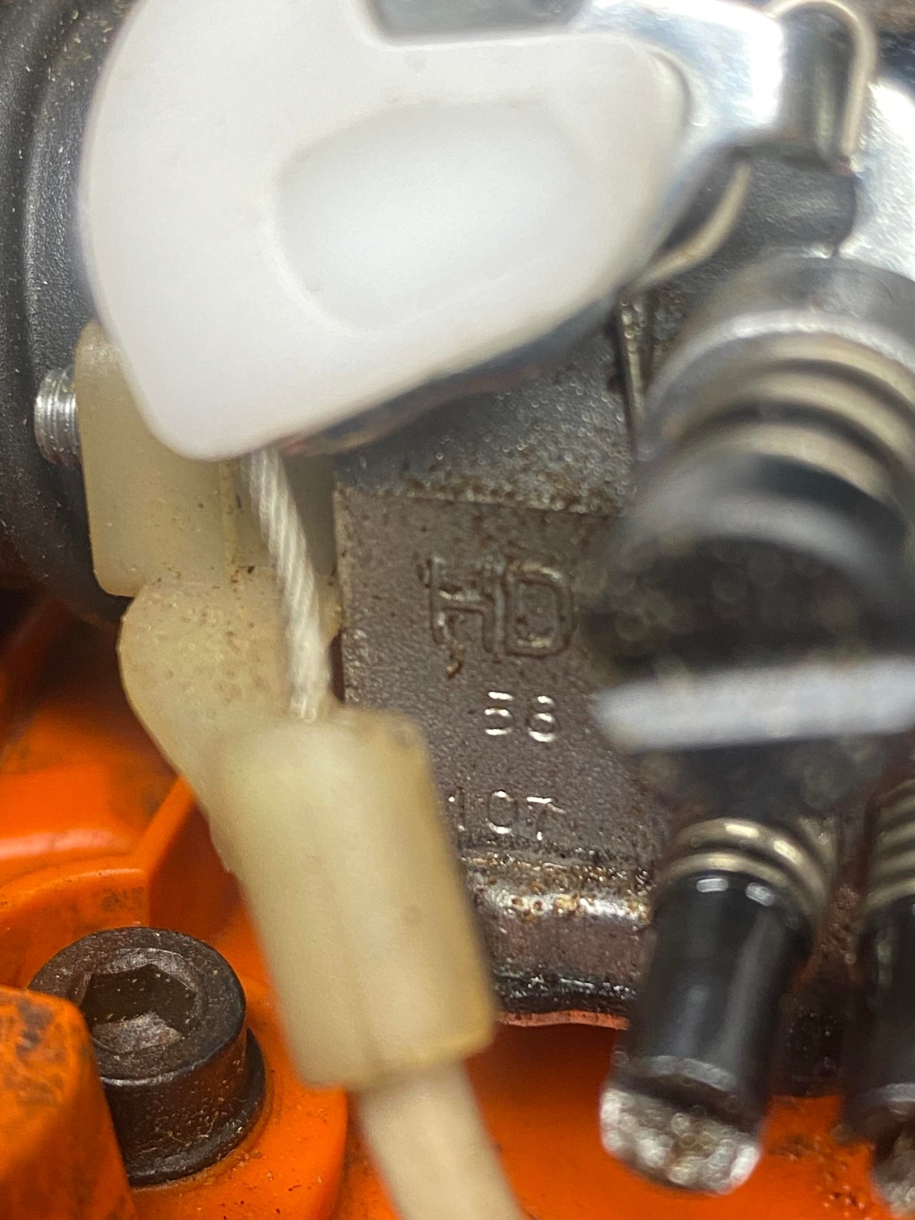

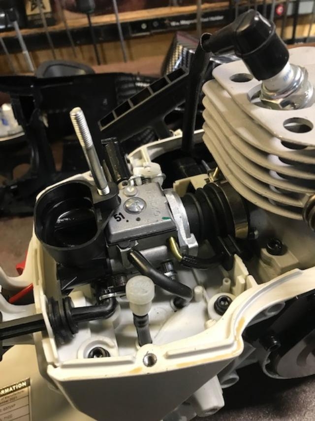

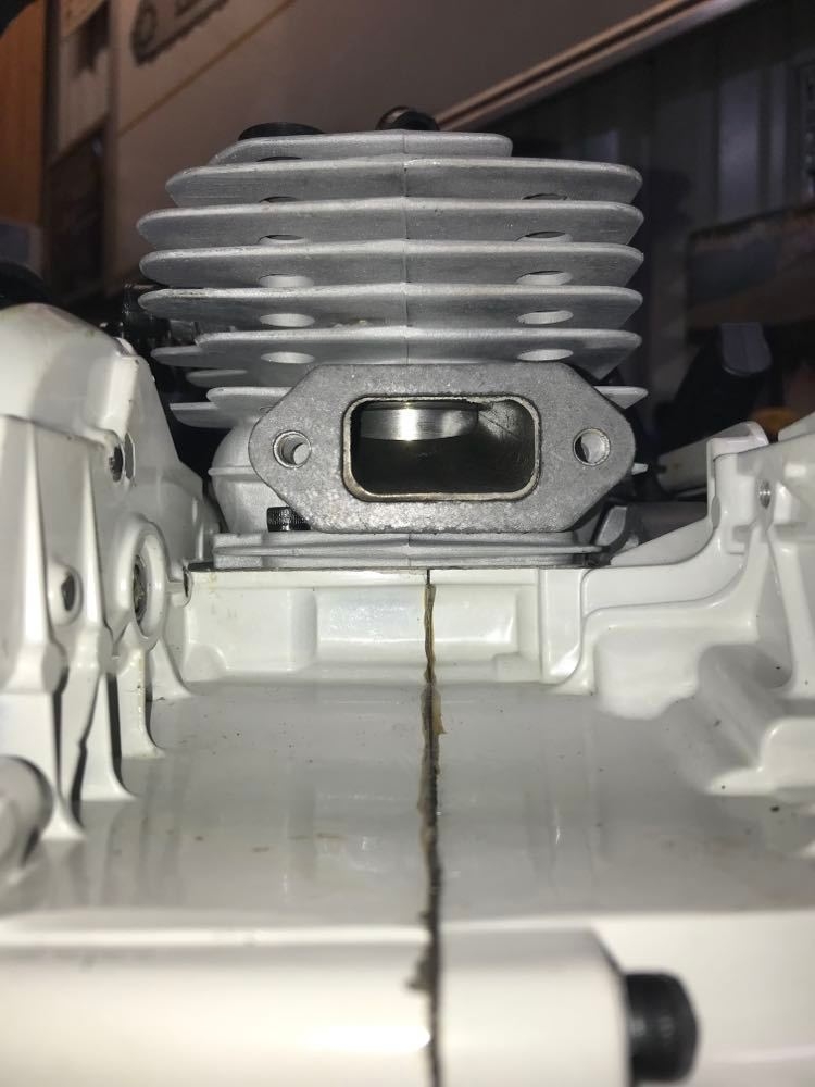

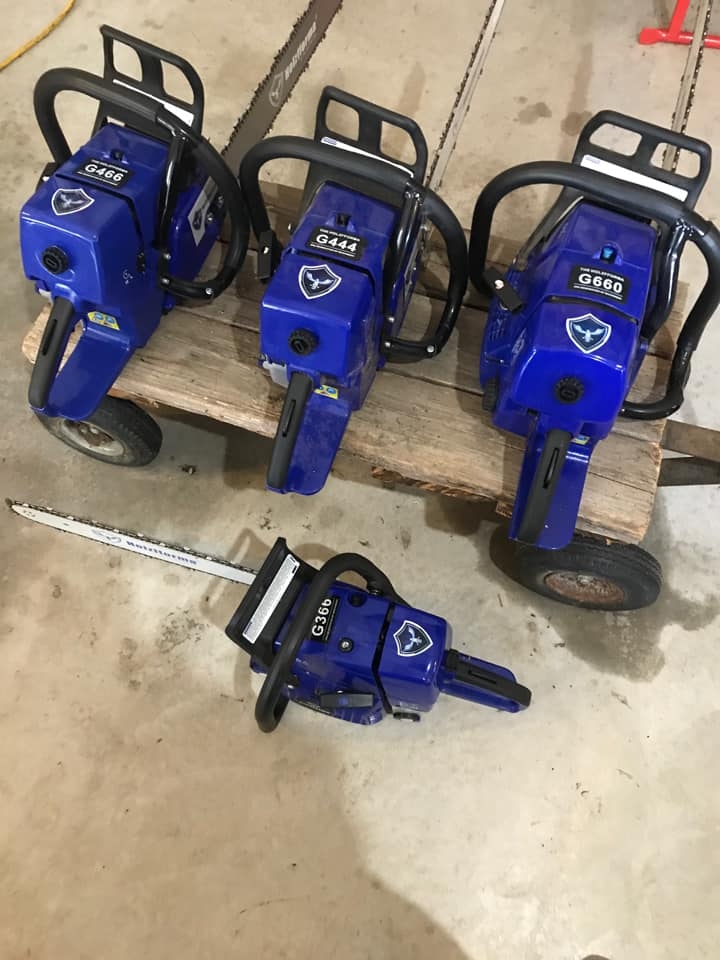

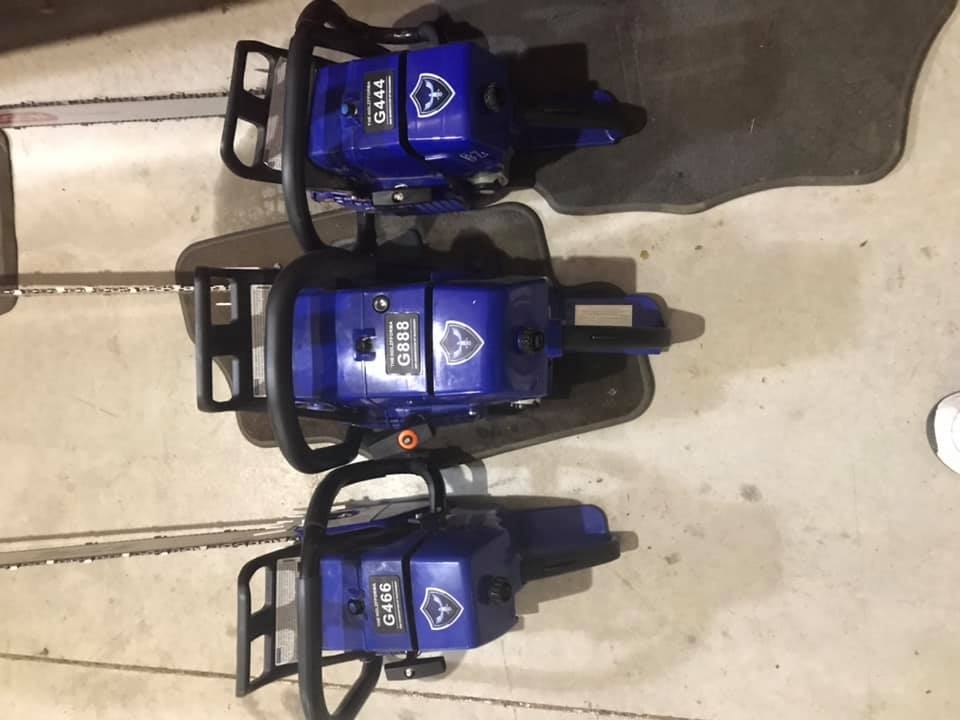

Dealer took one apart to show meteor piston and caber ring. Another of a guy porting one.
Other pics of one I owned till local traded in for it.
