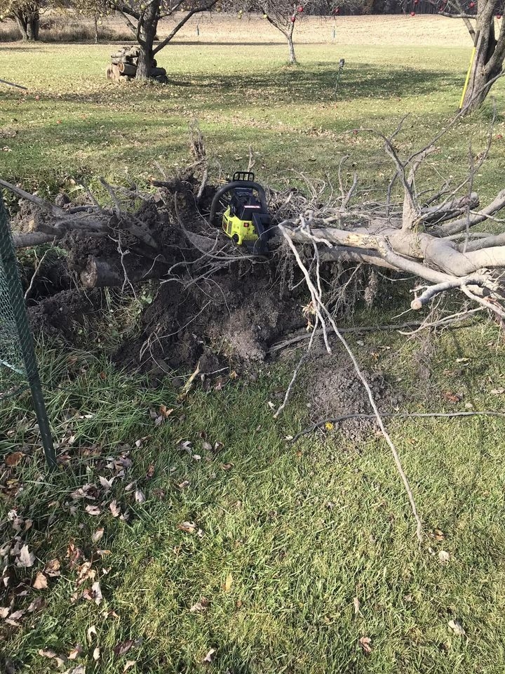

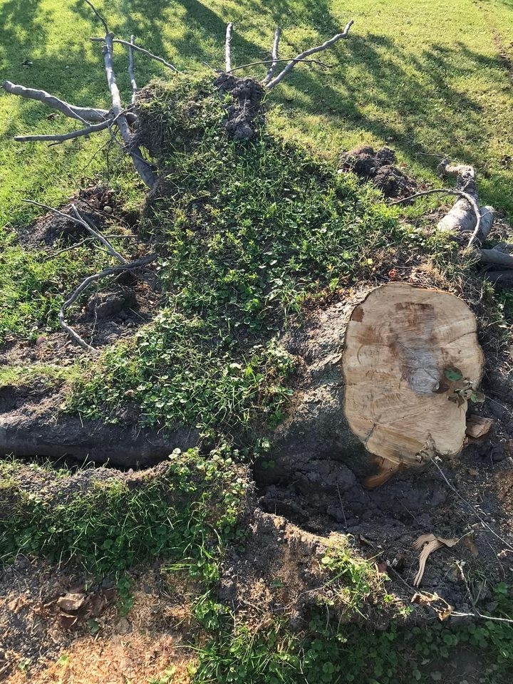

Got that bigger apple roots that went down in tornado in Aug flipped out. Had to wait on corn taking in.
Just used our old envoy xl in 4x4 low since reese hitch still on it and not my plow truck.
Old pos plastic 46cc root cutter was having issues in cut. Running out of mix. Stop cut catch up do it again. That told me stiff diaphragms.
Also fines in screen inside carb from past owner running without fuel filter few years ago.
1994 plastic 46cc saw like a stihl 025 250 in cut and weight but can be bought for nothing almost. But has air injection.
They come in chrome bore or bare bores too. Depending on model.
Common walbro wt carb kit and couldn't believe I was out of the dias it used on both sides. So ordered a bunch of kits.

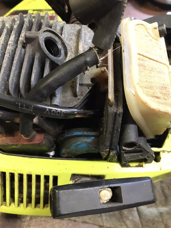

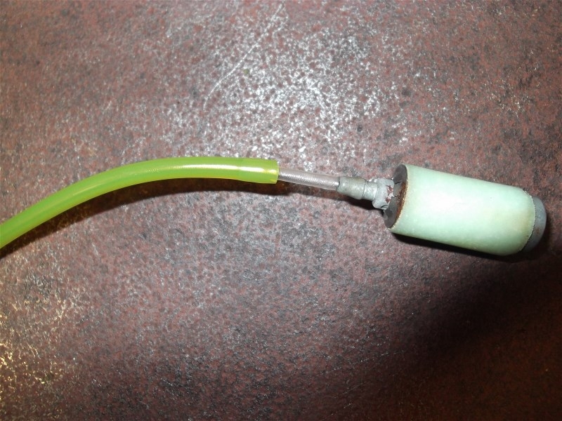

Just done one of those again other day. The newer PR5020 all black
Everyone I have had in and mine was tuned wrong. Most cheap saws are I have noticed.
Normal is carb is out of wack tune from get go. Fuel lines are epa crap and come apart and allow fines to clog carb inside.
I bought the PP5020 when first come out in 2013 for 169 shipped to my door. Early version all yellow.
Few of the epa line fails.

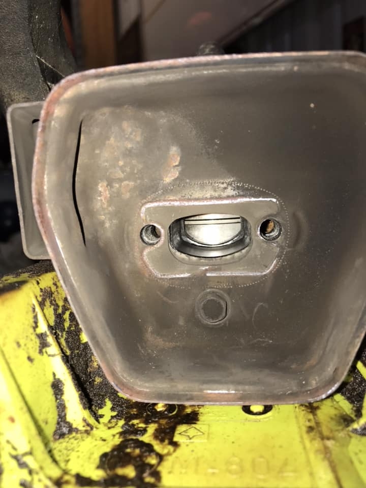

View attachment 831020View attachment 831021
Wow! Is that some sort of a liner inside that yellow tube?
