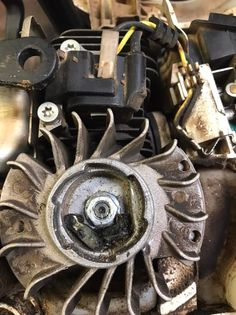

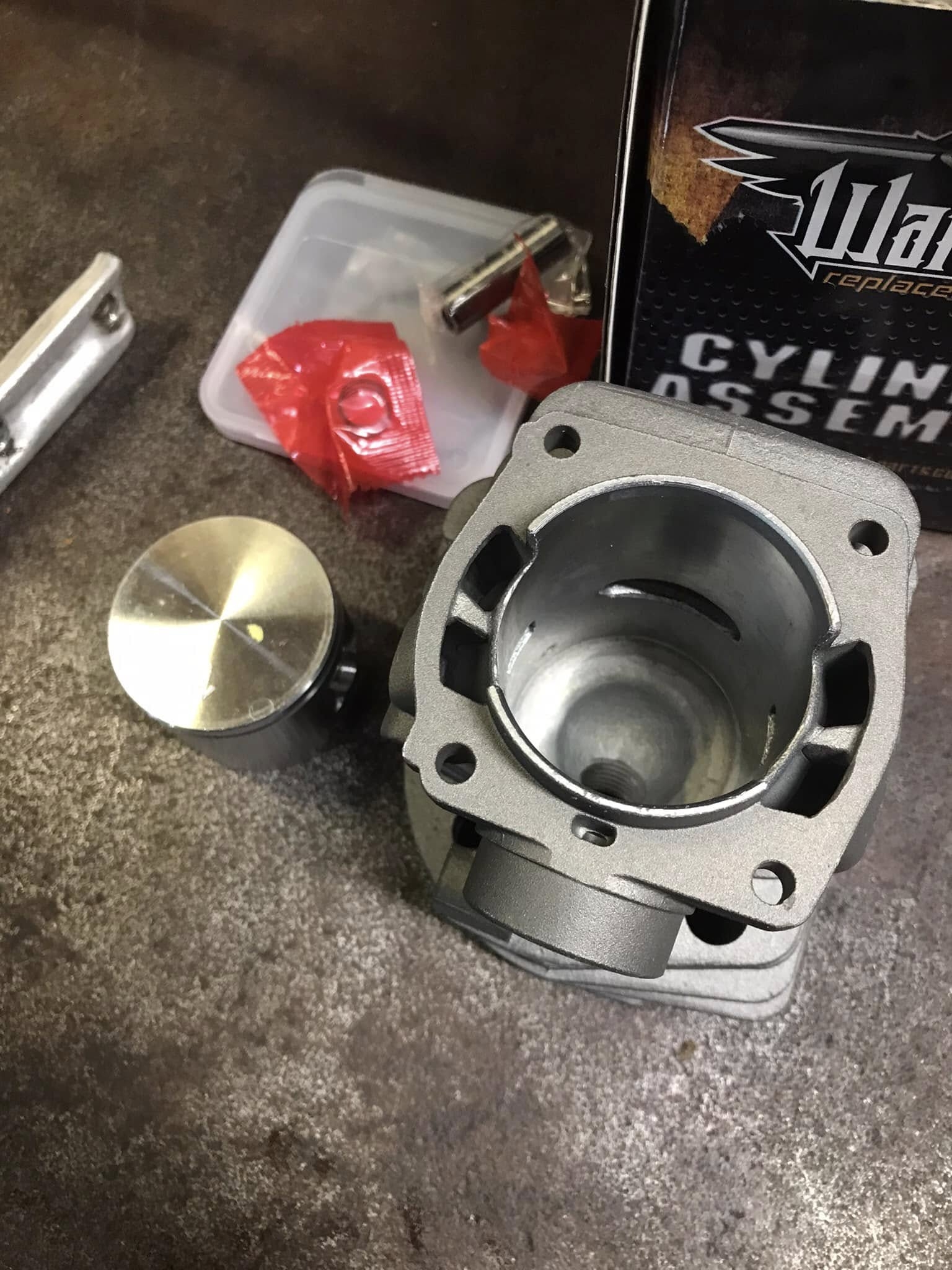

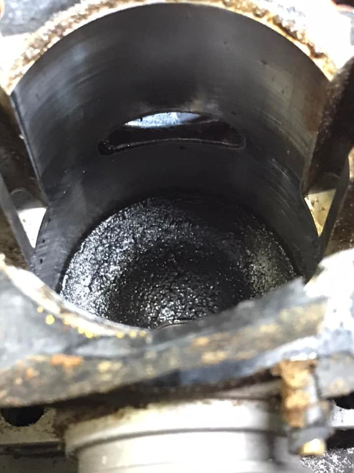

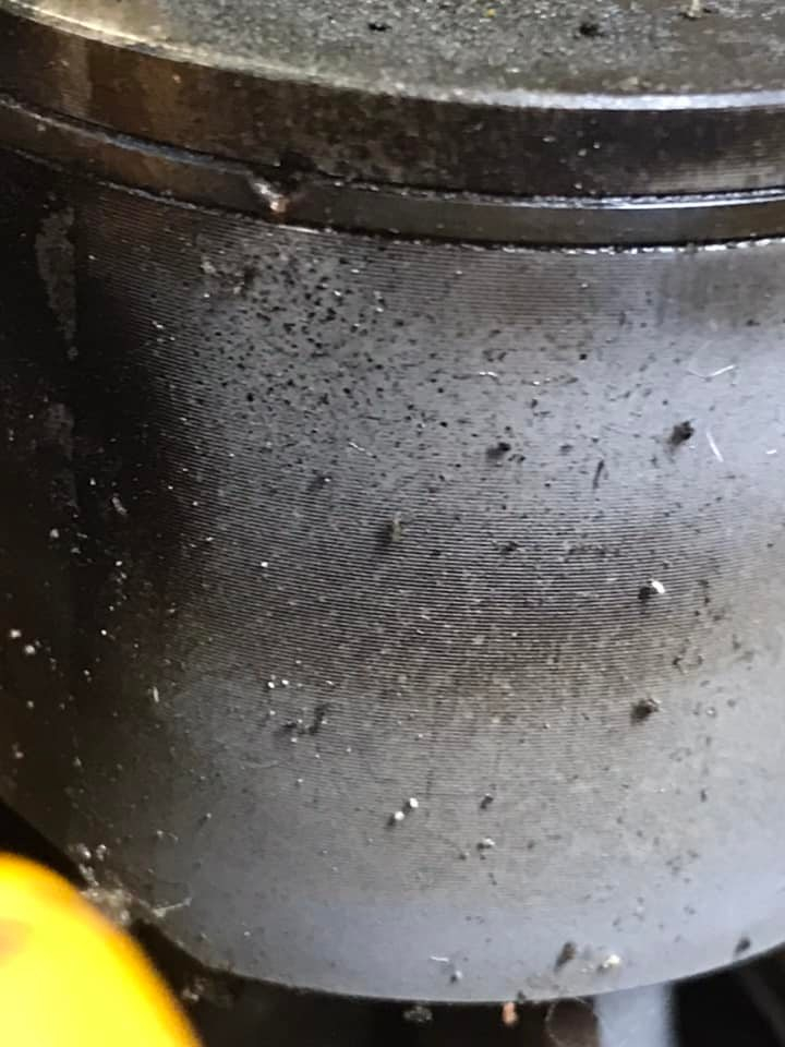

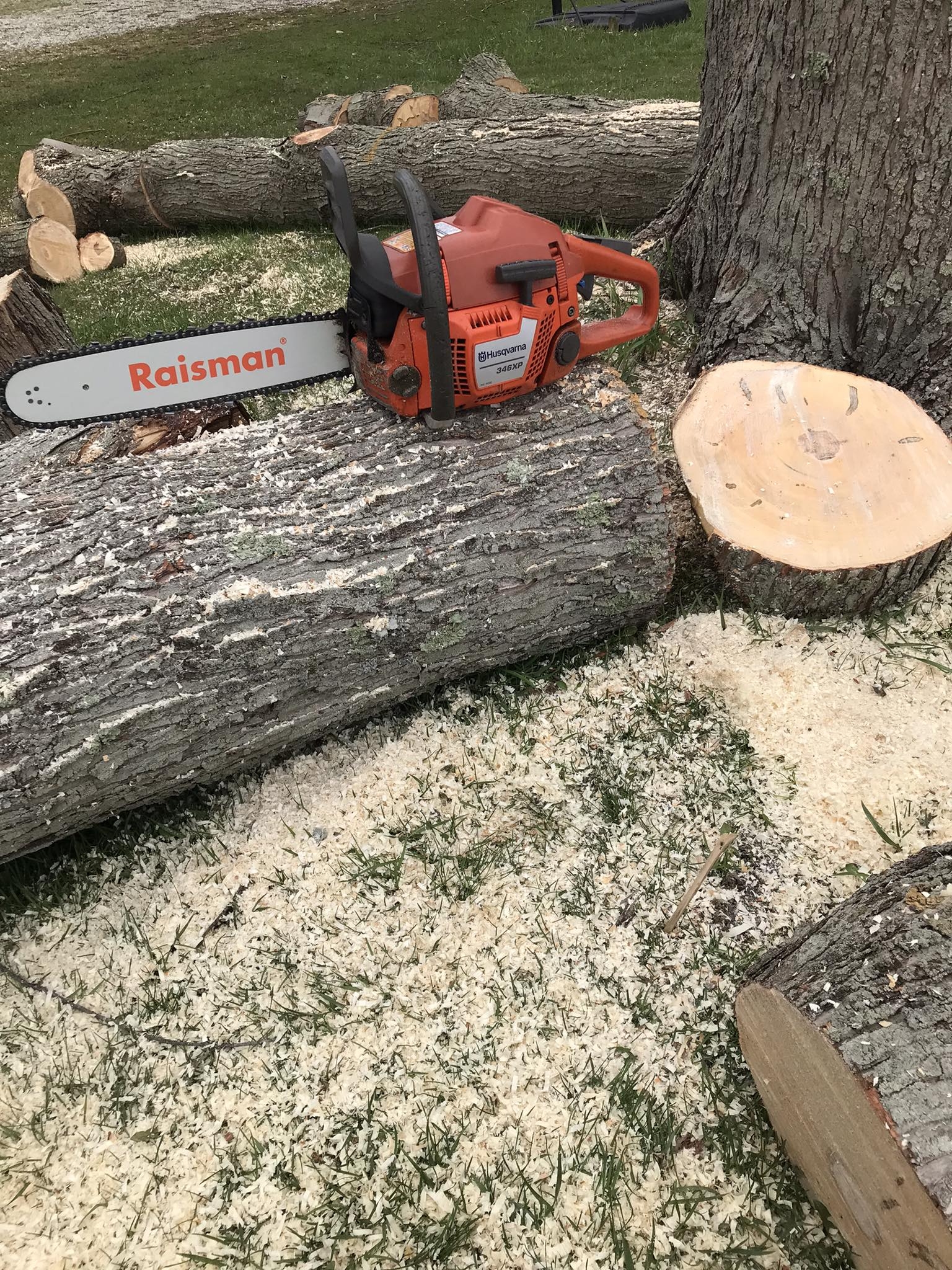

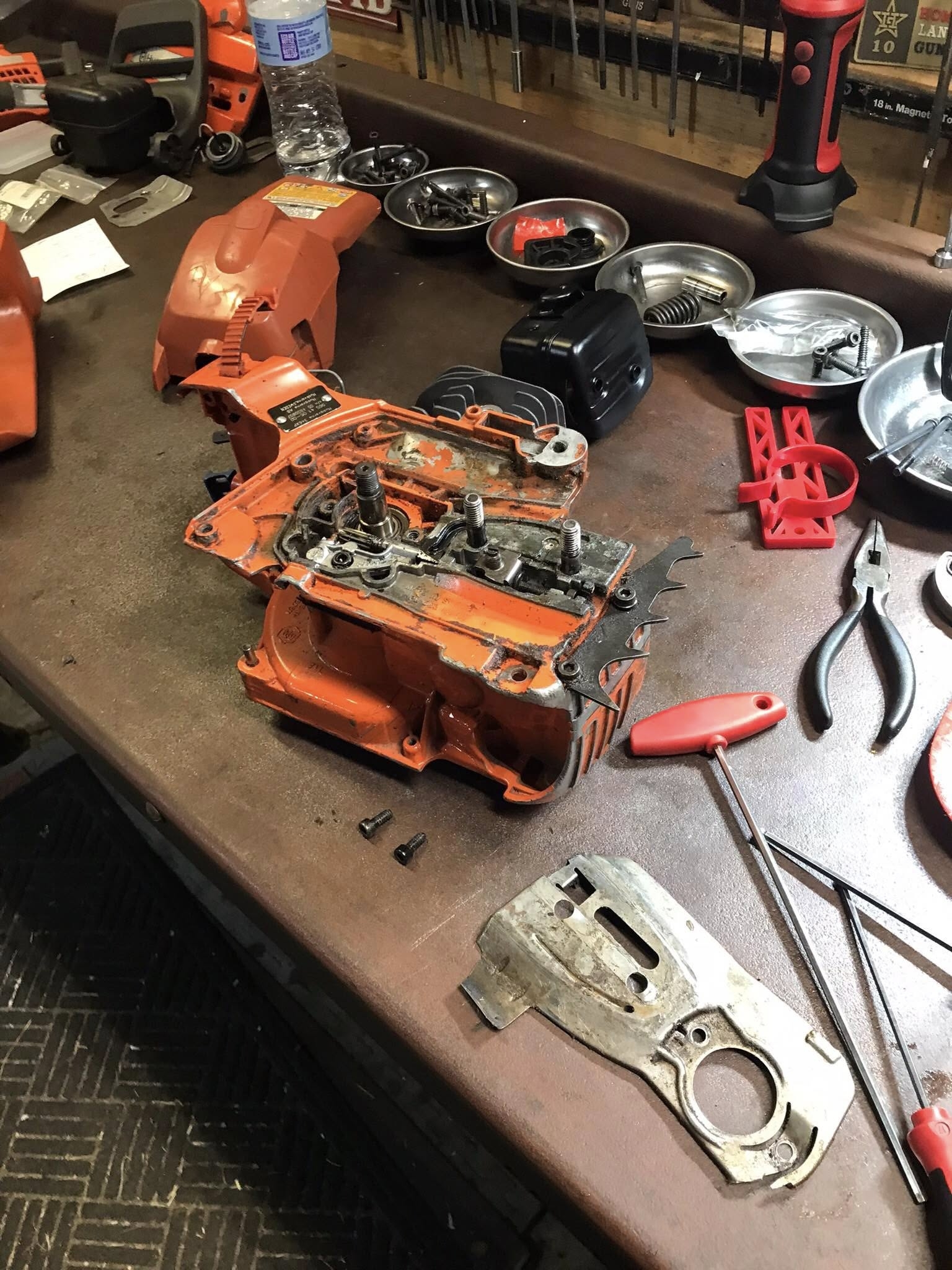

@JeepHead I'll let everyone know in my group and you here. But some day there is going to be a clone of the 346/353. ;)
Not that I care anymore being I love my echo 501's etc. I'm all set now.
But will make it easier for guy to get parts etc.
It was a PITA to find stuff on that project packrat 346 OE. It is running a aftermarket 44.3mm topend on it testing. Only off of oem time wise by about 10%
If I didnt know it anyone would be happy. Another guy ported one and said they port up good too.
View attachment 3854700View attachment 3854701View attachment 3854702

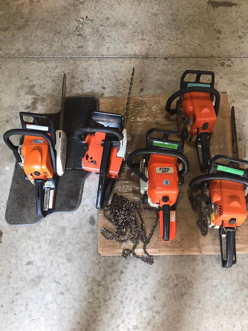

Yep several guys waiting.
Just top covers etc alone is drying up and people want stupid prices for parts. Let alone a whole oem saw now days.
I used to buy new ones cheaper then guys selling new ones for now days.
Case in point 2 I bought new in NE 50cc.
/ Just another junk chainsaw #2,583
View attachment 3854732View attachment 3854733

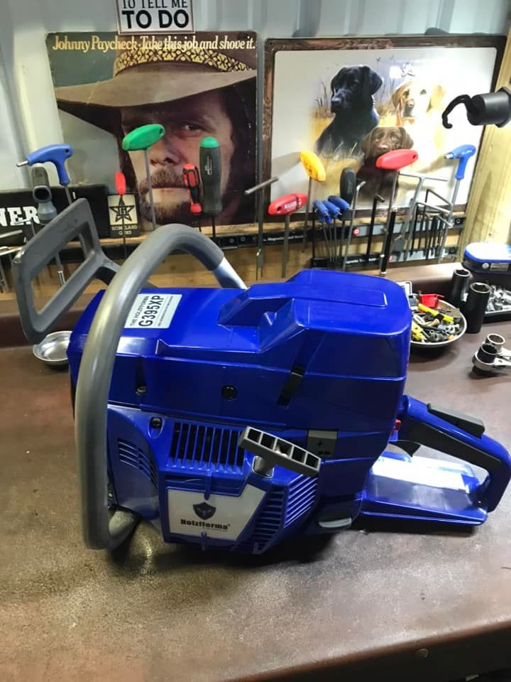

Thats what he was showing in steps before adding a H to the carb to turn it down. The plug at end is after riching it up.
14 without a H side is lean.
12.3 was getting close on my oem one way back without H and unlimited coil. To being lean.
I'm watching mine G3120 clone now to see where it goes. I put a unlimited G395 coil in it to test out with stock no H carb.
I have a H side clone carb too if it is needed.

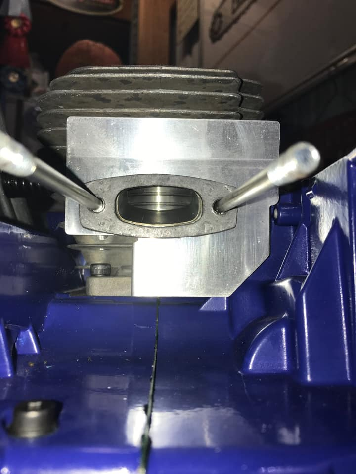

I’ve come up with 3 ways to run a spark screen on the Egan pipe for 2511.
One I like is done like PSS V2 screen in my 2511 cnc muffler.
Other way is outer with a clamp. John can show that style he does.
The other idea I was thinking on was at base of pipe. But didn’t know if spark screens should be between the pipe and exhaust outlet. Any feedback on that way?
Jason
I only did this to show for the guys that want the Egan pipe gains but have to run a screen in some areas.
