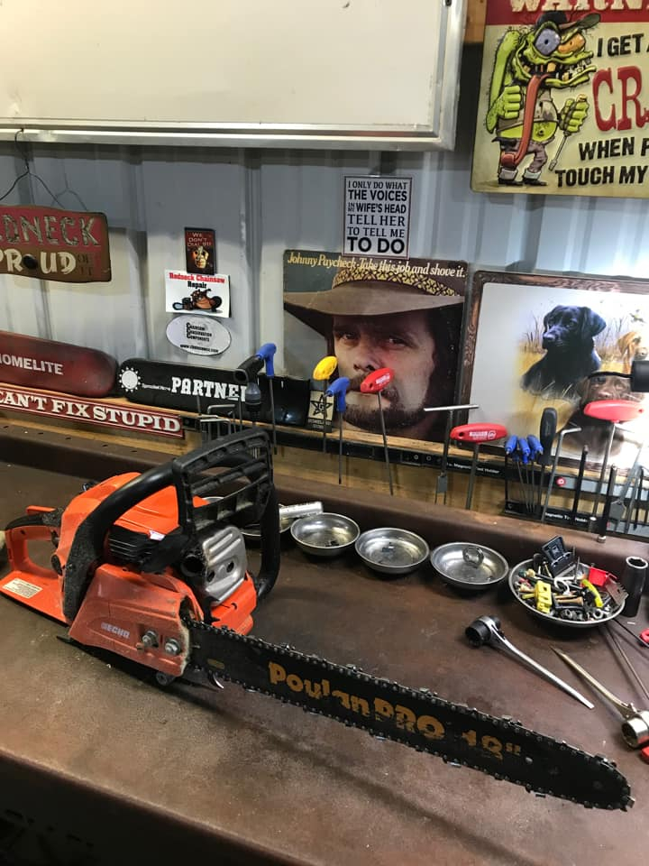

Isn't a good one made that dont jump off when idling etc. I use 2 different size OEM stihl ones made. IMHO
My echo other day with caps off tuning I noticed the outer on the H had splines too. So tossed the screwdriver and grabbed my spline tool. Easy peasy then.
One on left worked 4mm 21 spline. One in middle OEM husky 5mm. Right Pacman style.

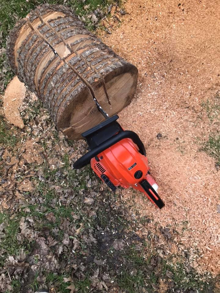

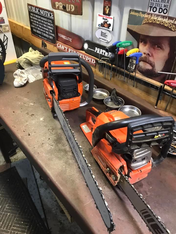

Muffler testing wood picked out for oem and clone.
Pipe, 2 cnc mufflers from different makers and the open clone.
Going to use Oregon nano 325 set ups on oem 2511 PN and clone Farmertec G2511
This vmodest 2511 just used to check it.
1/4” mini fruit tree pruner saw.
9x8 and it's 9 down.

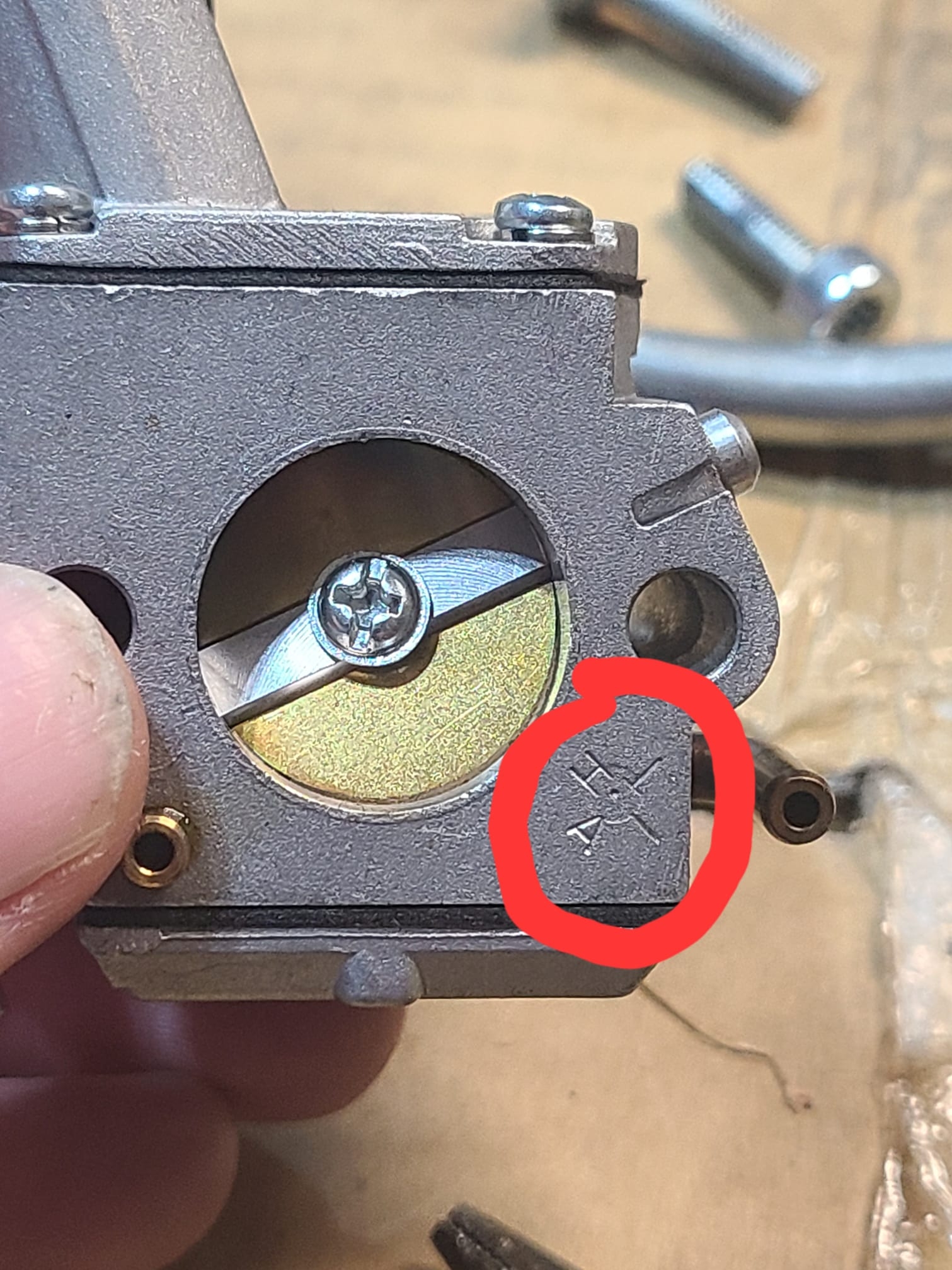

Walbro carbs on the Farmertec China clone saws
I always figured they were made at the China walbro plant.
Dealer contacted Walbro = We have contacted walbro and verified in fact that the carburetors are made by walbro. By a marking on the carb they could tell me what plant they where made in. The 660 and 372 carbs are made in Thailand for the china market. So I would assume the rest are made in the Thailand walbro factory.
/ Just another junk chainsaw
#2,550
Dealer = Just pulled the walbro carb off the new g366 pro and it has the same markings indicating it is made also in the Thailand plant.
Carb pic with marking
/ Just another junk chainsaw #2,551
Can you even imagine the mind numbing experience of building those things all day, every day and having them sold for less than $20 on the internet market?
