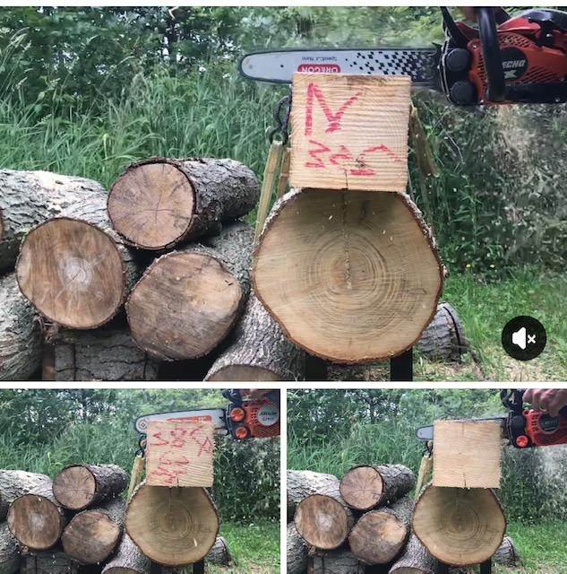

Shows around 3pm this rain might slow up so I can film. 2511 muffler testing.
Putting new loop on oem one first.
Need to flip log around. Noticed to much variations in the end piece for first 3 mufflers if did 3 cuts each. Other end was close for way longer length.

@JeepHead Egan pipe was way ahead of rest. PSS V2 was next and reminded me of the egan in acting and sound etc. WSC was last on the OEM. Only one it would have beat was the stuffed up OEM stock muffler.
So on clone 2511 I only tested the open clone muffler with small pipe and compared to egan pipe to see.

Clone 2511 with egan pipe v/s clone open small pipe. Egan was 2.3 sec faster per cut.

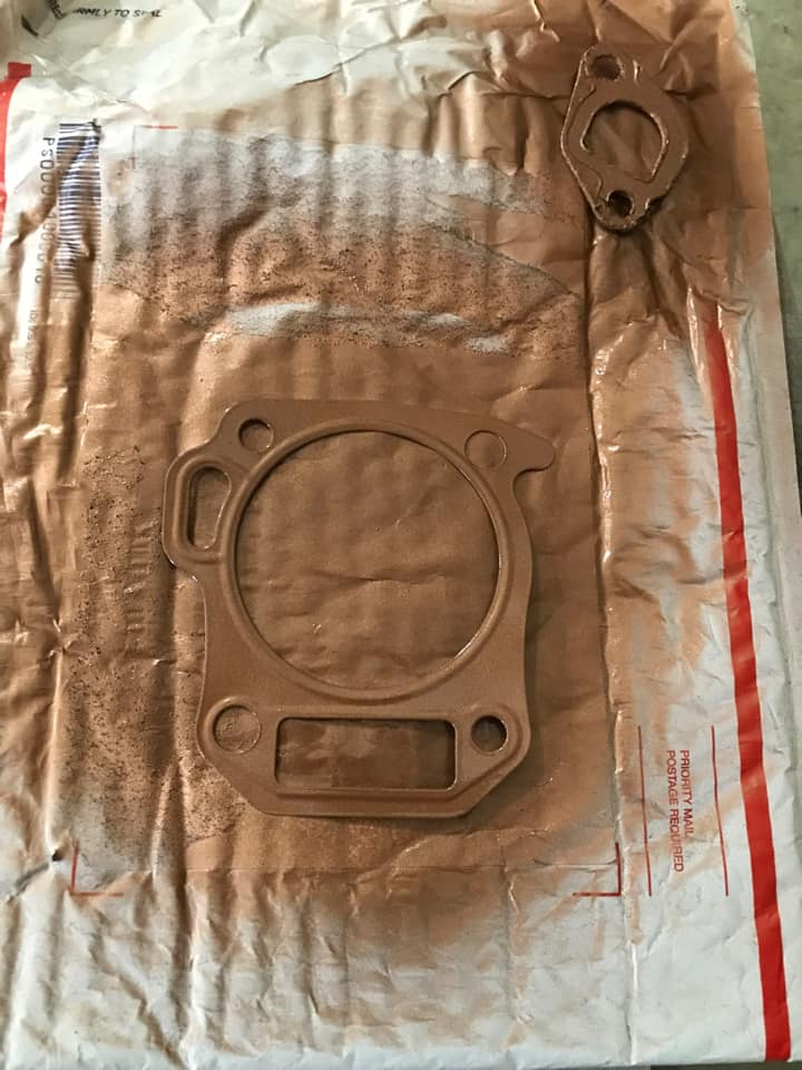

Instead of shaving the back mount on cnc mufflers to run on clone 2511. Like Scotty showed.
I decided to run 2 gaskets since no heat shield used on clones to make up that space.
PSS V2 on the Farmertec 2511.

Took out the slowest cuts of each of the clone cuts out and took the fastest cuts timed to compare.
IMHO Egan or a PSS V2 best for OEM or clones.
Stock clone pipe open muffler 13.41
PSS V2 10.70
Egan 11.16

@JeepHead was trying to wrap my ahead around why on clone PSS V2 was hair faster then Egan pipe. But not so close on OEM saw.
Thinking was closed port v/s open port and small air filter base and air filter v/s oem.
I totally forgot about smaller carb v/s larger oem carb. But Scotty reminded me of that.
So I check last 4 cuts. I found a little bit of the difference just now on last 4 cuts on clone. Egan pipe was 9" down and 8.25" wide at that point. The PSS V2 was 8.5" down and 8.25" on last 2 cuts.
