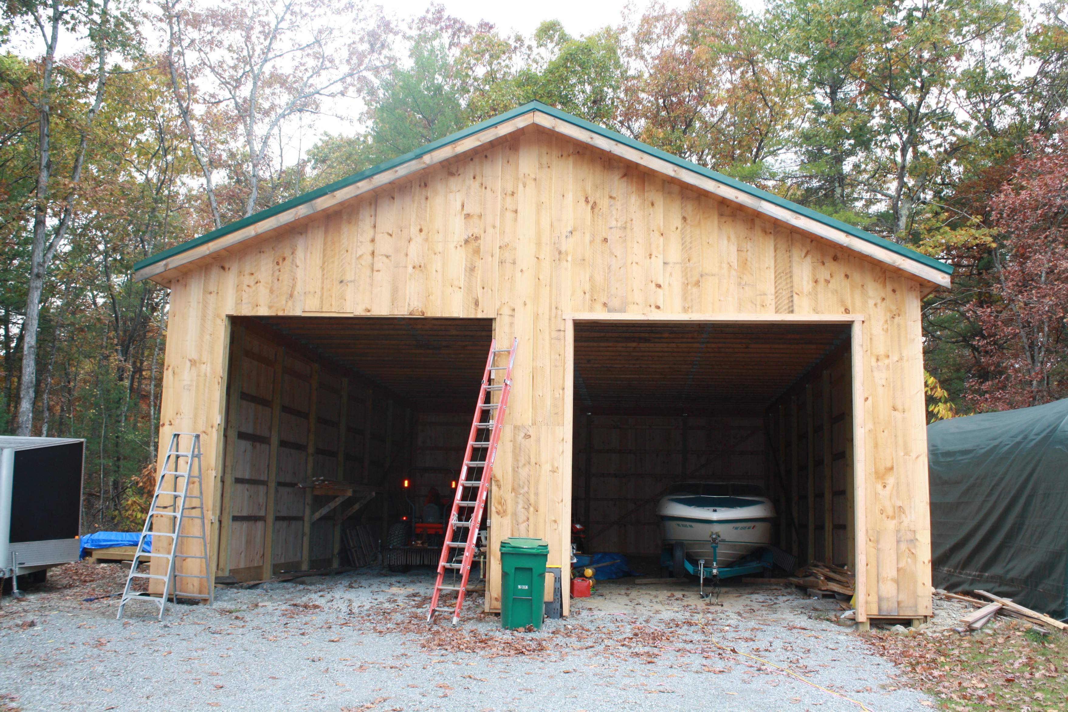

Sorry my bad on the first post it is only 60 x 38 so it is 60 feet deep and 38 on the ends with the doors. I have not installed the doors yet I have to wait till next spring. I have estimates for the doors at about $6000 including installation and the lift. This was a ten-year dream that I finally was able to do the starting last December by putting the post in the ground I would hate to add up every penny but I know it's a whole lot less than if I had hired someone to build it. Here are some cost for those who have asked
Footings 2x2 1 foot deep then buried 4' of the 20' post 22 posts. Building inspector required that I cabled the post to the cement pad before the cement dried. Cement 500 lumber 150. Lumber and coil nails for barn including plywood roof but not barn boards. 8000. Trusses 6500. Side barn boards 4500. Roofing and screws 4700
Insurance adjuster estimated replacement value as is at 76,000. So I figured I built it for well under half what it is valued at. I never did get an estimate to have it built I just wanted the satisfaction of doing it myself with my boys. This was great quality time and we all learned a lot. This barn will not only keep all of our stuff together it helps keep our family together as well the great and investment and I'm glad I did it. My boys are 2019 and 17 and then I have younger ones as well everyone pitched in.
Thank you guys for your interest I learned a lot on this server list. Mark

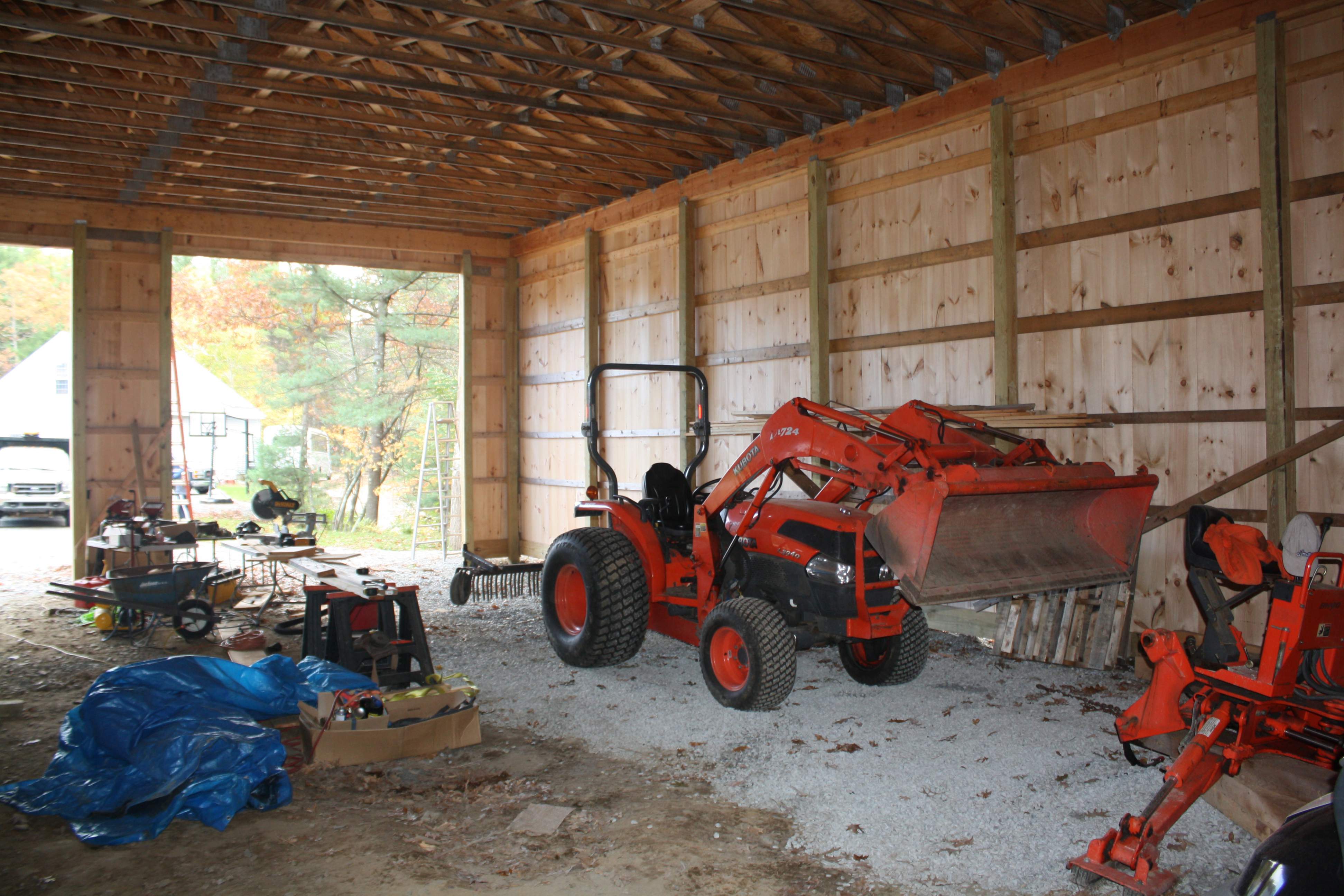

I finally have a place to park my prized toys.

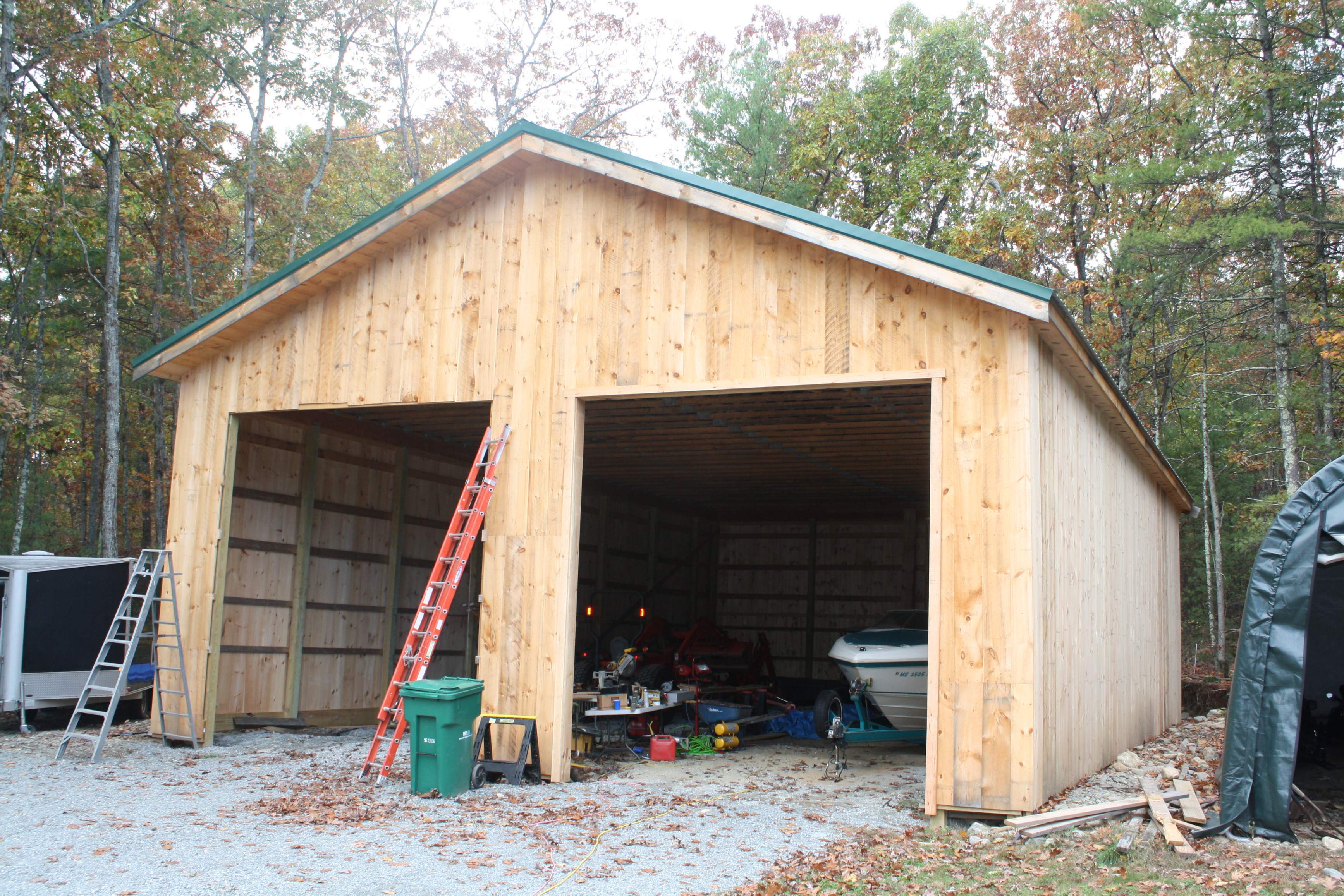

And room for my dreams
