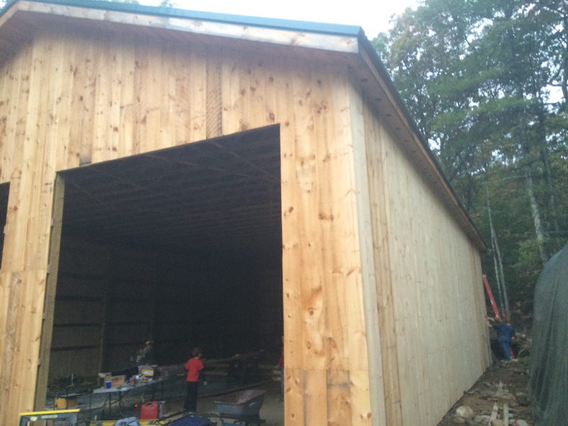

KUBOTA L3940HST BACKHOE
60x80 pole barn
/ Just about done barn #2
Nice build...
Need more photos when you finish...
Did you build it yourself or contract?
How was the county to deal with?
Was a permit required?
I had no issues with the town. The building inspector asked me to make sure I used a 2x2 cement footing and attach each post with a cable in case of extreme uplift. No other issues. It is 39x60 with 17 foot ceilings. I plan to put in 14x14 doors next spring. Cement floor coming in a few weeks. I will also add a 36" passenger walk thru door. Next year a car lift as well I hope! I did build it myself with the help of my teenagers and friends. Yes I did get a permit that cost about $500!:dance1::laughing:

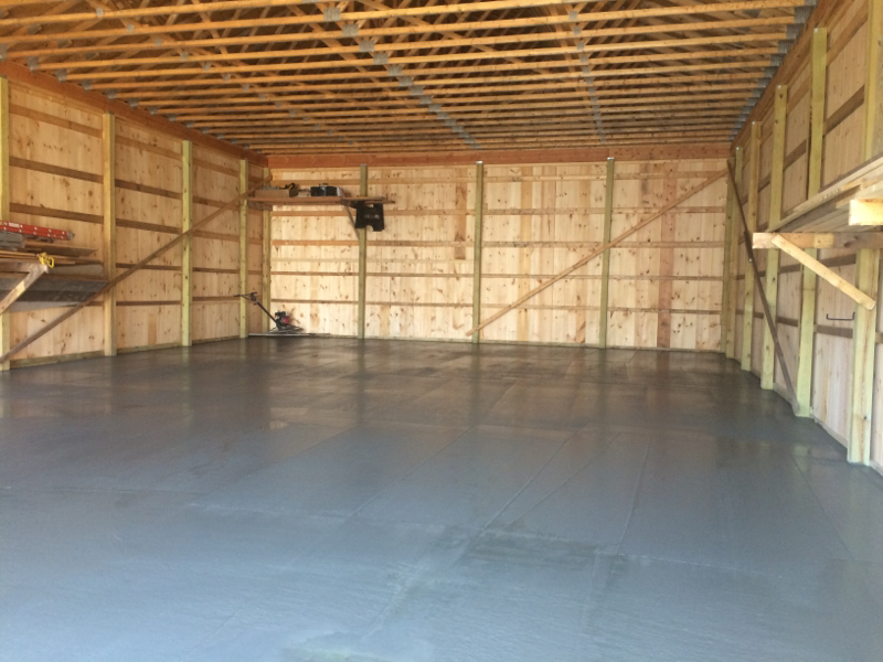

Just put floor in. 4" 4000 pat with steel.

I would have thought it would have required 58.6 yards of cement to pour that floor. What am I missing?
/ Just about done barn #14
You beat me-either its not 60 x 80 or if it is, and you used 37 cu yards of "concrete", your floor is 2.49" thick.
/ Just about done barn #16
Rollerball rink with teenagers. Paint some lines and make some pvc goal nets.
/ Just about done barn #17
It's 40 by sixty, not 80. The floor is 5+ inches thick on average.

Says is is 39 x 60
Okay-much better-and 5+ inches is better than 4-with those high doors and that length, I had visions of some pretty heavy trucks going in that barn
