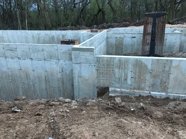

Was there a concrete truck that delivered a load of fresh that was well past it's prime?
No idea, I'm the homeowner and it's my understanding the general contractor is supposed to handle things like that. If not, what do I need him for, to know who the subcontractors are?

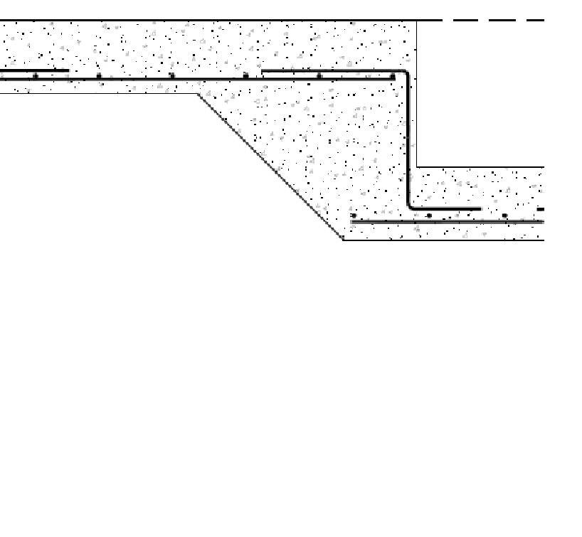

First off that footing would not pass in any of the jurisdictions I have worked in nor would it pass my inspection. They should have built a bulkhead at the step down but that takes a few hours. But having said that I've seen it done in residential construction without issue. Secondly the exposed aggregate you see is common and is called honeycombing. It should be filled and rubbed shortly after the forms have been stripped and the concrete is still green.
Lastly and more importantly the crack is a problem that "needs" to be addressed. Concrete does crack sometimes. Sometimes it is just part of the curing process, but often times it is due to the newly placed weight of the concrete on poorly compacted soil. Seeing the way they formed the footing I would have a structural engineer take a look at it and come up with a plan to fix it. Not a letter form an architect, or building inspector. A licensed engineer. If the crack is just due to curing it can be fixed by pinning the crack and injecting an epoxy in it. If it is due to poorly compacted soil it'll have to be ripped down. I've attached a picture of what your footing should look like.

Footings in most place i have worked around in southern USA are 18 inch deep to get below frost line and 12 inch wide at a minimum for a one story home on decent soil. Not saying thats the recommended size, saying its the minimum. Many areas have issues with soil types, ground movement and seismic activity that you are not even aware of unless you in a trade that deals with the issues. Then on top of the footing a stem wall is created of concrete or block that raises up to the height needed to get above grade for whichever flooring type is desired. The footing size in WIDTH is important to distribute the weight of the building onto good compacted base of soil and or gravel. The stem wall can add to the strength of the footing a lot as far as load caring but has little to do with preventing settling issues on loose base material. That crack you show would perhaps not be a big issue if it was a hairline crack. Every truck load of concrete comes with a set of free cracks is one old saying. But the crack you show seems to be more than a hairline crack, it actually looks like the concrete has already started separating apart. Why is the rebar not holding it tight together ? As rod sterling above mentions I also think its time you got a 3rd party not involved in the existing project and that is a certified engineer in this type of work to look at what you have. Not just the stem walls cracking but the footing size and the soil. You may have a major issue starting here that will just continue to transfer into your structure. type. It's better to spend some money now and get any issues solved or your concerns answered so that your not trying to figure out why you have floors, sheetrock, doors and windows, tile. etc with issues later. Hopefully all involved can handle the issue professionally and take care of any issues. Get everything in writing because your likely to have issues with this in the feature. This could easily turn into a major ordeal on getting it corrected to everyone's satisfaction.

Seems you have a somewhat major problem and it needs to be fixed before anything else is done. What did the building plans specify and how to be constructed with the concrete footings and walls ? Who signed off that this was a approved method ? Just looks like the concrete contractor did not want to take the necessary effort to construct the proper form for the 'jump' wall. Rod Sterling has the proper pic for the way it should have been done. I am thinking the void area in the 'jump' wall needs to be cut out and then rebar installed with epoxy to the joining walls with new footers also. Good luck

By the time they fill the garage with gravel and tamp it down and put sealer around the outside wall you will never notice it. It isn't going to cave in because it is all poured concrete. The only concern I have is if there is rebar spanning the opening.
If you got a big shot engineer involved nothing will change things except you will spend more money and still not get the answer you are looking for because it would take a ton of work to cut that whole section out and then you would have pieces poured in.
I am sure you got a fair deal with the contractor because a more professional contractor that used metal forms instead of plywood forms would probably have cost 1/3 more.
Nobody likes cracks but a garage footing would be where I would want one if I had a choice.

To think a 4' high wall 8" thick isn't going to hold up a building for a couple ft. span supported on both sides is nonsense. There may be cases where a continuous footing is necessary but I don't see this being one of them.

Would the garage floor with vehicle traffic on it count as a bearing point?
No, all that area over the void is going to hold (partially) is the slab & vehicle traffic. There will be a wood "header" spanning the o/h door opening and designed in consideration of the loads above, the load point is 1. at the corner bearing the gar. roof & any living space above it, and 2. at the edge of the wall step down that will bear the o/h door header's load.
Like Deere Dude said, the crack's one thing, but are there a couple of sticks of bar in there? It might be detectable with some type of device and a hired engineer will want crazy things done (that the wall contractor won't do) just to cover his rear. Nothing against engineer's but they'll spend some one else's money with no limit's to "stamp" it OK as insurance, and I'd do the same.
