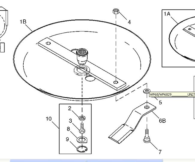

Can anyone help, I can't get my stumpjumper off for repairs. Is there a hex screw? special equipment needed?

Isn't there a hole in the deck to access the nut that holds the blades? That same bolt holds the stumpjumper on, I think. Unless they now include the stumpjumper as a one-piece item and it is not separate from the bar.

On the picture you attached, items # 8 and 9, I didn't see on my jumper. I did take the bolt/washer on the center of the jumper off and through the hole on the deck I hit the jumper planty but it didn't come loose. The only bolts I am able to see from the hole on the deck are those that attach the blades to the jumper. guess I need to go back and see if items 8,9 are there.

Better get the serial number. There is a break in the parts from MX10X14000 and up. Which side of that number do you have?
I didn't interpret what you stated
. Typo?

He's saying he put something through the access hole and tried to beat the stump jumper off
/ JOHN DEERE MX10 stupjumper #11
Sometimes the "blade arm" (that is what JD calls the stump jumper-rotor combination) can be attached to the spindle in a pretty stubborn way. If you removed the spindle (center) bolt it should come off, but may well need a bit of persuasion. From the blade access hole in the top of the deck, use a pretty heavy pipe and bang on the ends of the blade arm. I would remove the blades first.
Rotate the blade arm after a few wacks on each end........it should eventually come off. It is snugged up on a spline, once it loosens a tad it will drop off.
BTW the twin spindles on a MX10 counter rotate so you cannot swap the stumpjumpers with out also swapping the blades, as the blades are rotation specific.
