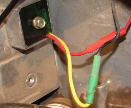

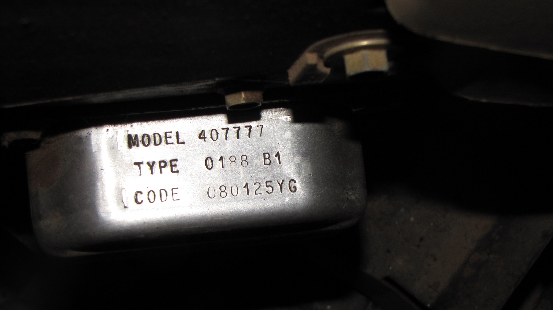

My Lawn tractor needs a rectifier. Is there a Briggs parts man here that can tell me which rectifier number and possibly charge voltage for my Briggs? After market will be fine being they are all made in the same place and seem to last only a couple of years.:D

part number 794360 for the 5/9 charging system. charge voltage should be 13.2-13.5 at the battery for the most part, but could be higher up to about 14

I also answered this on LawnWorld, but will answer here also.
What they are talking about is a different charging system then what is displayed in the picture. The above statement refers to a 3/5 unregulated charging system. The 3/5 system had two wires coming off of the stator under the flywheel, instead of one like in the picture above. Which means you have 3 amp DC half wave rectified by using a diode in one wire of the stator wiring harness, this is a unregulated system, meaning no voltage regulator. The other wire coming off of the stator is 5 amp AC and is used for lighting only.
