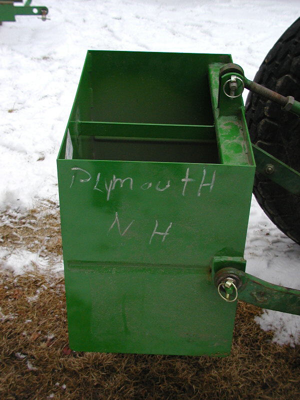

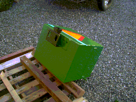

Thanks Mark, the problem I am having is with connecting the top link. I may have to lower my bottom pins. My box is 17" tall. The distance from the top pin to the bottom pins is 8". If I go the 15 1/4" like yours that would leave my bottom pins 3 1/2 inches off the ground. Now, I'm thinking that may be too close to the ground & I don't know if my three point will go that low. I still think that lowering my bottom pins will improve things.
