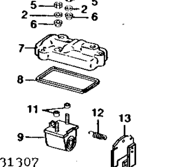

If you're 100% positive that the check valve fitting(parts key 5) isn't plugged then yes inj pump repair is required. As one last attempt to get engine to run before removing IP loosen screws on timing window(parts key 9) and attempt to start engine. Be sure gasket isn't stuck to pump housing. Yes you'll loose a little diesel but IF engine runs a small amount of lost diesel will be nothing compared to $$$$ of pump repair bill.

how do i tell if the check valve is unplugged? I took it off and it does have a lot of stuff in it so i blew it out with compressed air but how do check that it did the trick?

Some tractor owners/technician have removed glass ball & spring. If you loosen timing cover & gasket and engine runs then you'll know check valve MUST BE PLUGGED. Plugging of check valve indicates fiber drive ring is deteriorated in IP and needs to be replaced to avoid costly inj pump failure or worse scenario connecting rod protruding through side of engine block.

I tried the pulling the timing cover and the tractor did run so i cleaned the check valve again and the tractor is now running for at least 15 mins. So do i still need to have the pump rebuilt because it was some type of material that the valve was plugged with possibly the fiber drive pieces maybe?

Yes it was a piece of material stuck in the check valve on the top of the fuel pump ended up having to eliminate the check valve because i couldnt find a new one so it doesnt start as easy as it ounce did but at least it will run now

820 IP check valve is JD part # R36535 CONNECTOR,WITH CHECK VALVE ADD 29.72 US. Or you could probably get it from IP parts supplier.
