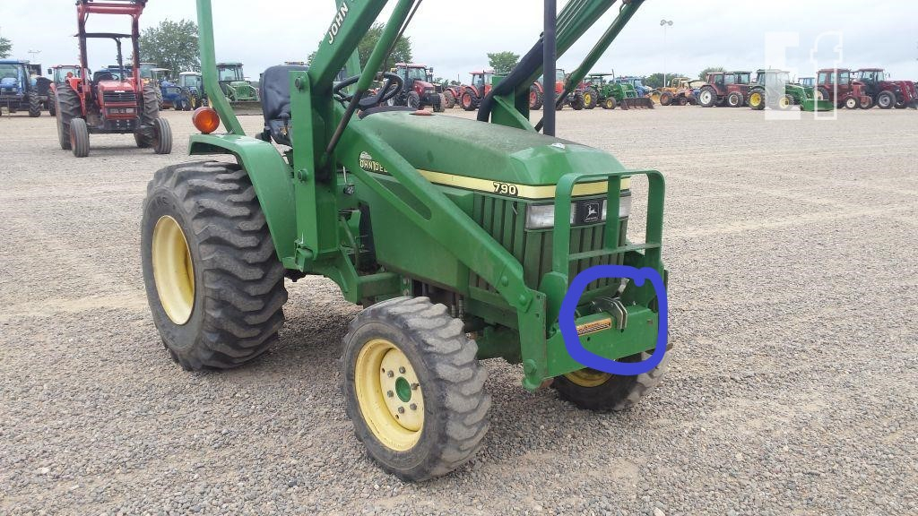

I have always wondered what the gold? piece is on my tractor.. can someone explain what the purpose is? sorry if this is a silly question but I gotta know.

Surely looks like part of the locking mechanism for the loader frame. When removing that loader that front crossbar comes with it and act as the stand.

Pretty sure it clamps to the weight bracket
/ John Deere 790 - What is this #5
JD had some early results of people ramming into objects (i.e stumps, rocks, abutments, etc. ) and bending that closing plate in the front, to the point that the plate was not holding the FEL tight enough that bumpy travel was allowing the FEL to come off. So the safety device (Clamp shown) was issued to all early customers (I was one) and then became standard part with the new FEL's.
I don't use it, but do put a 3/4" bolt through the front plate and the front weight bar. That keeps the plate from coming unlatched.. plus I don't ram into things to bend up that front plate.

I remove mine when not needed, but always when winter comes and the snow plow goes on. But this quick tach FEL is easy to switch back and forth. The safety latch/bracket in question is not needed if the parts in front are not bent up and remain straight. But apparently there were a few instances early on where the FEL came off and caused some concern, but was a result of abusive use of the tractor. The type that can wreck/destroy an anvil.

Only keeps you from opening/releasing the latch on the front weight bar, which is needed to lower the frame and remove the FEL. Have to remove it first before removing the FEL.

I had one of those tractors back in the early 2000s. Several months after buying the tractor I received that part in a shipment with a letter from JD with installation instructions. Apparently under some circumstances, the quick attach loaders of that era actually quick attached when in use. That bracket is added insurance against the loader detaching inadvertently.

I understand what it does now.. thanks everyone.
